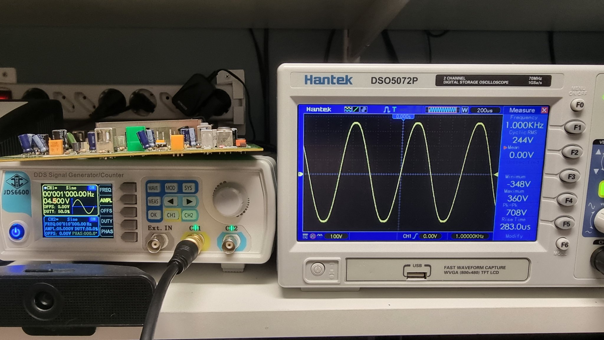

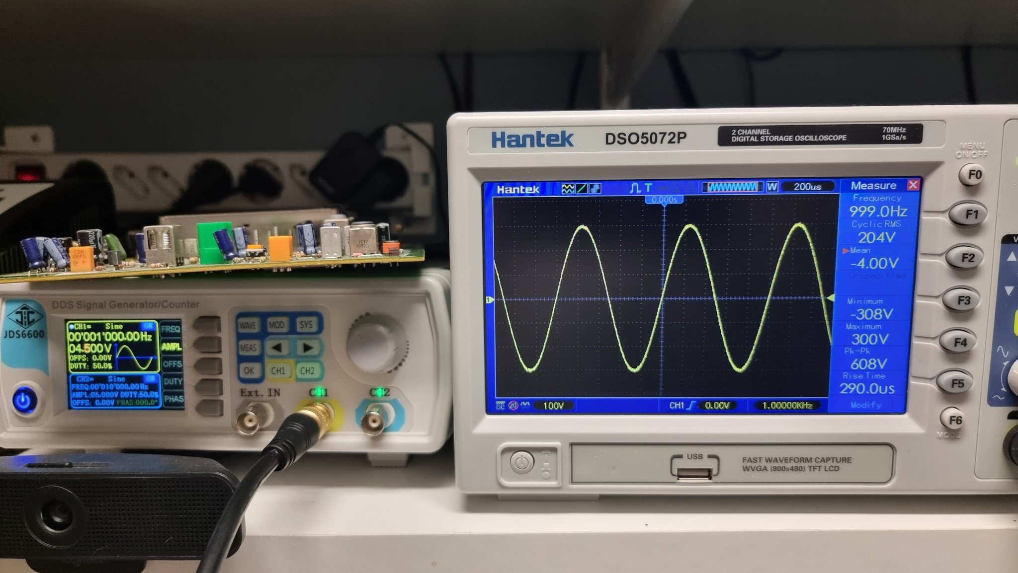

The power output offset is a bit all over the place. Especially on the left channel. From cold it often starts at 200mV and then starts dropping as the amp get warm (i guess) the pot is super sensitive. Im trying ti set it to as close as possible to 25mV Is there anything I can do to fix this?
The current adjustment is to be set to 4.4mV per channel according to the manual. Is this right as the right ch is set to 4.4 but the left is at -4.4mV (I can not set it to a positive value)
Finally I tested the max output of each channel and noticed that the left ch is a bit off. I am feeding a sine wave to "main in" to bypass the preamp. I can bump it to 4.5v before I see deformation on the right channel. Then if i fed the same signal to the left channel I get different readings.
Could this be due to the fact that I had to replace the power transistors on the left channel with new ones from digikey that werent as closely matched as the original ones on the right channel? (2SA1386/2SC35129) Or could this be due to something else that that you can think of?
OR is the current adjustment and the max power output problem related come to think of it? 😊 😊
Sorry for all the open questions. I would be so thankful for any input
Is the left channel offset more "twitchy" than the right? There should be no DC voltage across R119 since C109//C111 should block DC current flow. If either of these caps were shorted/leaky, offset adjustment pot would be very touchy.
When you measure/adjust the bias current, you're monitoring the voltage across R143 (R144). If you ensure the voltmeter positive probe is consistently on the supply rail, you'll get positive voltages. These currents cannot go negative.
I note the the scope shows the left channel is driven more heavily into clipping than the right. I suspect the gain of the left channel is a bit higher than the right. Try reducing drive about 25% so that both channels show clean sine waves and compare voltage gains. I think you'll find left channel gain is serveral percent higher. The gain of the left amp stage is (1+R121/R119). Resistor tolerances between channels are the likely explanation. If you test each channel's clipping behavior (ignoring the difference in applied generator drive), you'll probably see very similar results.

All the above turned out to be Q101! I measured the right cannel and voltages was as the schematic but something was off with all values around Q101 in the left channel. It tested OK but I replaced it with a KSC1845. Suddenly the offset and current was stable and could be adjusted to desired levels and the amplified curves in the pictures above were the same. and the sound sounds the way it's suppose to. What a learning experience 😀
