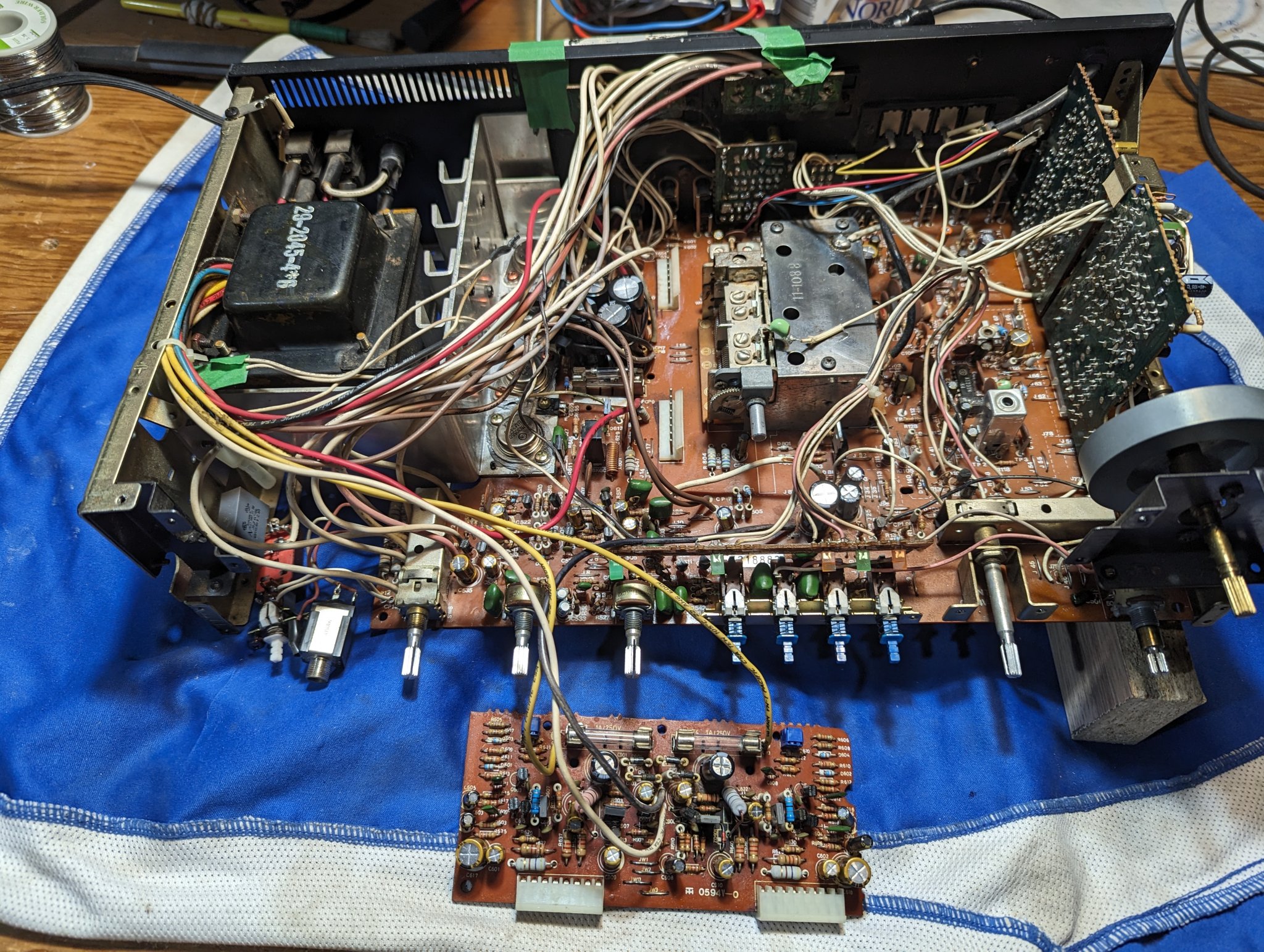

Hi members,decided to reach-out as I am "hitting a wall" with the repair of a NAD 7020 amplifier section.
This is the second version with the separate boards via connector.
Here is a summary:
Disclaimer: someone was previously messing around with this unit, so I got it non functional:
  • Entire unit has been recapped.
  • Tuner section and preamplifier are now working fine.
  • Voltages on power supply are within specs.
  • Amplifier driving stage not sure if working properly.
  • Previously the output stage transistors were all shorted, they have been replaced with 2N3055G & MJ2955G (epitaxial).
  • The BD139 have been replaced with 2SC2690A.
Now the bad part: I powered-up slowly using a variac to attempt to set the BIAS and DC Offset. Both are showing unrealistic figures as you turn the voltage up slowly. Note: I am aware of the differences between original Hometaxial devices and modern epitaxial, for that reason I have cut the emitter traces and added emitter resistors (0.33 ohm 3 watt), then cut the collector trace and added 1 ohm resistor. I have disconnected the phono board, the MPX, the soft-clipping circuit to try isolate the problem, but nothing changed. I have now decided to connect with you solid state experts, thanks

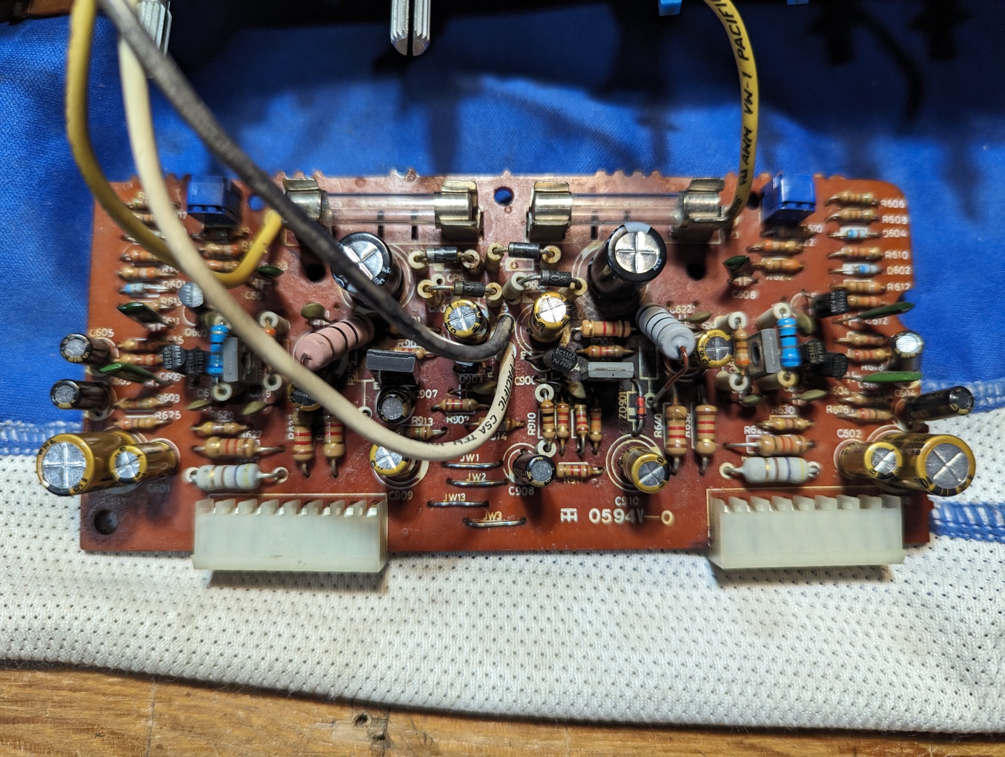

When you say "The BD139 have been replaced with 2SC2690A" - I assume you are talking about both BD139s (both the one in the VAS (Q607/Q608) and Vbe multiplier(Q609/Q610)?
At the stage where you are I would:
- verify the BIAS and DC offset behaves the same way in left and right channels
-> in the hope only one channel behaves badly in which case you have a "bad" and a "good" to compare
If both channels are behaving badly:
- Using the variac: try to establish whether the Vbe-multiplier seems to be working (including measuring R655, R641, R643 and Rx 1) - Vbe on the BD139 should get to around 0.6V and stay there.
BTW: at what supply voltage do you see the urealistic BIAS and offset?
And when you say "unrealistic" - what does that mean?
Cheers, Martin

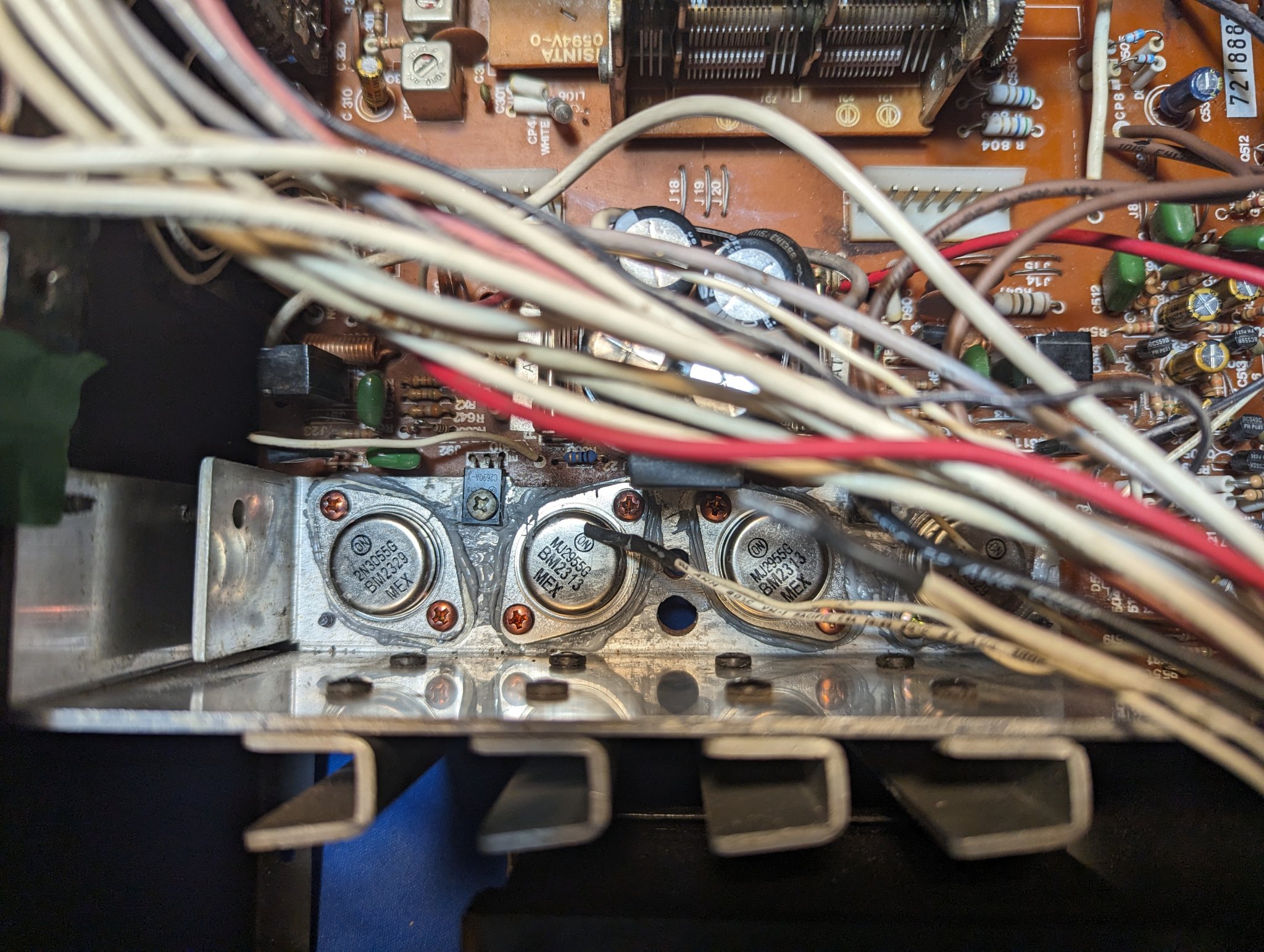

Those don't appear to be original screws on the output transistors. Did you remember to insert the screw insulator (that fits into the mica screw hole?)
Check continuity between each transistor case and heatsink.

I would really recommend checking post #8

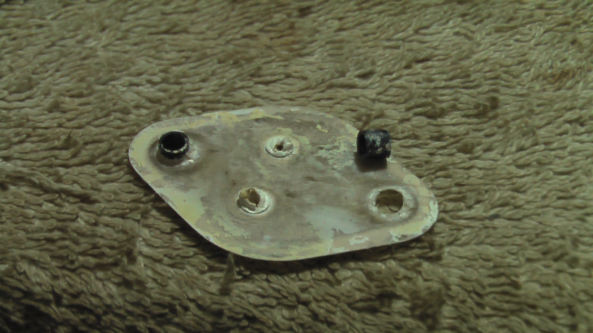

Removed all 8 screws with nuts (I did not have any insulators or fiber washers to start with) now the collectors of the output transistors are left "hanging". Measuring voltage on 1 ohm collector resistance without any difference. Measuring resistance between ground (heat sink) and collector of:
2N3055 both open loop.
MJ2955 8.5 Mohm
In reference to post #8: I had a similar problem with a Yamaha M-45 where the thermal pads (the ones without thermal grease) were conductive and basically a resistance between collector and ground. Is it possible that the grey silicone grease is causing a problem ? I checked for conductivity and it is ok, may be possible capacitive.
MJ2955 8.5 Mohm
Mica insulators must be present. Transistor case is live(=collector so at rails voltage)
Needed to measure the case to heatsink resistance with screws in place, the screws MAY be providing the low resistance path to GND
Some formulations of thermal paste contain low levels of silver so they can be conductive however this does not appear to be the case since,
MJ2955 8.5 Mohm

Back at it after a client repair I needed to complete.
Removed all output transistors, re-tested again with Atlas DCA55 (no problem).
Checking voltages going backwards from output transistors, the voltage between ground and collector of Q612 or Q614 (RH channel) is 50% of the opposite pair. Removed C625,6,7&8 tested out of circuit (within specs). Applied the same voltage with the capacitors removed, no difference.......the hunt for the short continues.
I think my first steps with this would be to apply a short across the vbe multiplier to force zero bias and then power up using a bulb tester on full mains and see where it is at voltage wise.
This looks to be very similar to a basic 3020 type output stage and these are not great for DC stability being single ended at the front end. If the supplies are altered (variac etc) the DC offset can be pretty large.
