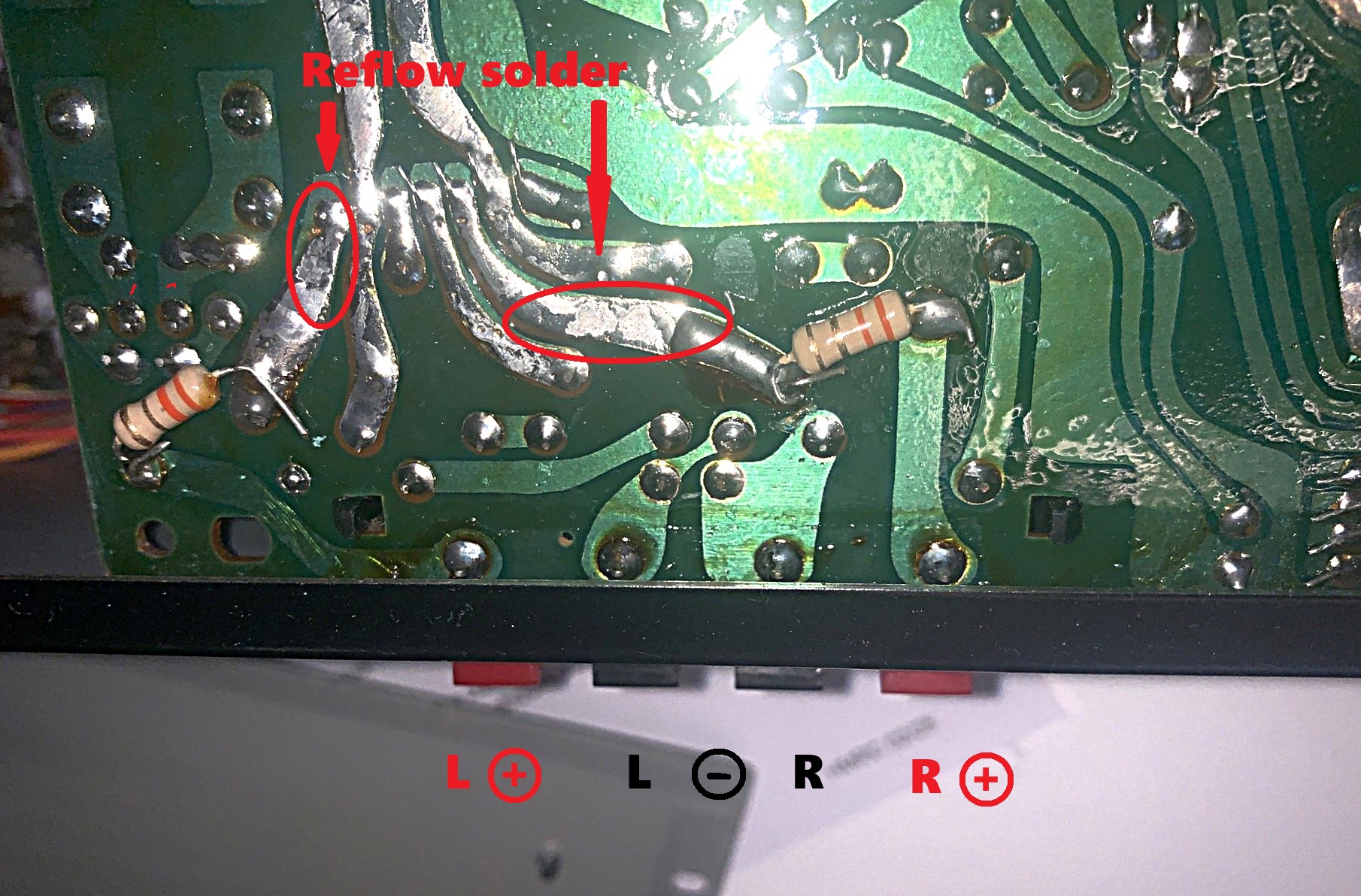

If you can find the amplifier output inductors elsewhere in the amp, for each channel connect its output directly to the red speaker terminal with a reasonable wire, say #20.
Are these 4 behind the terminals what you mean? Otherwise I'm not sure how to find these inductors.
