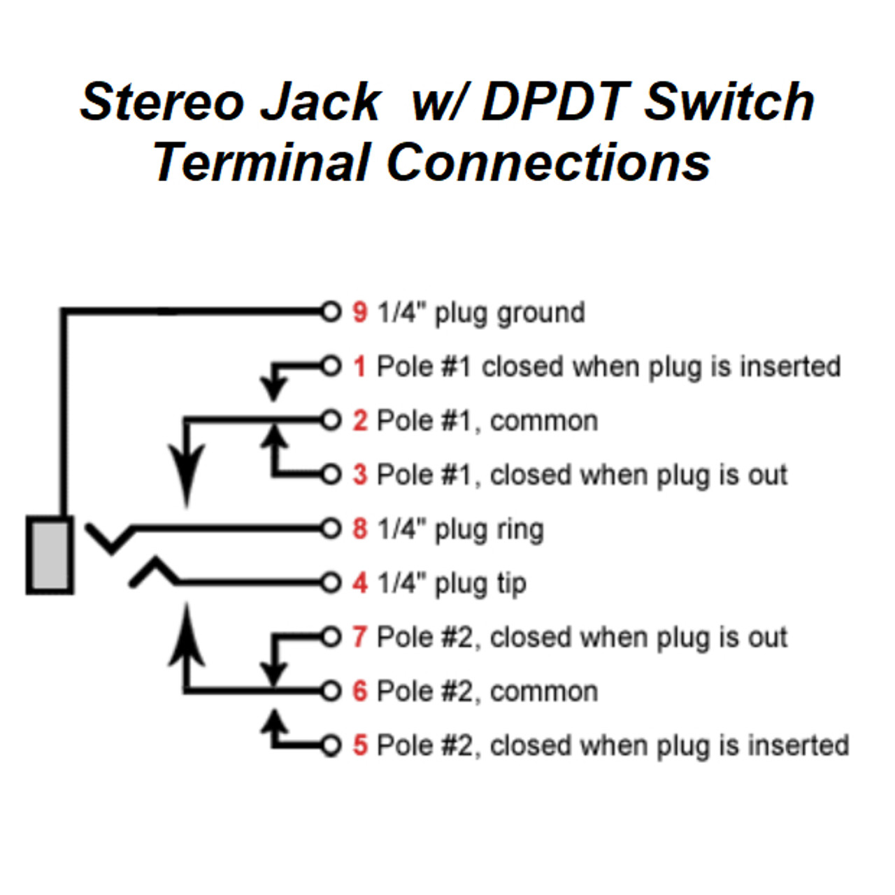

Try shooting some cleaner in there, deOxit or alcohol. Nothing that would gunk it up, though.
The switches are inside, and are an integral part of, the headphone jack. This is a common arrangement.
You cannot open the jack up, it's sealed. Either shoot in some cleaner, or replace it if possible.

Ah I see, so literally shoot it into where the headphone cable goes?
Yup, that's the only way into there. Give it a 1 second spray, and then plug in the phones a few times. Then test the speakers.
Repeat if necessary, the cleaner has to migrate around into the switch contacts and may take a few tries to work.

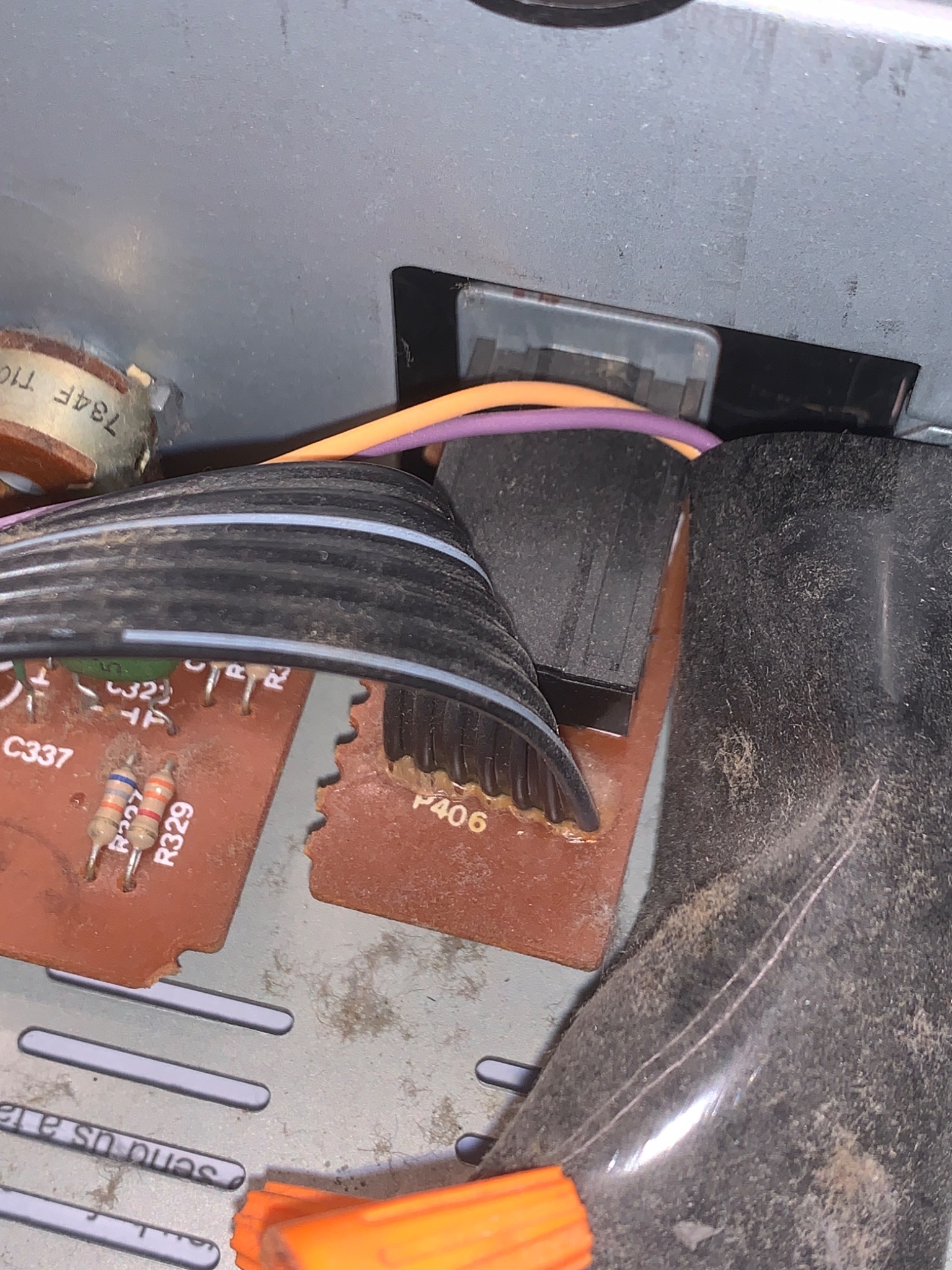

Nope. I did try powering the speaker by touching the wire to the point of the bad terminal on the PCB though, but there was still distortion.

But the headphone connections are all soldered, so that's not from dirt.

I've now sprayed the jack several times, each time inserting the headphone jack several times. No improvement yet, how much can I spray this without harming it?
