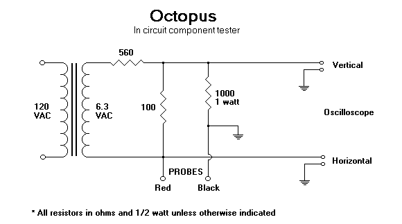

I’ve never bothered with a lamp, either a current limited two rail DC PSU , or a variac and monitoring bias all the way up from 20VAC
That and a ‘scope component tester prior to bringing it up on the variac usually finds most of the problems , hand built for a decade or so, but nowadays I use the built in one on my R&S HMO1202
Build one if you have a ‘scope , they’re invaluable
