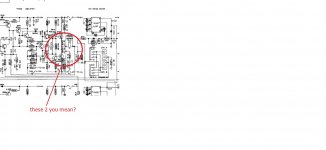

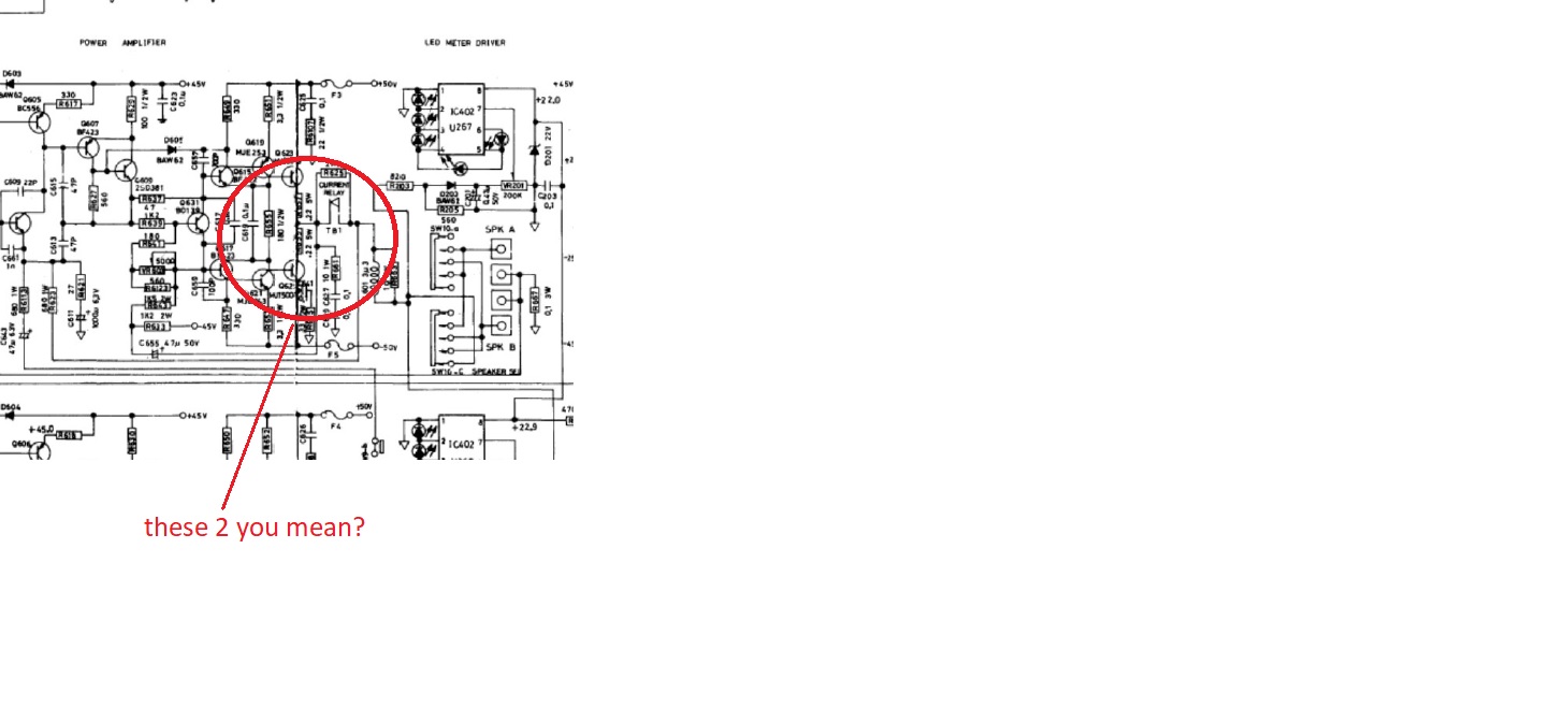

I would first check what voltage was across the 0.22 ohm resistors in the output stage, just for curiosity and just to see if that was where current was flowing. All fuses fitted for that.
Depending on that result I would then pull the four fuses related to the power amps and then see if the low voltage low current supplies come up to something like the correct voltage.
Yes. If current is flowing there it will show.

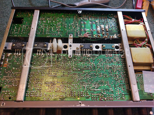

nice easy access but a bit precarious in places
I've seen worse, it actually looks very accessible for service. Looks like mix and match on the outputs 😀

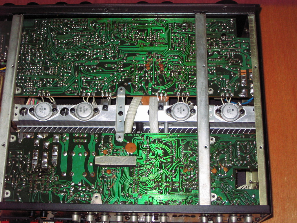

Those Sanken? outputs are not original. I have a 3140 on the bench at present and the original outputs were MJ15003/MJ15004- both TO-3 cases.
- NAD 3140
