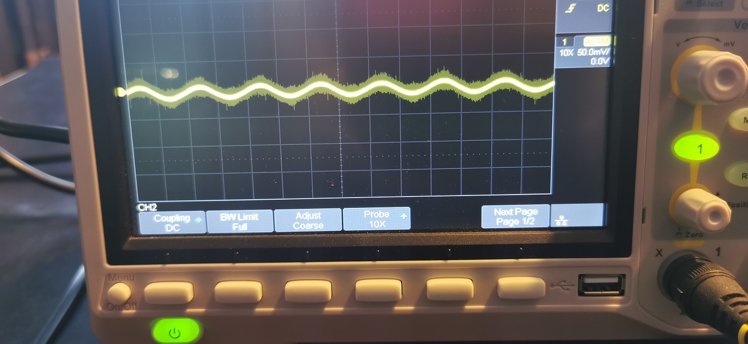

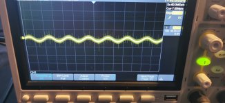

This buzz is audible of course. We need to see a scope shot of that noise and that means using a slow timebase speed which you might have to set manually. We need to see what we are chasing here.
Get it making the noise and put the scope across the output. Set the timebase to 10 milliseconds/div initially and see what shows up. A low level buzz could be only a few tens of millivolts in amplitude. So set the scope manually to look for something like that rather than letting it auto range on something that might not be an issue.

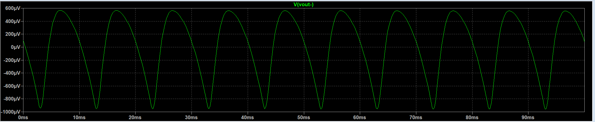

This is from a simulation but shows what a typical annoying buzz might look like. Frequency is 100Hz (mains related) and amplitude low. Use that as a starting point.

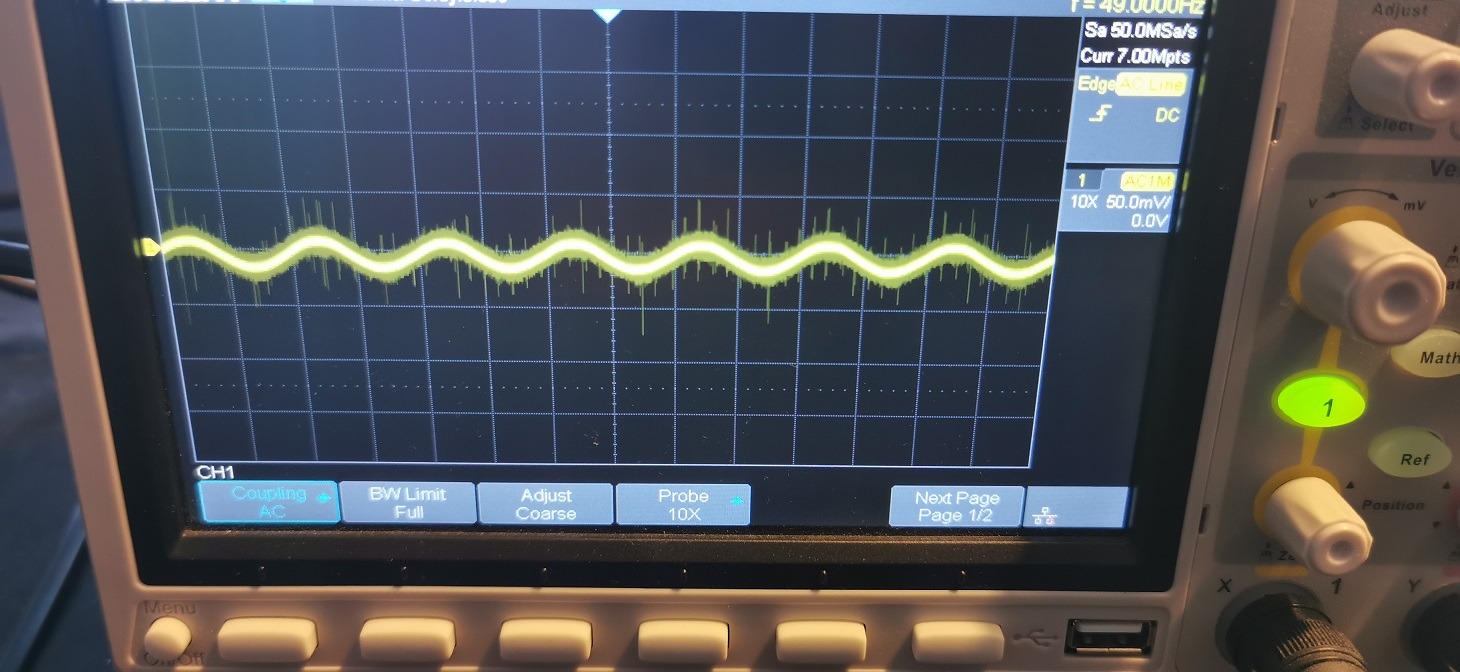

That looks like oscillation sat on top of mains related ripple. The slow timebase shows the low fundamental but all the fine 'grass' riding along with it looks like high frequency noise. If you wind the timebase out (faster) you lose the fundamental and begin to see just the high frequency stuff.
The low frequency ripple is getting into the amp somewhere. I would next measure the supplies with the scope (same timebase setting and with AC coupling and look at the amplitude of the ripple on the rails. All the rails related to the power amp.
The high frequency noise would have to be looked at separately I think. If you have another similar non modified amp it might be worth comparing against using the scope.

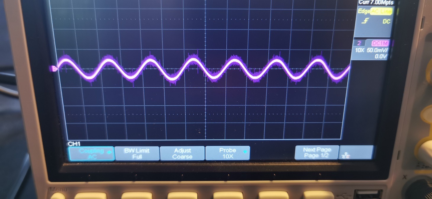

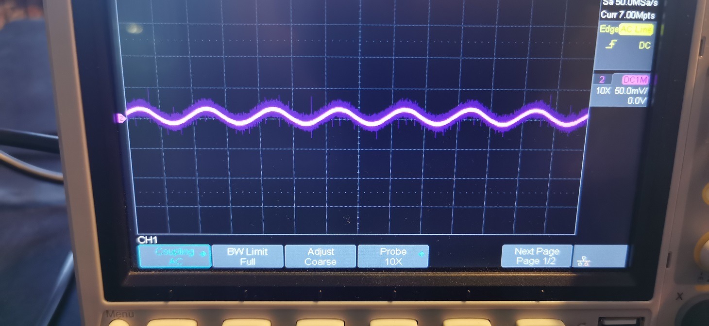

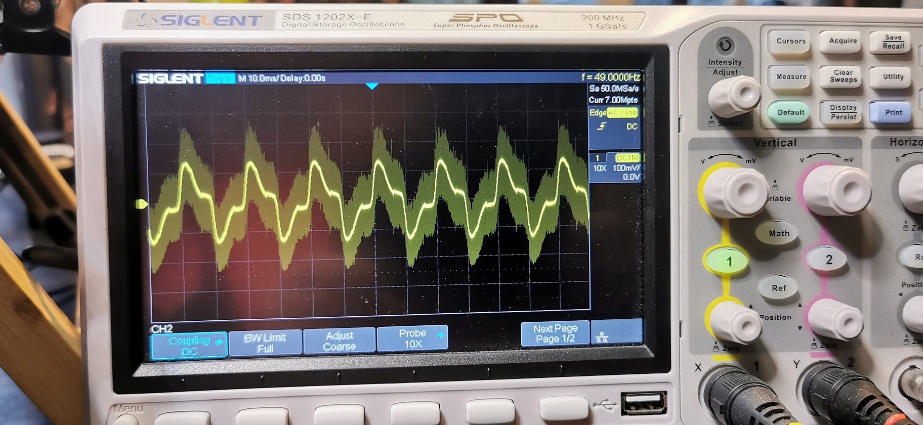

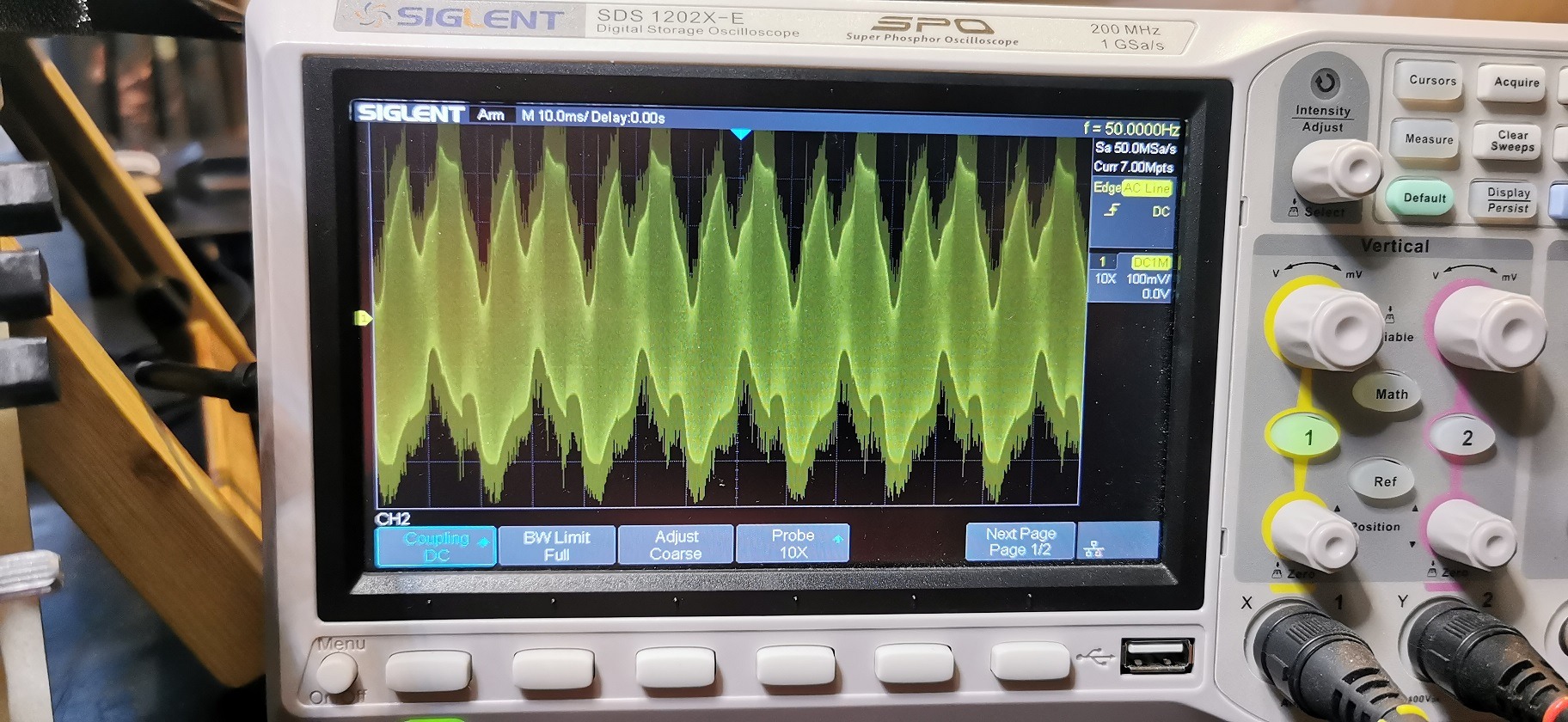

I do have another of these and when i get it out ill fit some pre sets to it, but for now the attached comparison is at a fixed 27mv across the 1ohm
1st pic is standard left channel
2nd pic is standard right
3rd pic is modified left
4th pic is modified right
All at the same current settings
as you will see there isnt alot of difference,unless you see things differently to me.
maybe it just is what it is and going to high with the current will amplify what is already there

Very interesting. thanks.
I would agree they look similar so maybe it is 'just how they are'.
One easy thing to try with either amp. Use the same test setup but this time clip the probe ground to the probe tip... and you should get a clean straight trace of course. Now touch the still joined tip and ground lead to the same ground point you used in the measurements. The trace should still be a totally clean and straight.
If its not then artefacts of the test set up and grounding are coming into play,

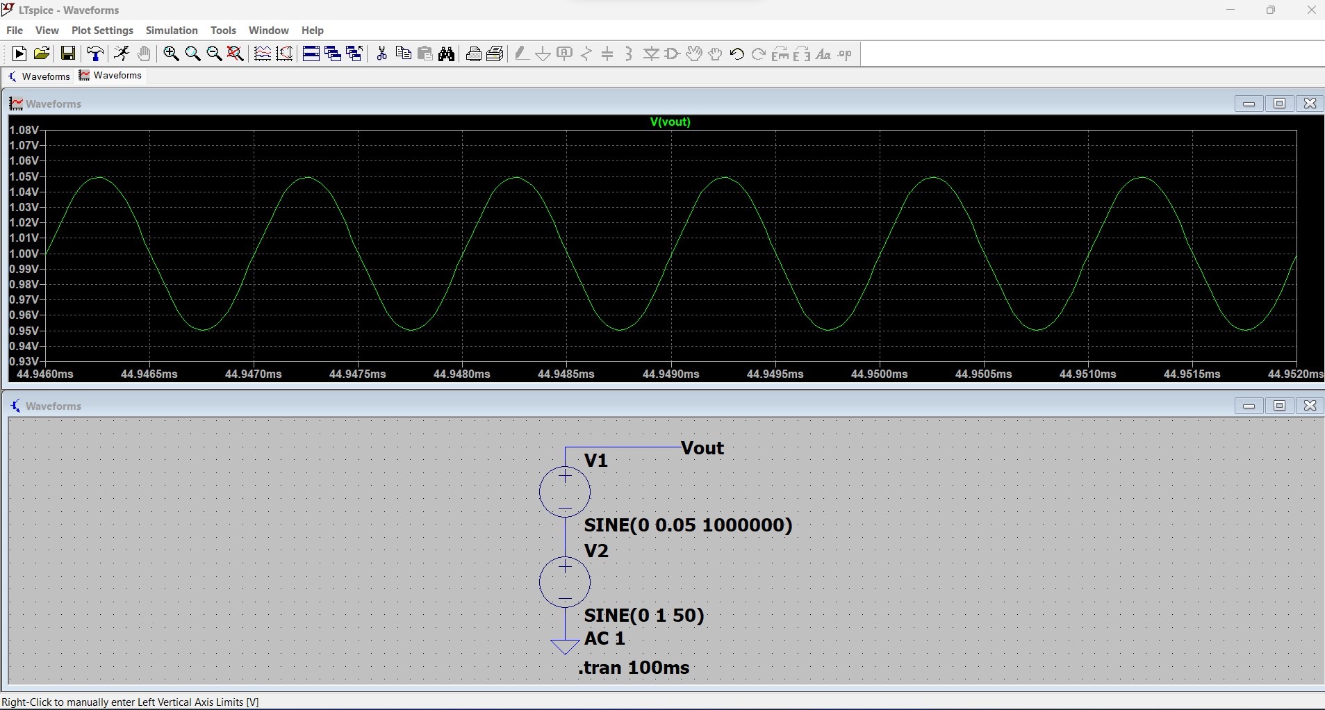

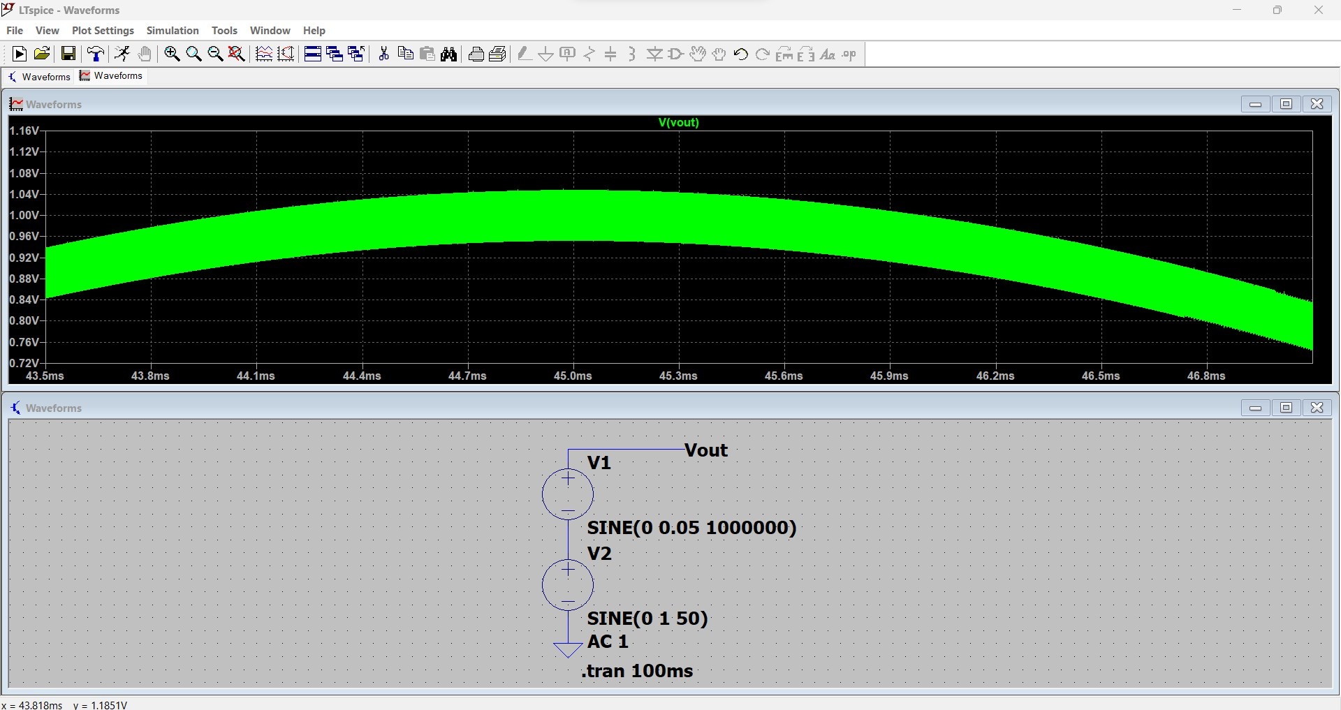

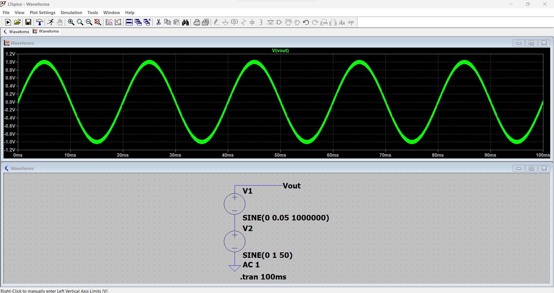

This might help you understand how the scope looks with a low and a high frequency signal together.
Run the sim and you will see a 50 Hz 1 volt sine and a 1Mhz 50 millivolt sine superimposed on it. Look at the units at the bottom (timebase speed). F=1/T remember and so we can look and see that 1 cycle takes 20ms. 1/0.020 =50Hz
Now place the cursor over just above any part of the green trace and then holding the left click button down draw a tiny rectangle over that part of the trace. The trace will expand. Keep doing that again and again and it zooms in on on that area. Look at the units at the bottom.
You now have no clue about the 50Hz, all you see is the high frequency part.
Pick any two parts of the waveform where it repeats and work out the time for 1 cycle. In the last image I see 44.9470ms and 44.9480 as convenient points to read off values. 44.9480ms-44.9470ms = 1us (1 microsecond)
F=1/T which is 1/1E-6 which is 1000000Hz or 1Mhz.
