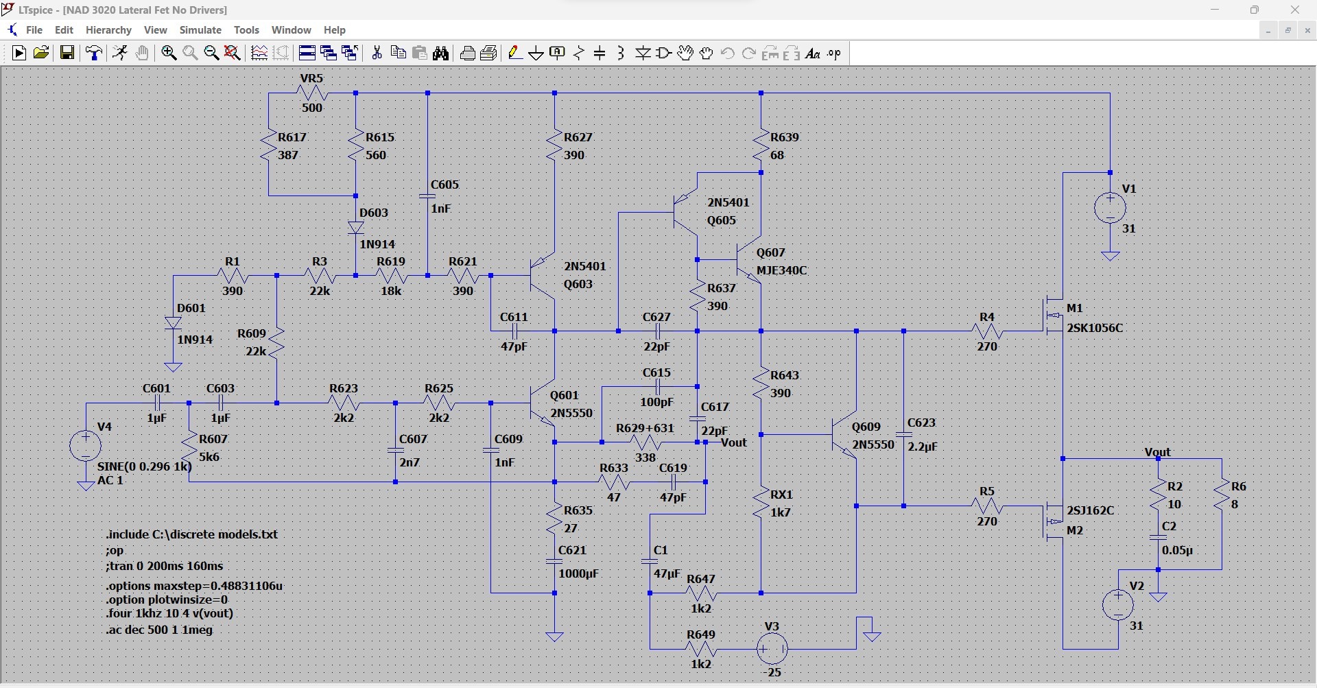

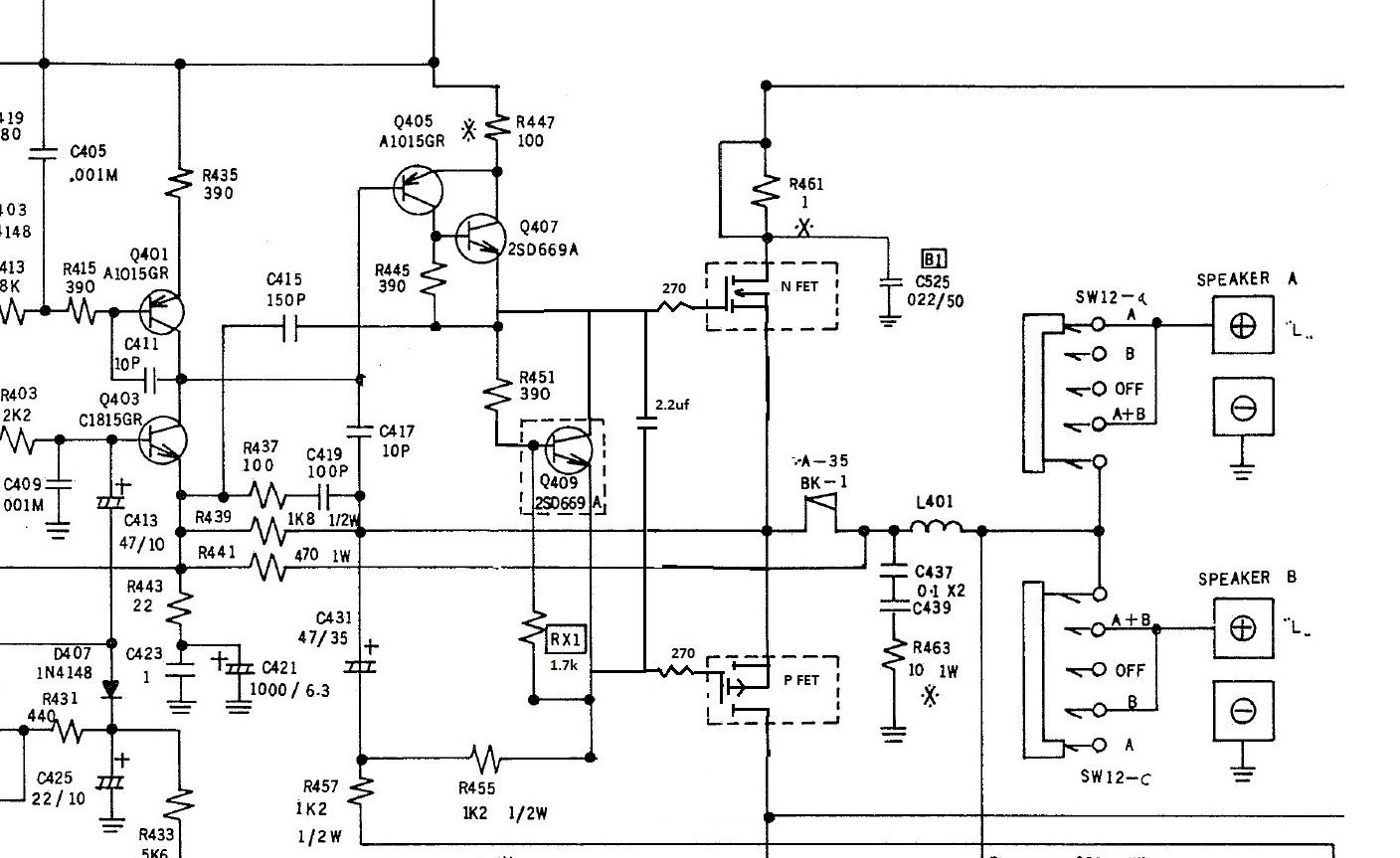

so no difference with those removedThe output inductor is there to isolate the output stage from any unintended capacitive loading (such as the self capacitance of some speaker cables) which can cause oscillation and instability.

Try removing those caps I circled to see if the soft clip is feeding anything rail related into the amp. Keep using the bulb for safety though.
