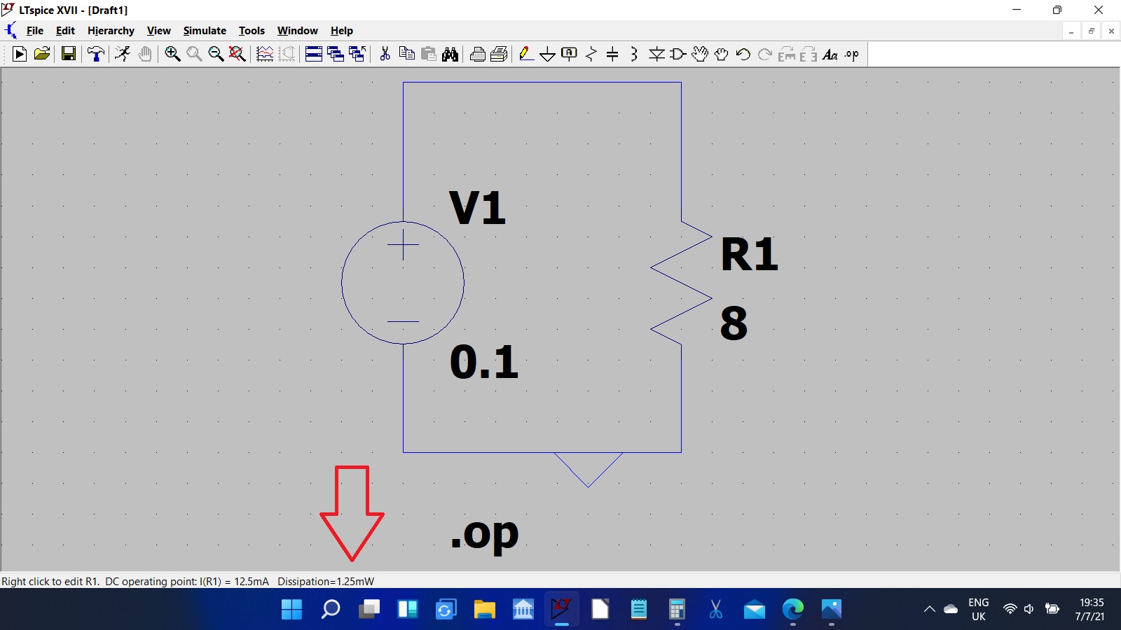

At the end of the day if there is no fault then it is easy to tweak the circuit to give the correct offset with the preset centred. 50 millivolts historically would be considered pretty decent. We used to reckon on -/+ 100 millivolts as being acceptable. If you work the power dissipation that 100 millivolts causes in an 8 ohm load you will see it is a non issue... I'll let you work that one out 😉
You might be chasing a non existent problem with a circuit like that. I suspect the DC offset will shift with supply voltage and so if the mains is high or low then the offset may change and/or be more one ended on the preset.
Watts would be voltage squared divided by resistance so (0.1*0.1)/8 would be 0.00125 watt or 1.25 milliwatt.
