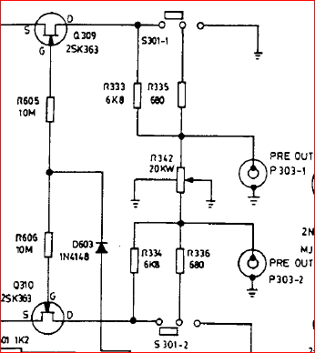

The mute function in 3020 models is not via the usual speaker relay at the output of the amplifiers
The Mute button (different from what you are talking about) drops levels by 20 dB.

You're right there, Dave - I missed checking the legend of the switch with the -20dB muting function. I imagine what I wrote will confuse anyone with the amplifier in front of them so, my apologies folks.
Personally, I'm more familiar with mute meaning to "kill" the sound rather than attenuate it but I guess consumers will interpret it to mean "muted" as in quieter and manufacturers will want to follow what works best for their customers.
The snip shows the part of the schematic at the preamp outputs - both channels, both JFETs and the dual muting switch and balance trim control which follow. I used the 3020i schematic for clarity, as schematics of the 3020 model on the web are showing their age.
Thank you.
