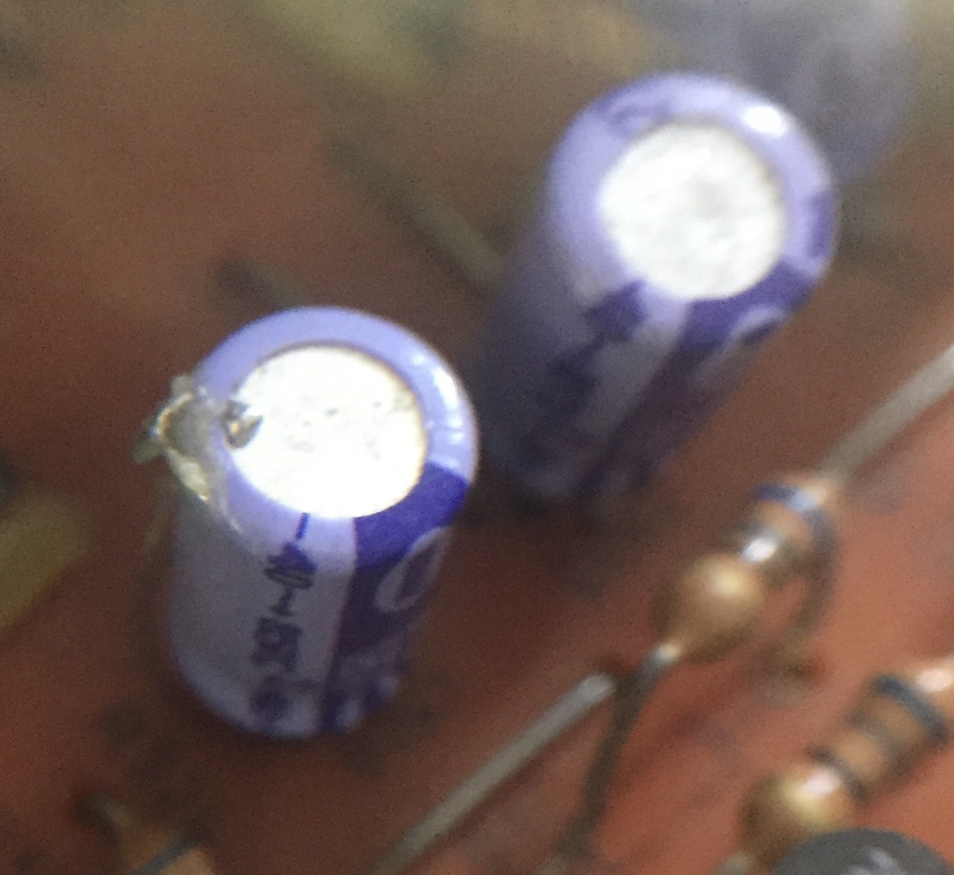

re: 21 (luckythedog #5), yes, if I remove the links between "Pre-Amp out" and "Normal In" I get the normal slight power-on sound (what I'd describe as a gentle "whuuum", even with volume turned right down), if I put them back I get the loud pop.
I got the service manual from https:{slash}{slash}www.eserviceinfo.com{slash}downloadsm{slash}248559{slash}NAD_3020.html - little nervous getting stuff from "free" download sites and then passing it on to other people - if you want to get it from there the Russian bit on the linked page appears to translate as "numbers".
The caps all "look" okay (I wouldn't expect to see much different if any had failed in a less than spectacular way), apart from C518 (on the pre-amp) that has what looks like a drop of solder and maybe a bit of "fluff".

Pop only on right channel (see message #12 above). C518 is on the right channel.
