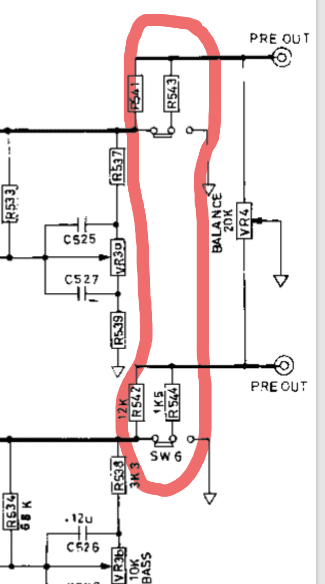

re: 21 (luckythedog #5), yes, if I remove the links between "Pre-Amp out" and "Normal In" I get the normal slight power-on sound (what I'd describe as a gentle "whuuum", even with volume turned right down), if I put them back I get the loud pop.

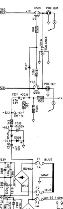

Pop from the preamp is probably an easier problem to resolve than a pop from the power stage. IIRC, your preamps do not use the JFET muting circuit?
Do both channels exhibit the same pop behavior?
That's right, no JFET muting circuit.
Pop only on right channel (see message #12 above). C518 is on the right channel.
