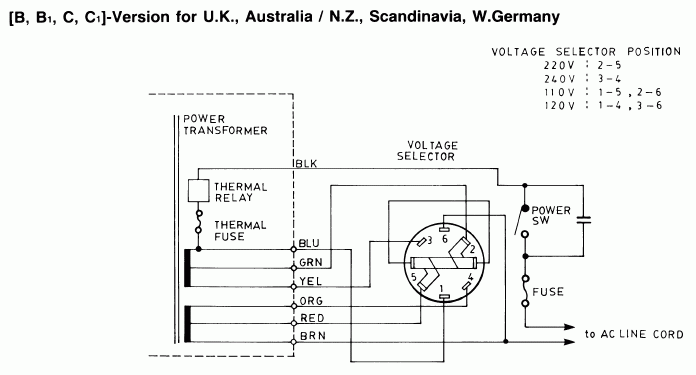

OK, Not sure if there where several issues but right now I am blocked with the voltage selector switch (european model) which has a broken carousel holding the V shaped contacts. Two of them (one V) where pretty damaged and eventually gave up. But I can confirm that the amp's LED did go on when I was pressing on this carousel.
Googled the part number (yks11-0010) but can not get anywhere online to order it. The selector seems to be in use on other audio products and has the following markings (220 110 120 240).
Any idea where to order ? or should I just solder the right pins ?
adviced me to solder directly the pins. I have the same problem with the European power selector. Which wires have to be connected directly to run it with 240 volt?
1 = blue
2 = Green
3 = Yellow
4 = Orange
5 = Red
6 = Bown
Could it be 2 + 4 and 3 + 5 ???
From the NAD 2600 service manual, page 7.

Had the same problem on my NAD2600. Wouldn't Power on. Found that the problem was the voltage selector. The two "locking ears" that holds Down the selector plate was broken, so the selector plate loose.
I cut the ears, drilled a 2,5 med mer hole in the center of the selector plate, and secured the plate in the selector with a bolt normally used to fasten a hard-drive in a computer. Added just enough pressure on the selector plate so I could turn the selector from 110-120-22-240 volts.
Worked like a clock afterwards.
The piece was not available anymore, I soldered the pins directly.
All working. The beast is back and the Infinity speakers are amazing.
