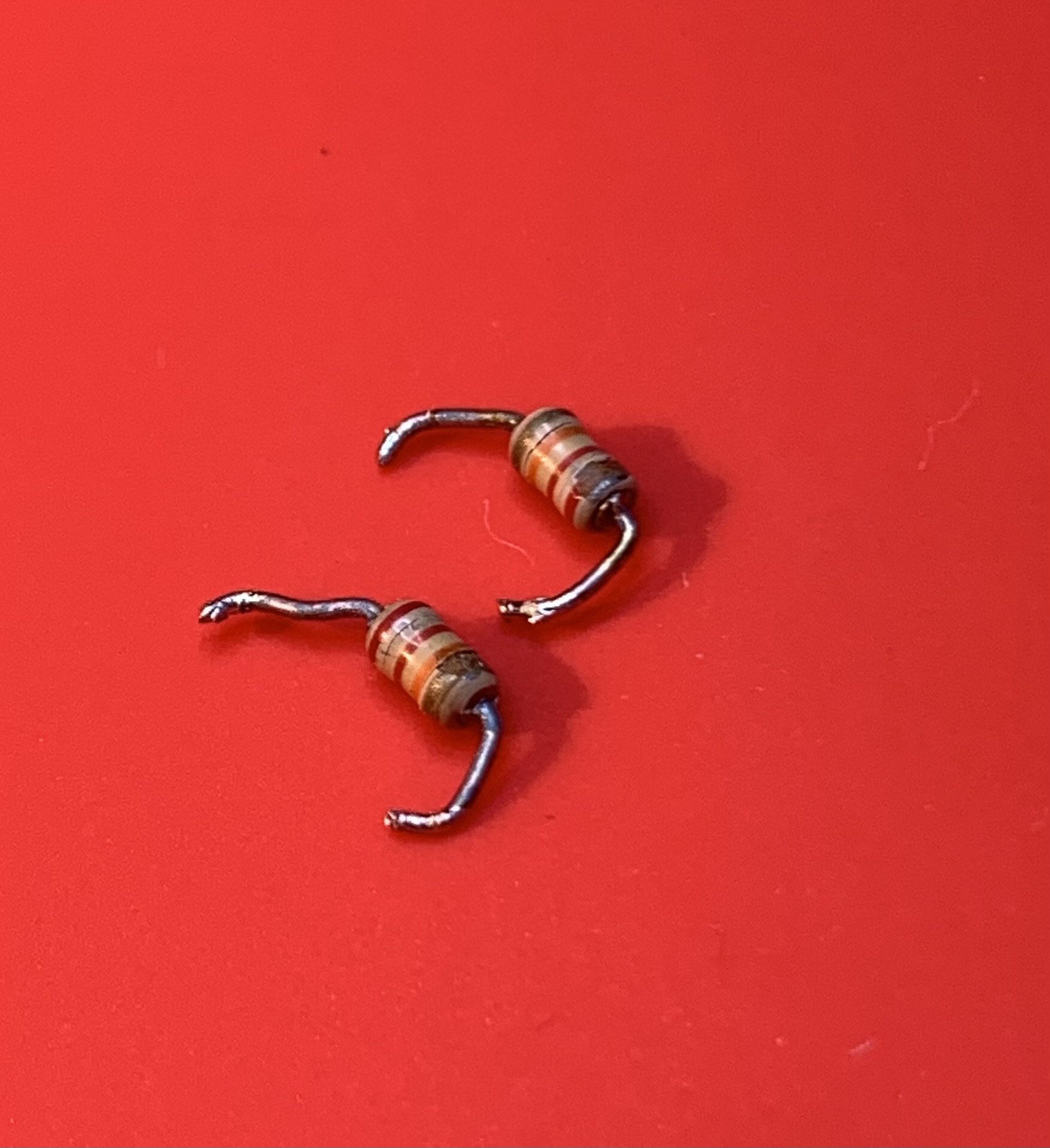

I'm just curious since I have the same issue with a 3400 amp. Changed some of the mentioned trannies, and changed 4 of the 4,7k resistors, 2 burnt...

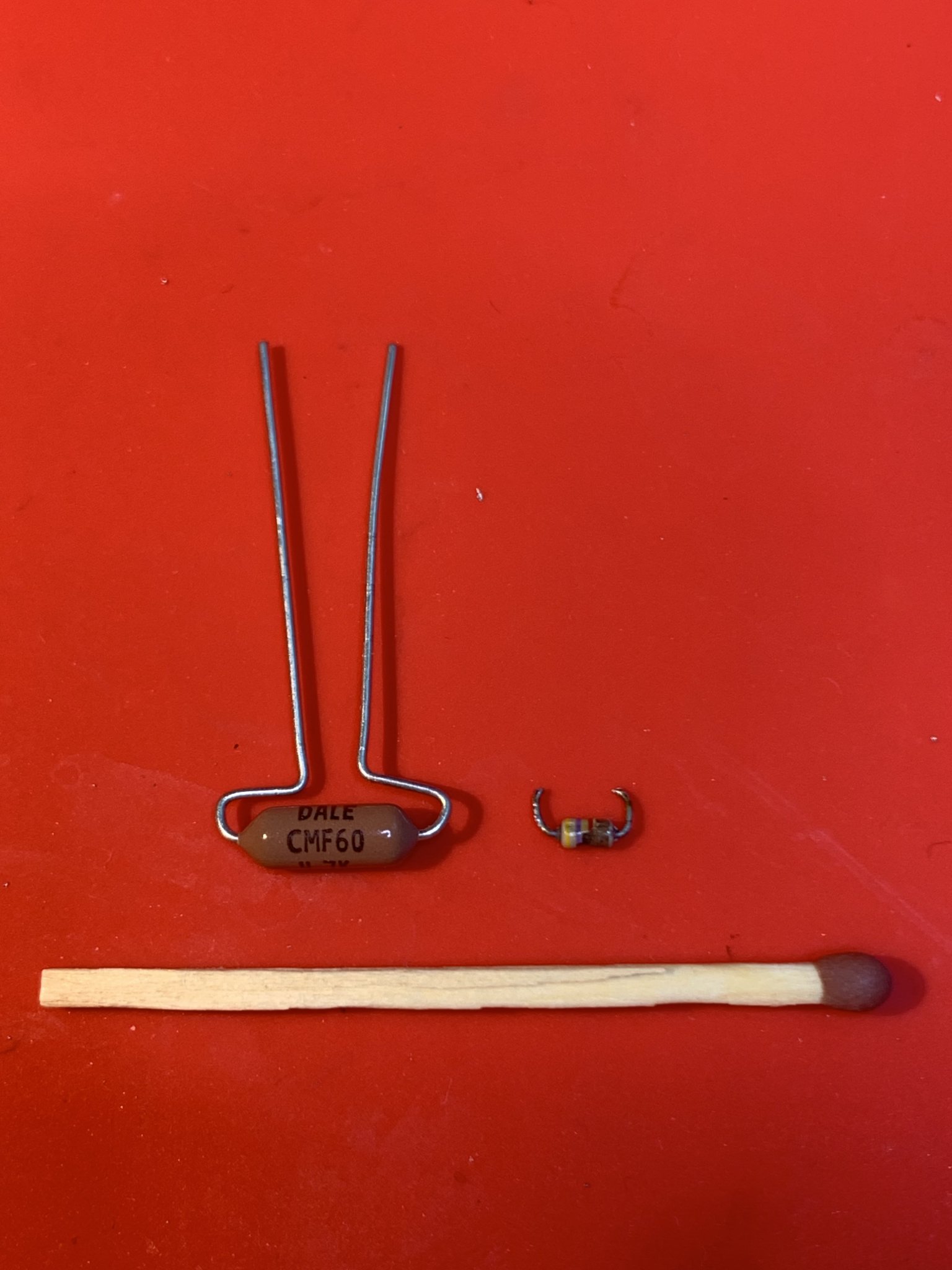

This is what i substituted the grilled 4,7k resistors with: 4,7k Dale metal film resistors, 1W. 🙂

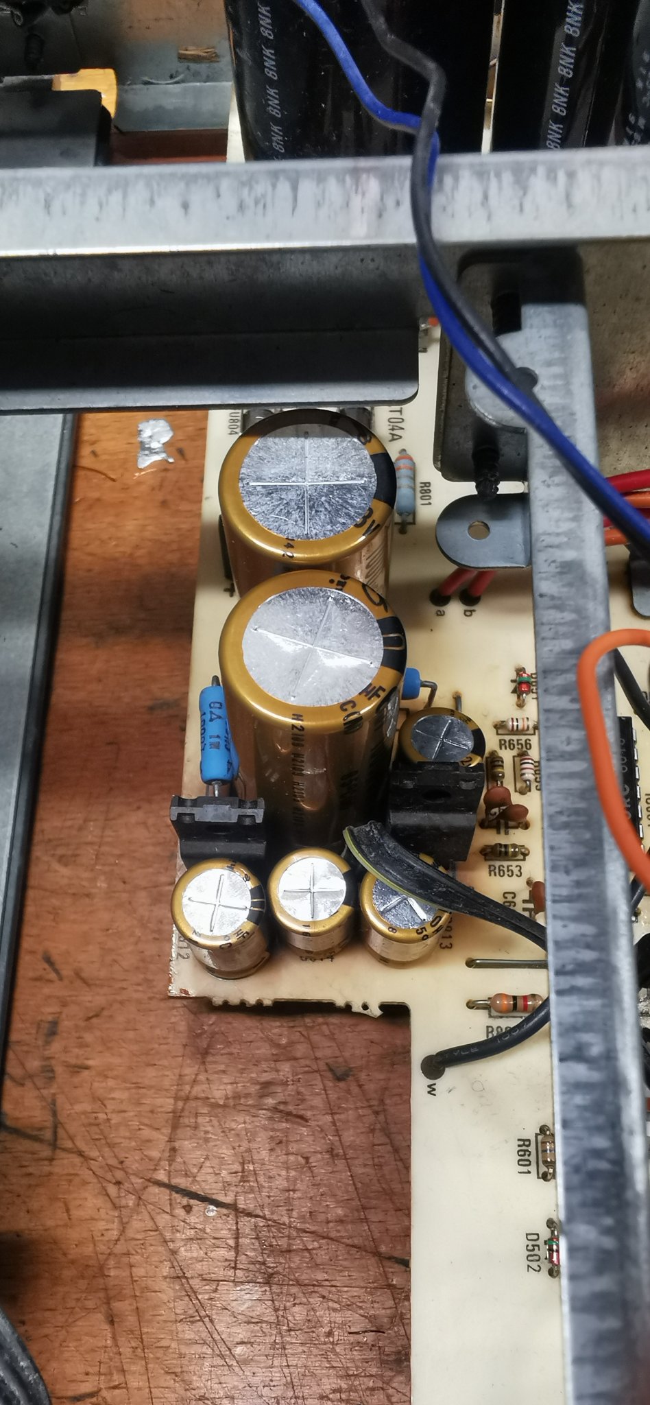

A good idea is to also upgrade the hard toasted 22k resistors: R030 and R034. I am working with the NAD 7400 reciever, and thats exactly the same amplifier board as in the 2400.

Looked through quirk audio, and tried to make a list with caps to order.
Anyone here did this upgrade?

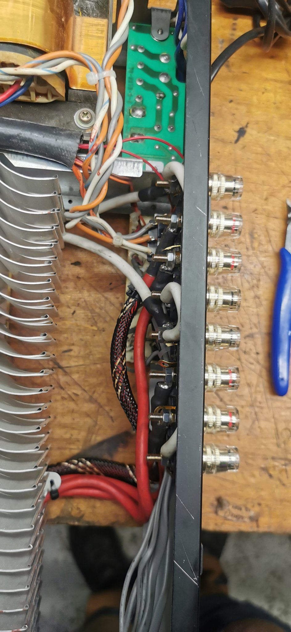

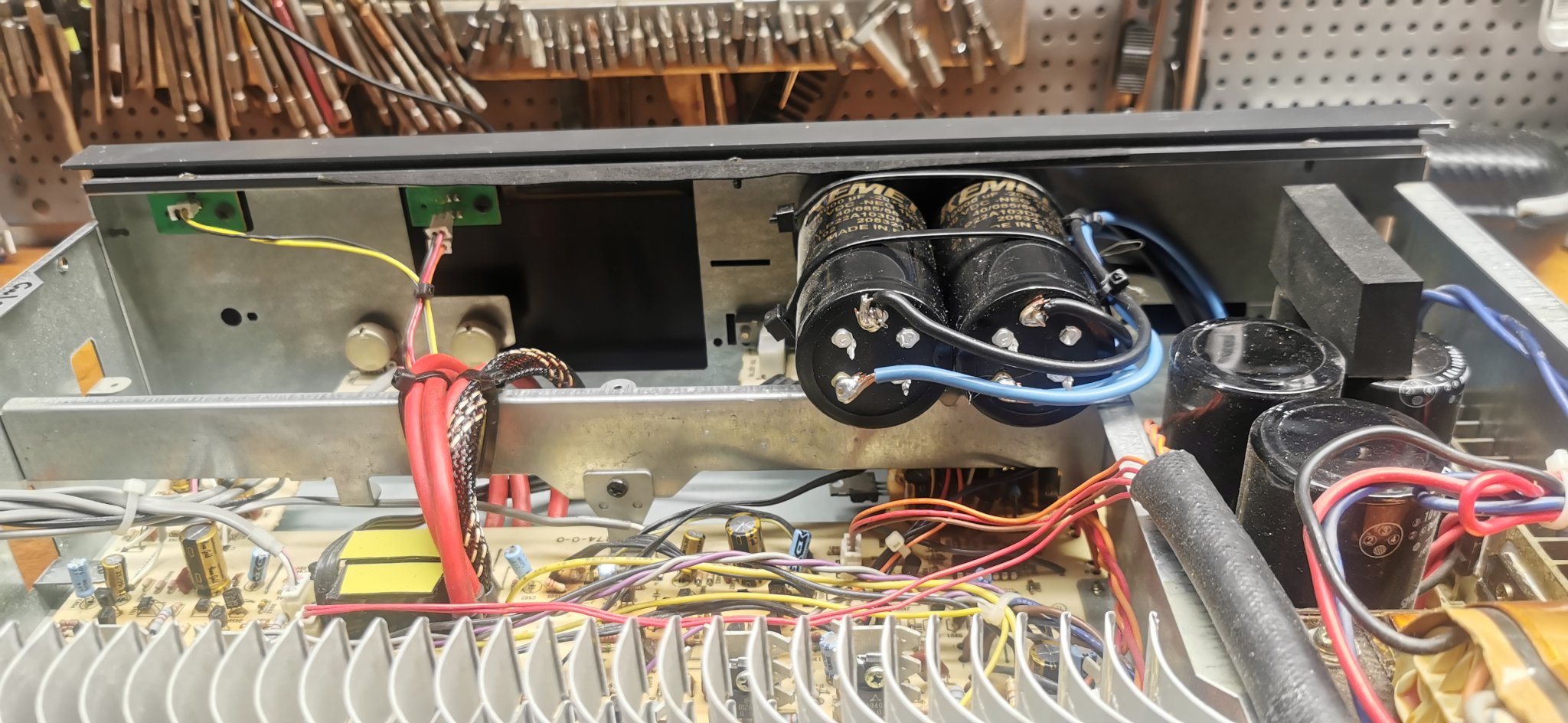

Just some pics for attention...
Better terminals and thicker wiring from relay to terminals.
2 xtra caps on the 100 volt rail.. Not sure if it have any effect, but they was laying around so better use them... Maybe better to have them on the 80 volt rail?
My thinking in that matter (adding PSU caps) is:
The ”low” voltage rails is the most important for everyday Sound Quality, since it is where you gonna be the absolute majority of the time playing music up to very loud. But, when you really wanna crank it up close to the absolute top: The high volt rails also gonna like some added caps.
