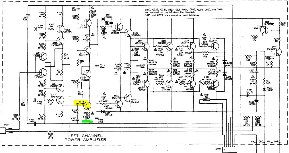

The first transistor I'm curious about is Q315 (2sc3788) - because of a lifting solder pad. The transitor may not be engaging the solder trace 100%. I plan to test further tonight. I tested the actual transistor and it tested good, but I'm just unsure the best way to work around the loose solder pads?
Helpful hints and suggestions please?! I can only think of a dremel or taking the legs directly to the next pad on the PCB - is there a better/easier method?
Best place to start testing? I get full rail voltage on the output transitor Collector (same voltage as the good channel), with Base and Emitter having mV (IIRC). Will write down tonight so I can keep the figures straight.
Added pic.
highlight the Q315 in question - Green is a resistor that was burned almost in half and caused the solder pad/trace issue. Complement of Q313.
Added pic.
I usually use solid core wire, 28 ga, wrapped around the component leg and stuck through a hole I drill in the board. Then I bend the wire over on the trace side and stick it down on the trace with solder. I have a pin vise to twirl the drill and usually use a #48 to #54 drill.
You could test your theory that the trace is not repaired by looking at the collector of Q311 (or is it 317?) to see if the DC is somewhere near the middle of the two rail voltages.

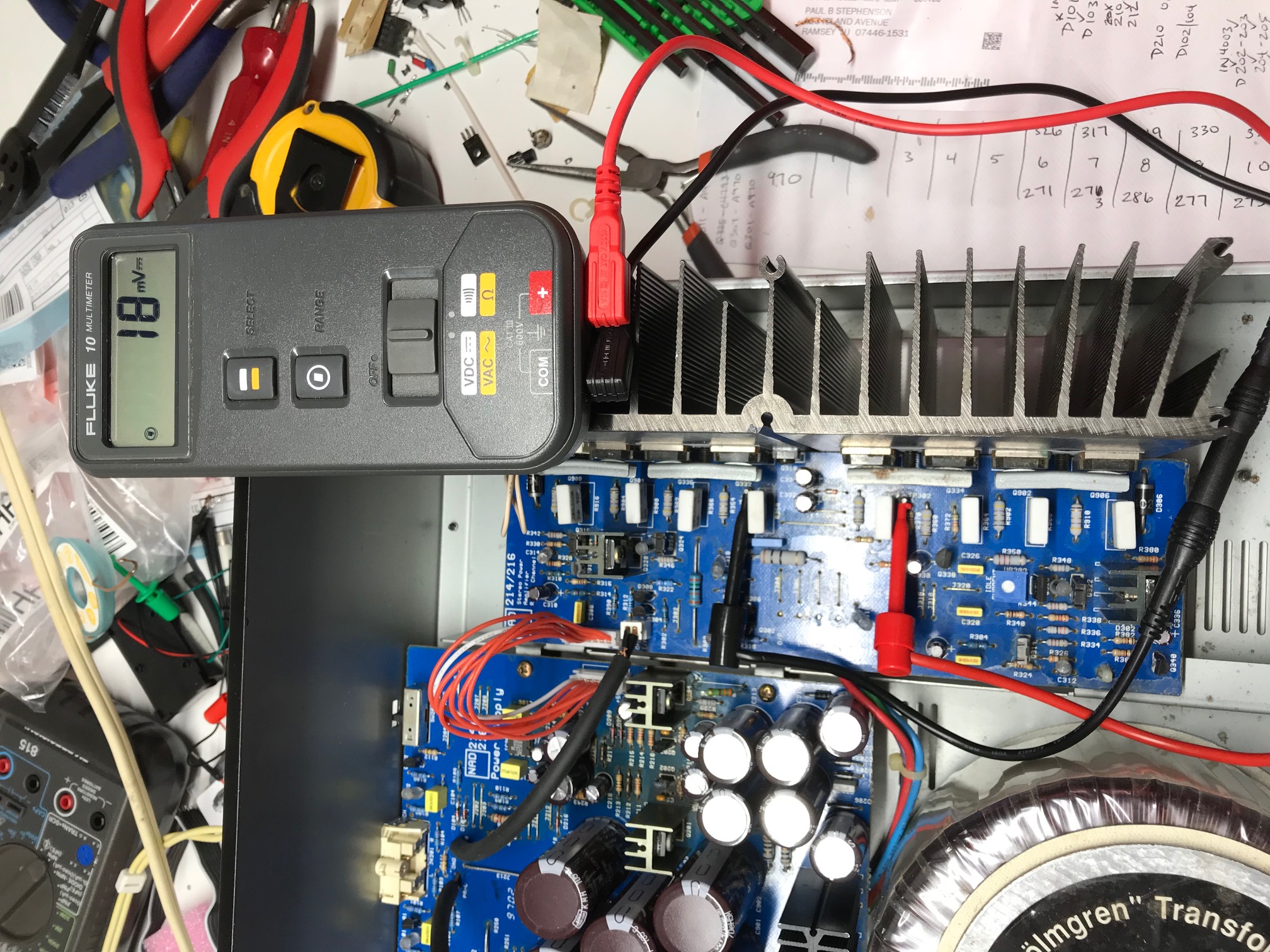

It was the Q315 (tested as failed when I pulled it (the 2nd time)) - changed it to a KSC3503 and soldered the legs directly to the closest trace points. Used the other channel as a guide with the schematic.

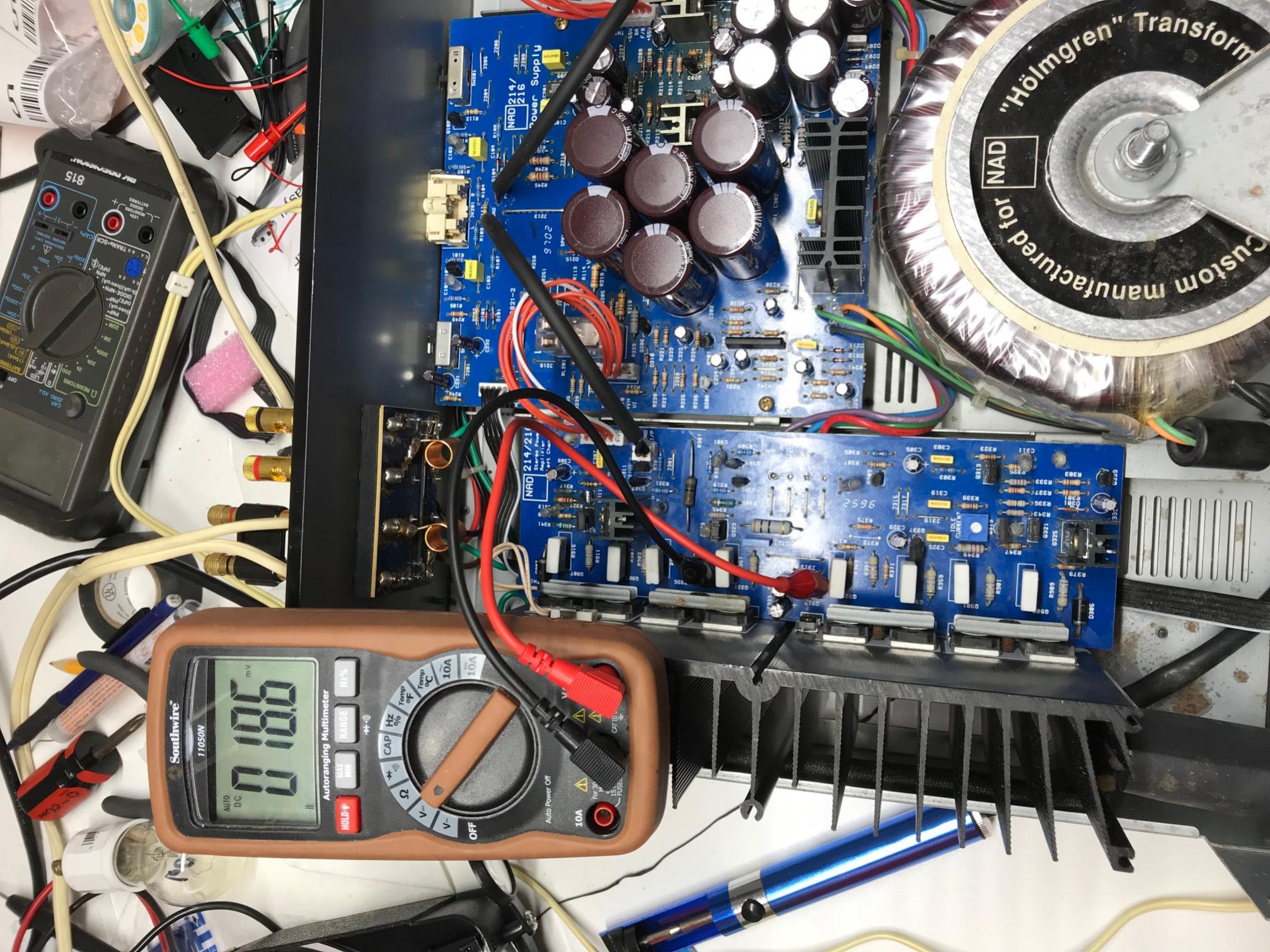

I tested with the DBT 25/40/60w bulbs without any issues. So I ran without the DBT and set the bias at 18mV. Offset on the speakers is 0mV sometimes dipping down to -1mV. Heatsinks were evenly heating, no hot/cold spots.
Let it burn-in for ~10 mins watching for any changes to bias or temperature on heatsinks. It all went well.
Plugged in my iPhone and listened to some music for 10 mins. No changes to bias or offset... so it was time to grab some actual speakers and listened for an extended time to some music (30+ mins.). No issues - sounds great!

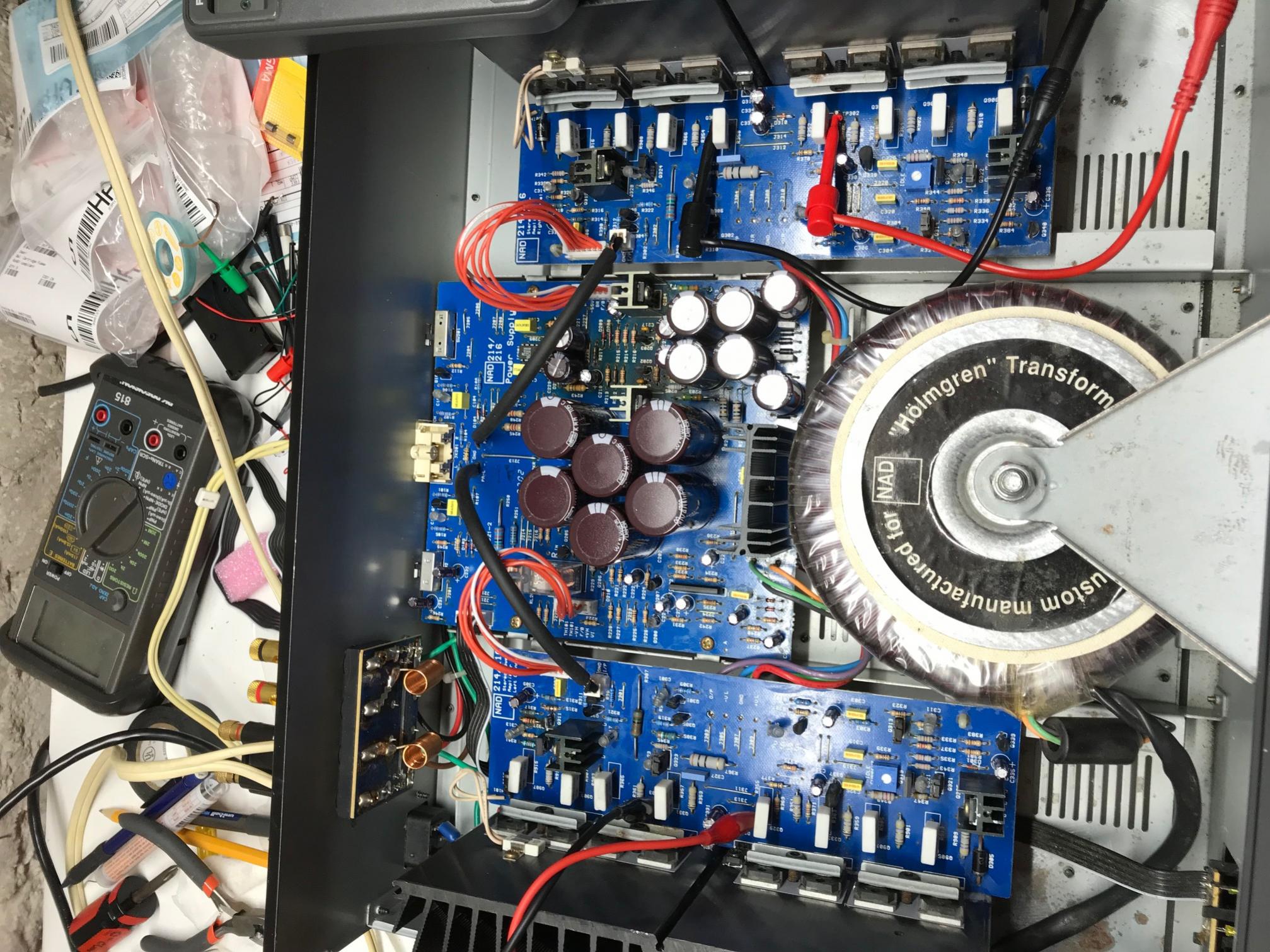

SOUNDS GREAT!!! Thanks guys for the encouragement, suggestions and assistance getting this little beast running again.
Pics of the final product.
