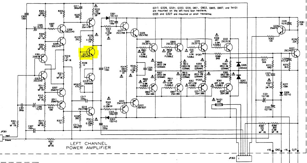

I tested the all the transistors one more time on the bad board, good board and PSU. Only one thing stuck out different to me and I think I just missed it (ignored it) the first two times around.
On the amp board there is a single Toshiba 2SC3423 (which is on the same heat sink as the power transistors 2SC3519/2SA1386) when I measure it - positive to Base and then negative probe to Collector and Emitter I get the expected 0.673 voltage drop, however when I switch the probes so I have negative on Base and positive on Collector and Emitter, then I get 1.8 and 1.9 voltage drop.
Shouldn't I be getting OL instead of 1.8-1.9? Does this confirm it is dead?
I'm asking because the only reasonable substitute I can find at DigiKey is a Toshiba TTC004B - not a perfect match but as close as I can find that is mountable to the heat sink.
Is this correct? Both that the 2SC3423 is bad and that the TTC004B is an acceptable substitution? I will replace it on both channels – so they have the same one, if I can’t get a more exact replacement.
I included a snippet of the schematic so you can see the position (not sure what is called in amp circuit terms - driver/pre-driver???
You can not reliably check parts in circuit at there is far to much interaction with surrounding circuitry.
If you place a link across C319 you will force a low bias condition and barring other faults the amp would operate normally but with no bias current (so crossover distortion may be audible at low level).
That transistor is just used for thermal sensing and sees little current flow and little voltage across it. Pretty much any suitably packaged common part would work as a replacement.
I would also be very surprised if it were faulty.

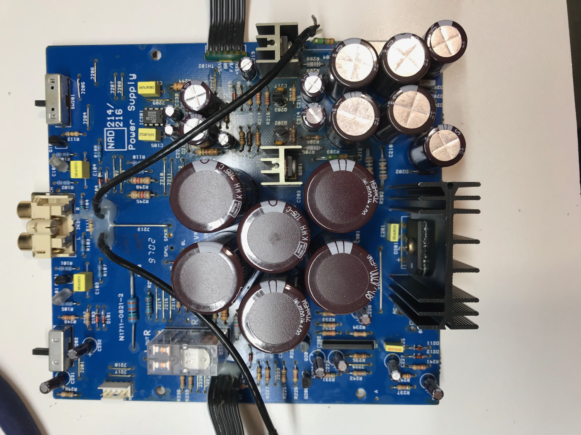

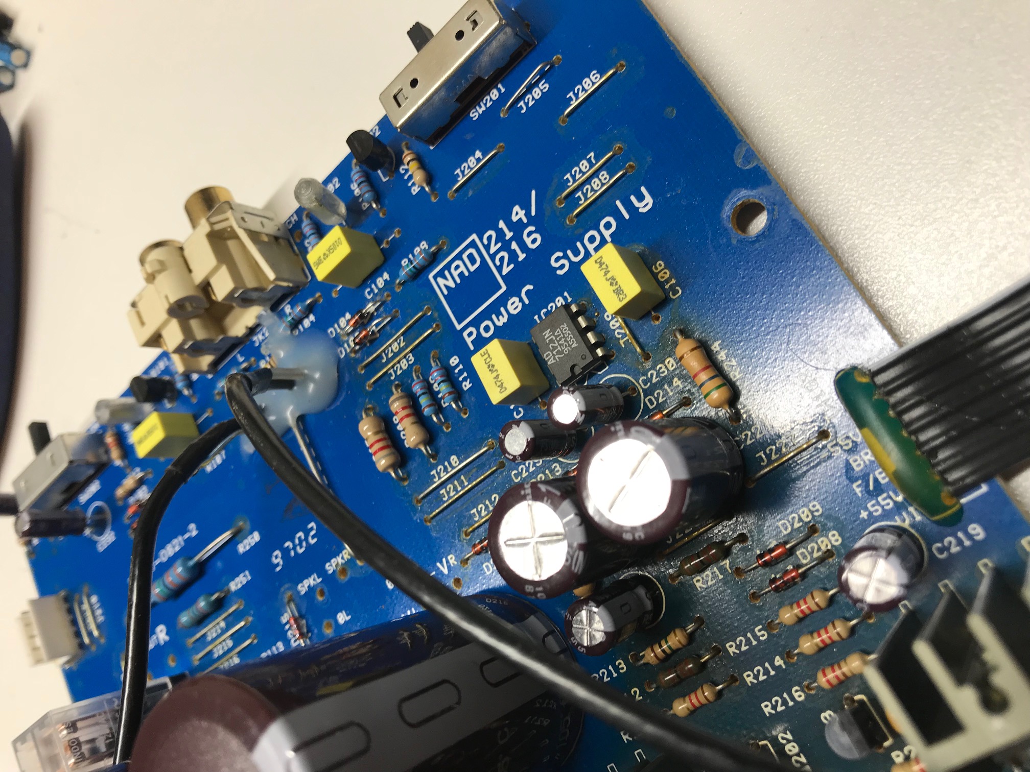

Update -
Made some progress on the PSU and took out all the caps, changed out an C2240 and correspeonding A970 transistor (Q202 & Q203) replaced two bad 1N4148's I found (actually replaced 3 but one tested good out of circuit). I tested all teh transistors 2-3 times as well as the all the resistors. I also put in a new OMRON relay since the OE seems to fail at some point.
I installed a new three-prong IEC inlet plug - the current two-prong plug had been crushed and one of the prongs was starting to come out of the plug. Not a perfect cut-out - so I'm lucky it's on the back and only seen by me.
Next step(s) it to install some quick connect plugs on the ribbon cables that attach the PSU to the amp boards and the inputs for easier disassembly (hopefully won't be needed - LOL).
A little clean-up on the chassis (small amount of rust) and I will be able to put the PSU back together and test for proper voltages. Fingers crossed it all goes well.
Then I can start roubleshooting the "good channel" and get it working, so i have a reference for the "bad channel".
Here's a couple upgraded PSU pics for reading this. All Nichicon PS caps

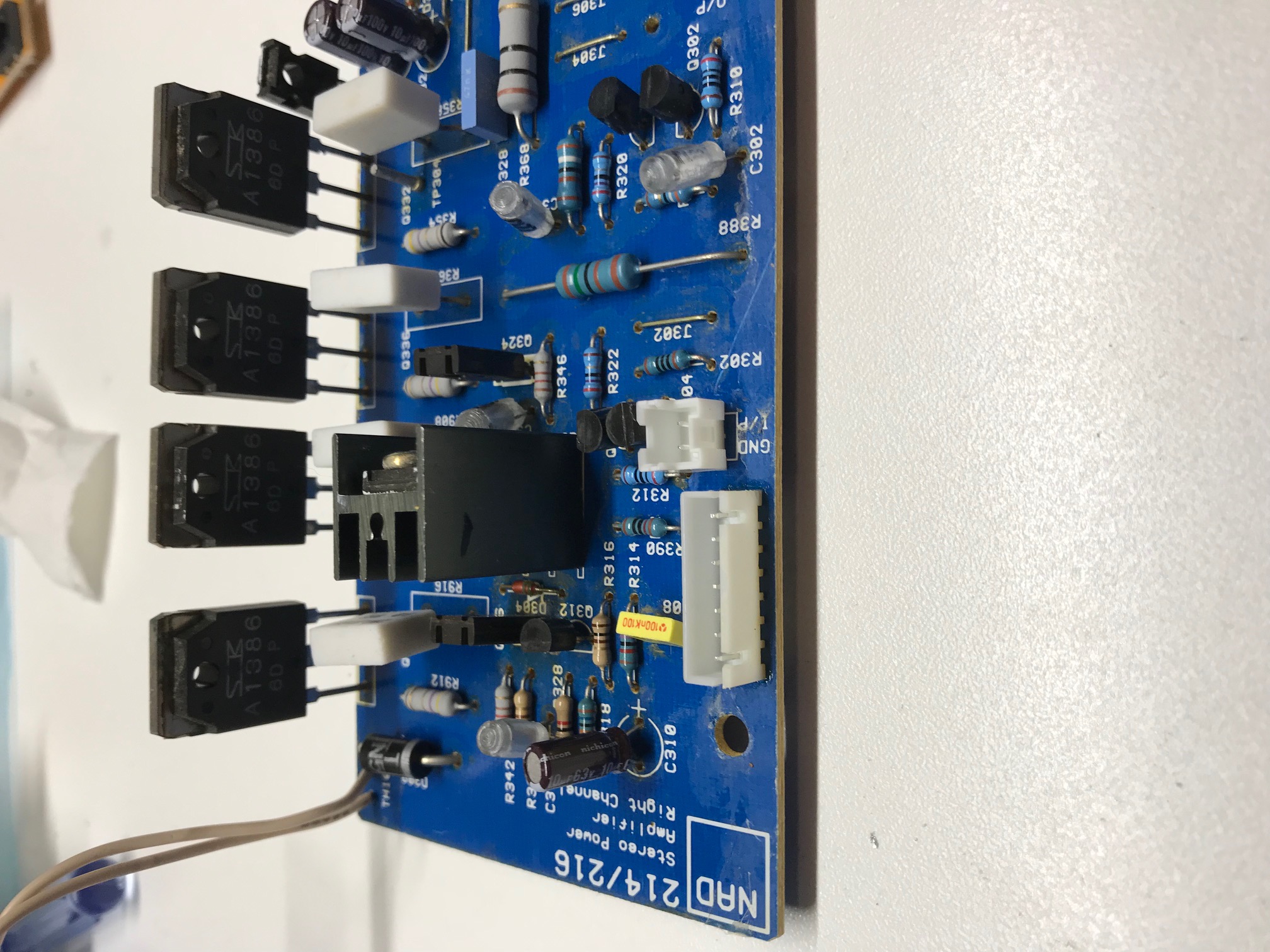

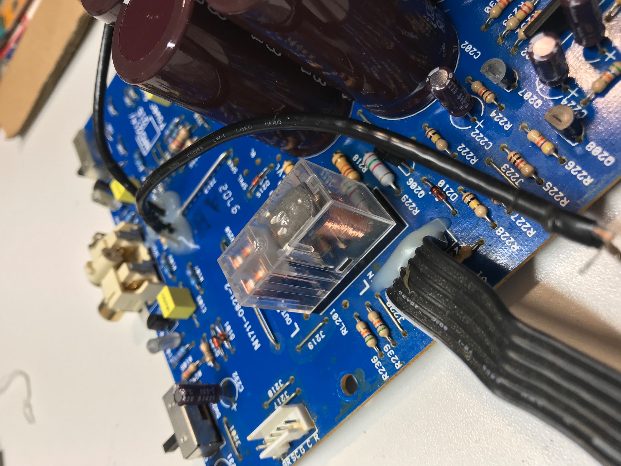

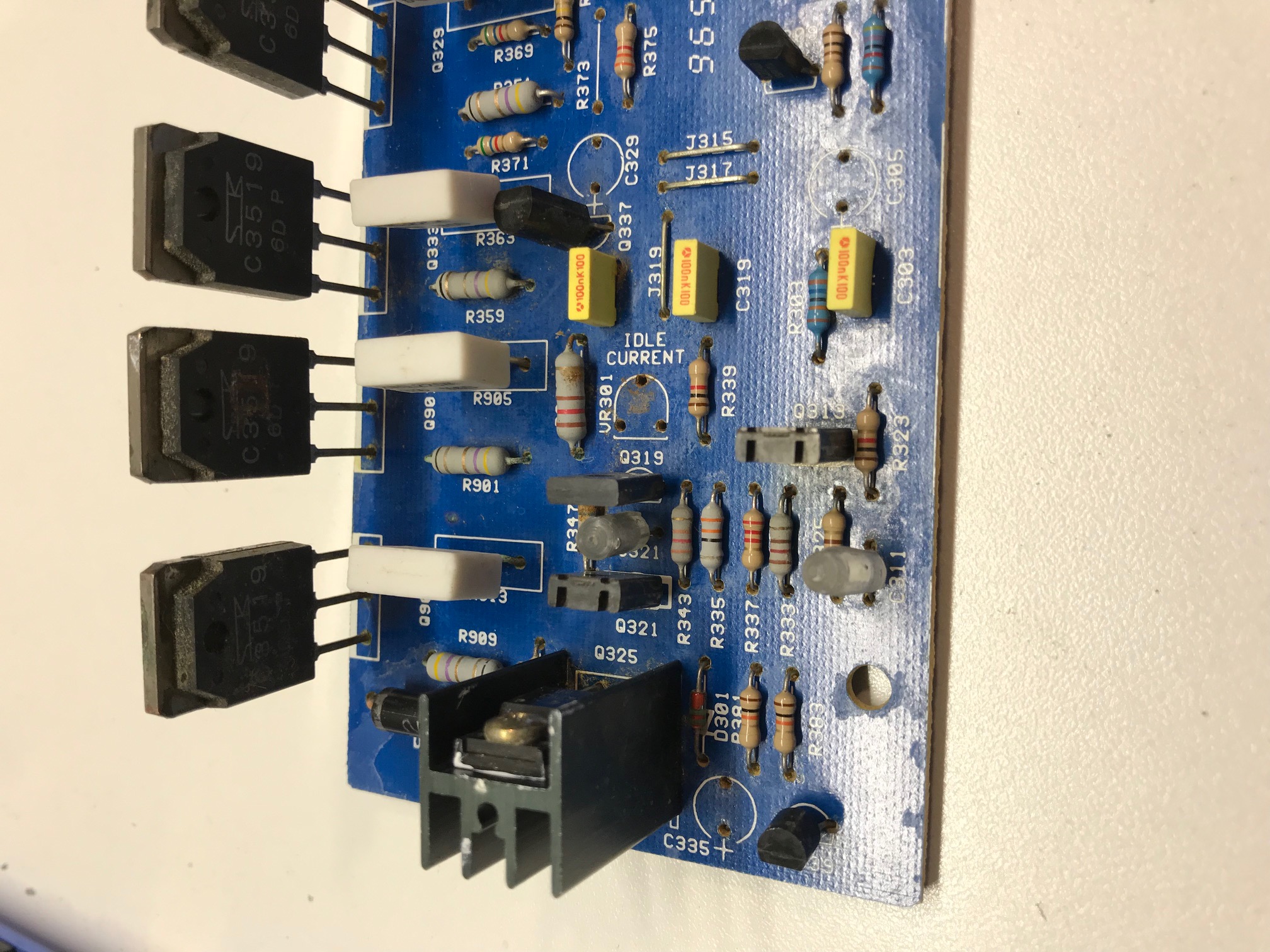

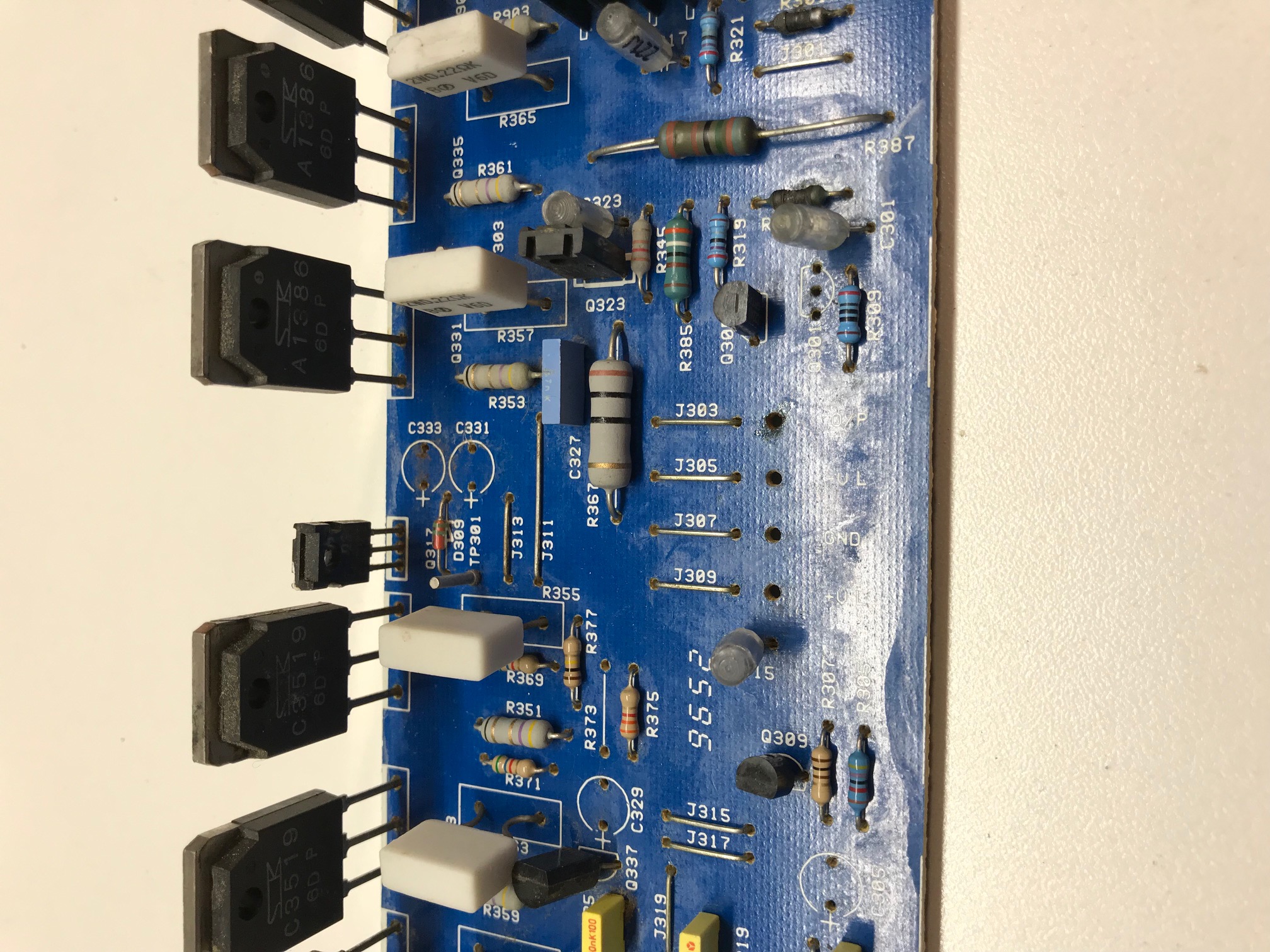

So I have made some more progress on this project. I bought some JST disconnects for the secondary power, thermosistor and over-under current from amp-psu as well for the inputs and changed the input signal wire to Mogami mic wire.
Also I have checked all the transistors and replaced the capacitors on the right (good channel) amp board. Cleaned it up top and bottom and looks to be ready to put back in the chassis.

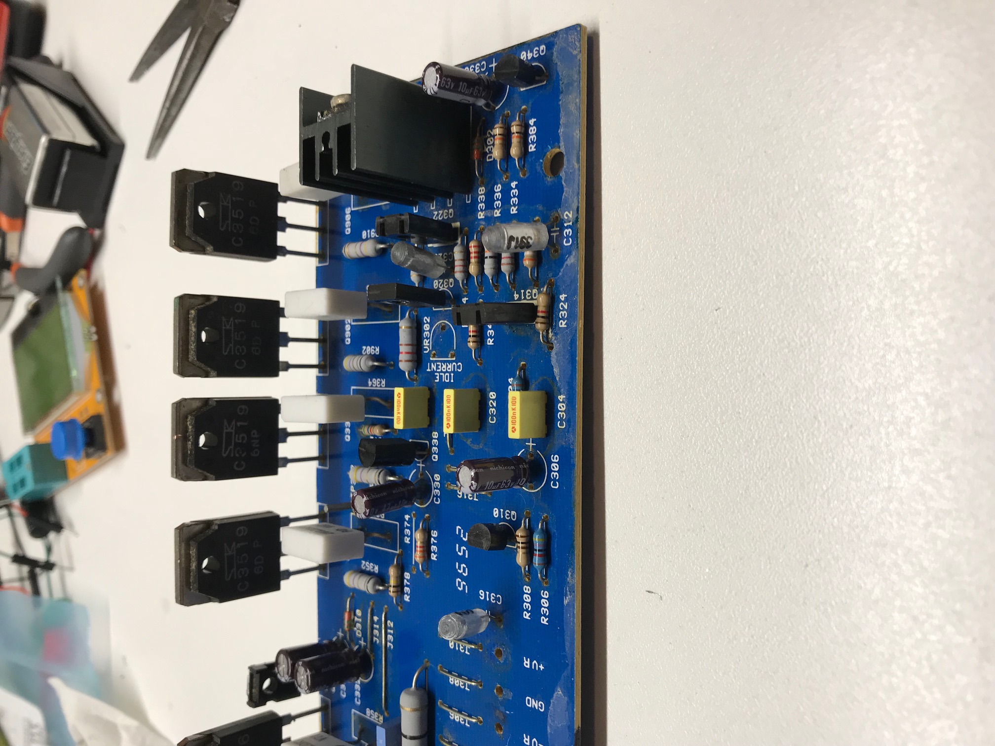

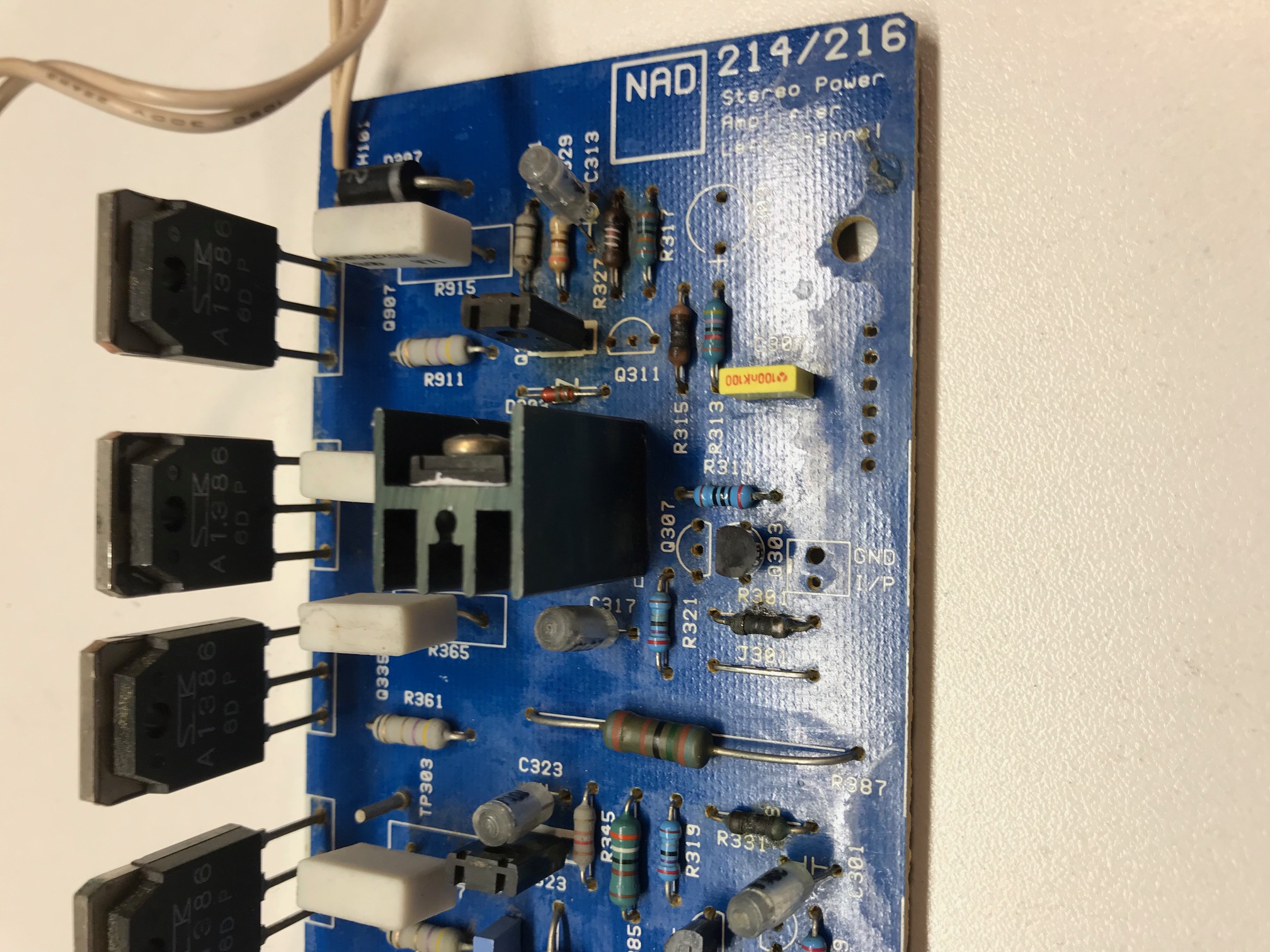

As for the left (bad channel) I have a few questions:

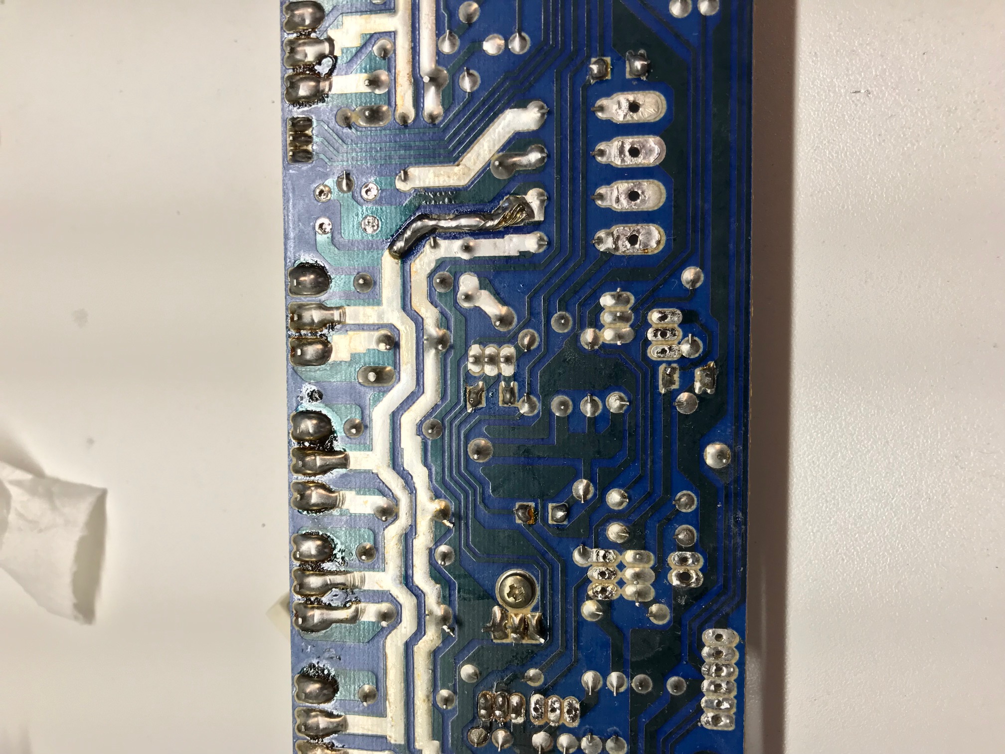

- I replaced a burnt/lifted ground track (see pic) on the bottom
- I took out all the capacitors (two of which were blown apart)
- I tested all small-signal and pre-driver transistors and found 3 bad ones - all are 2sa970's (one had the plastic case broken into pieces)
- All the power transistors (C3519, A1386) tested bad - shorted
- no other transistors failed (I pulled and tested all of them)
Is it normal for only the power transitors to fail, destroy the ground track and 3 small signal transistors, while the pre-drivers and other transistors test good?
Should I go ahead and replace the corresponding transistors? A970 is bad, replace the c2240 as well?
Also tested the PSU with a 25w, 40w and 60w DBT - and the +/- voltages test good, however it stays in Protect mode. Is this normal? Also verified the clip and bridge lights work, the switches were dirty, but cleaned and working good now.
Added some pics for clarification. #1,2 are the Right channel (good) and pics #3,4,5,6 are the Left channel (bad)
