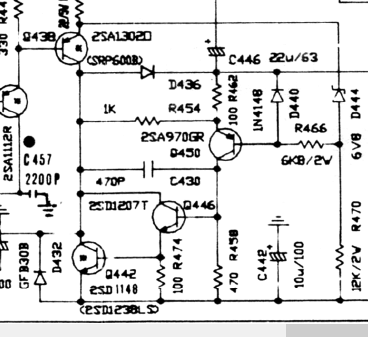

I'm starting to pull my hair out on this one... A little background first....
I re-purchased this amp cheap from a friend who blew it up. Most of the output transistors and their drivers on the right channel were toast.
As it sits now, there are absolutely no output transistors in it (center heat sink is completely empty) and there are no drivers in it either. I'm stumped as to why it still won't come out of protection mode. The one thing that is baffling is that I'm getting good voltages everywhere except the -45V rail (low-power side of the power envelope). I get -65.9 volts on 4-ohm switch position or -71.1 volts on 8-ohm switch position. The 10000uf/50v cap (C510) is in danger. That -71 volts travels everywhere and I don't know where it is coming from. I've checked just about every transistor, resistor, diode and cap in this thing and can't find the problem. AC voltages from the transformer to the fuses and the rectifiers are all good.
Anyone who has experience with this amp and could help me, it would be greatly appreciated.
Also, center voltage check is at -5.80 volts left channel (checked at R471) and -5.78 volts right channel (checked at R472). Obviously why it's stuck in protect.
Idle current is not adjustable (as there are no bias transistors in it) and at 5.7mV left channel and 5.4mV right channel.

You mention outputs and drivers but have you checked the rail switching transistors and their commutation diodes? Any of the semiconductors here could have failed allowing the high voltage to couple into the low voltage rail.
are you sure the filter cap is functional, almost sounds like you might be reading the peak voltage the rectified output. do you have the ability to put a scope on the dc rail? if not maybe you could just use the ac function of your meter and see if you are reading any significant ac voltage.
Filter caps were taken out and measured. All seemed within spec. Upon further measurements, there is identical voltage between the negative high voltage rail cap (C508) and negative low voltage rail (C510). Both are at -74.8V. There must be a short somewhere between the two as suggested by Mooly.
