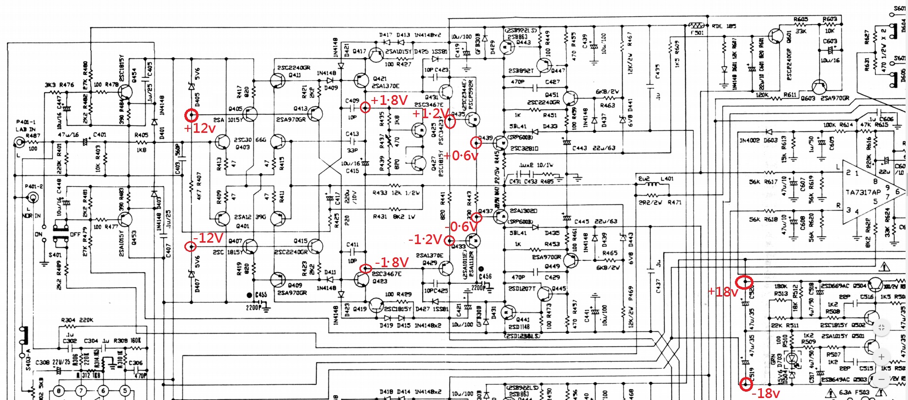

I have an NAD 2100, worked fine, that I recapped. It now will not come out of protection mode. I'm fairly new to SS repair. Any thoughts on where to start with this? Also, the protection light does not stay lit. It blinks. If the speaker switches are pushed in, I can hear the relays working. Lastly, there is a dead short across c510, whether or not the cap is in the circuit. I don’t see why that would be. All the test voltages are good.
And just to make it more complicated, for me anyway, I have a second 2100 that stays solidly in protection. No relay click or blinks. It has 30v at r471 where it should have about 100mv. Thanks for reading! Hoping to get these things back into action.
To check if the amp in protection for a DC in the output , use DMM measure the output coil L401/402 voltage to the groung.
A dead short across c510 means something short in the circuit, you have to test all the possible components like output transistors.
I make the voltages reference for your amp, please check them. If one voltage abnormal, please check the components around.
Please connect a DBT (dim bulb tester) for the amp under testing.
Please check if they are short D502, C445, C446
So I have the +-12v at 405 and 407. I have 55 and 58v at c409 and c411, should be 1.8. At q433 and q435 I have 60v, should be 1.2. At r443, the q437 side has 18v, q439 side has 29v, should be .6. I have the 18v at c519 and c520. Any ideas at this point? Thanks for the help so far.
No shorts across c445 or 6. On d502, when I have my positive dmm lead on the negative side, I have continuity with the other legs. With the negative lead on the negative side, I have no continuity.
Please confirm which amp you make the measuring results.
suggest to do the test below
For first amp :
the amp in protection - to check a DC in the output , use DMM measure the output coil L401/402 voltage to the ground.
a dead short across c510, check if they are short D502, C445, C446
For second amp : It has 30v at r471, check voltages with the reference.
For first amp :
