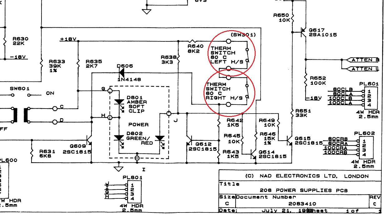

Normal NAD 208 turn on no red light and with a few minutes later just green light on.
Your amp turn on red light when you power up and the red light on means the heatsink temperature sensor open circuit. Please check the cable connection problem or just the sensor open circuit(sensor should be close contact in normal).

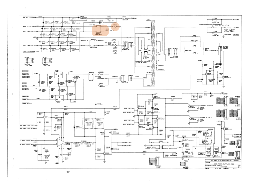

I as just about to order some parts to replace the caps and IC on the protection circuit and decided to check on the fuses once more. I was sure I checked them but I was proven wrong. The 10A (F502) fuse was blown. Replaced it with a fresh one this morning and it immediately blew when switching on the amp.
So, the whole protection mode problem might have it's cause somewhere else, misleading us to look at the wrong place.... sorry for that.
Nevertheless, I would still like to get it up and running, so here is my plan:
- Exchange BR501 and C518
Question is whether this will solve anything or a blowing fuse like this might have a lot of different causes? Would you recommend replacing other parts and give it a try?
Gentlemen,
thanks for all your recommendations and apologies for the late reply. Covid-19 also hit Austria and I had other issues to deal with.
I was just about to order some spare parts for the 208 to replace the caps and IC of the protection circuit when I retested the fuses. I was sure I tested them, but was proven to be wrong. The 10A fuse (F502) was blown and after replacing it with a new one, it blew up in the second I switched on the amp. So there might be a completely different cause for the protection circuit problem we were discussing before.
So, my plan is to replace the bridge rectifier BR501 and cap C518 (10nF, 250V) as the are following in the path.
Does this make sense or might the problem come from the other side. Or might the blowing fuses be caused by some deeper problem burried in the labyrinth of the schematic?
Thanks again for your recommendations!
First you can take out the the bridge rectifier BR501 and cap to test if they are failed, after that you should measure the bridge rectifier output sides +v and -V if there are any short circuit, if no short circuit in both output sides, you can try put back good bridge rectifier BR501, cap and fuse to test.
Good luck!

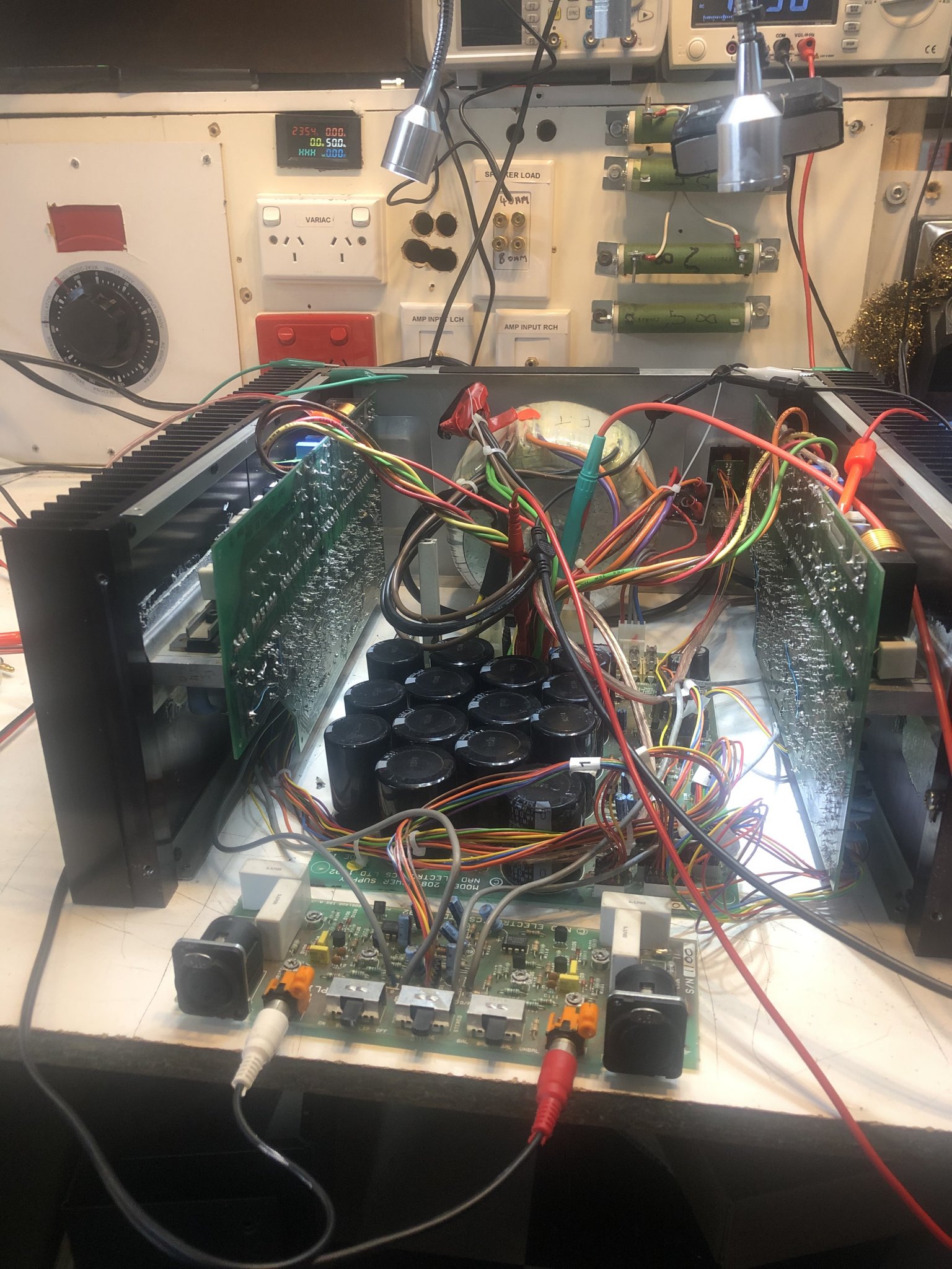

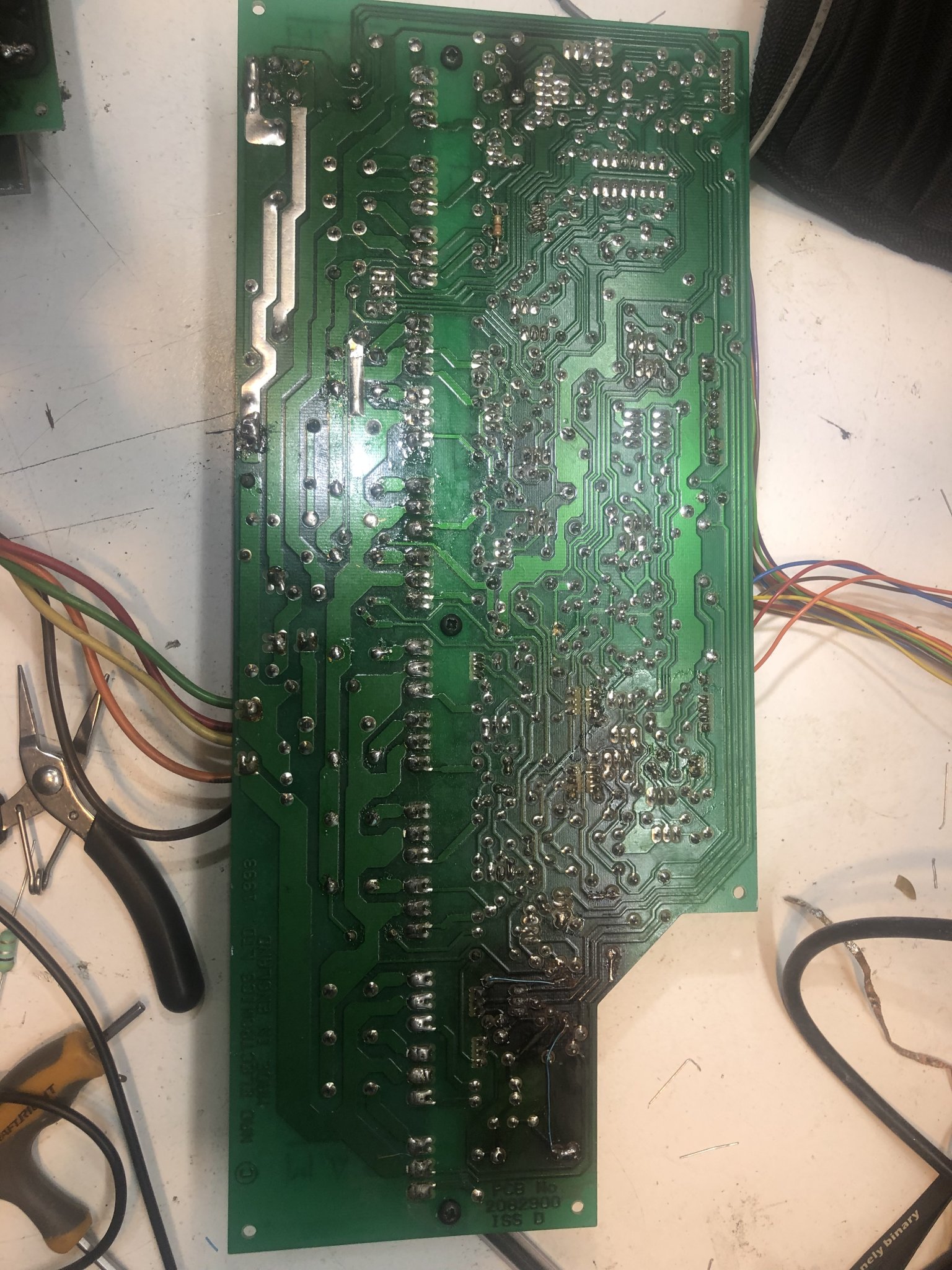

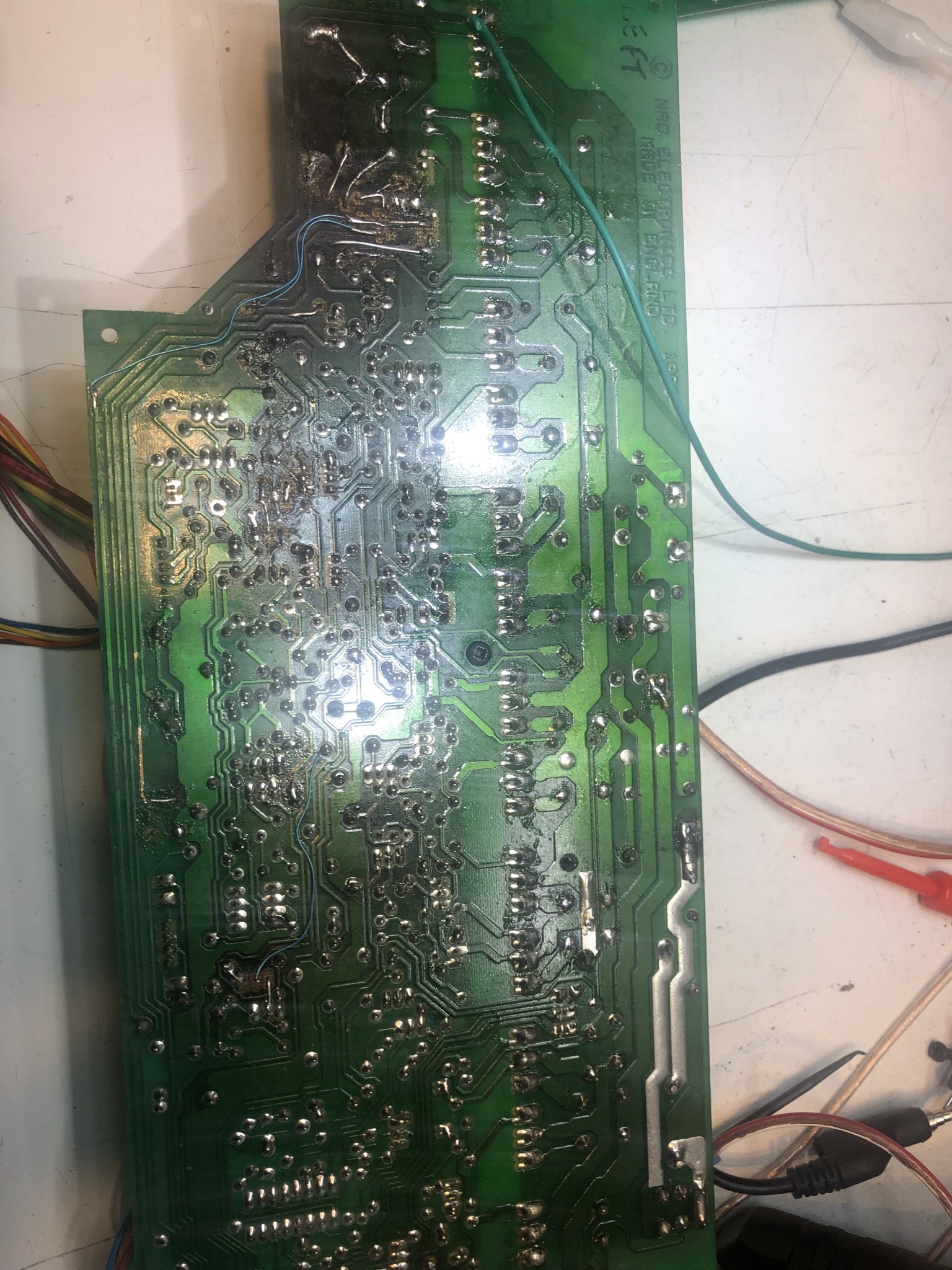

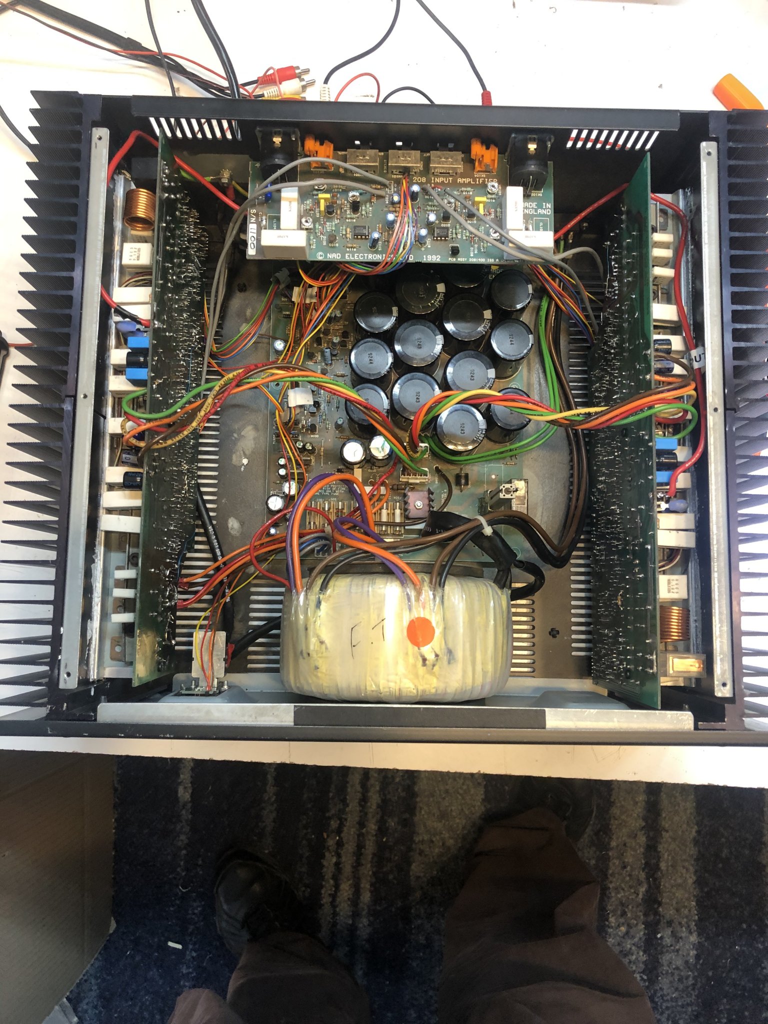

Christian did you get a result. On your NAD208 protection problem
I have just fixed a NAD208 happy to help you with working it out as I eat and breathed this model for 6 months rebuilt after both outputs destroyed
Cheers
Wayne
