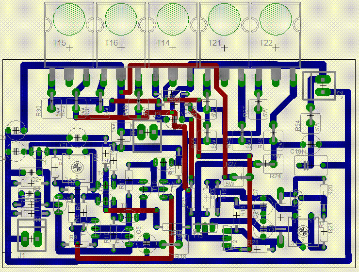

Preliminary Zeta PCB
Howdy people. Here's a preliminary ZETA PCB with 5 output devices. Preliminary because I intend to make it single layer... If anyone interested to build it as is, I'll post the PDF. Dimensions are 11,5 cm / 7 cm. Sorry but these are Eagle's limitations... I know it looks a little bit messy but what to expect from something done in few hours? I'll try to improve it. Next week-end.
Valentin
Valentin
Ok Andrew you're right. I'll change some footprints and try a new pcb 13/10 cm this time, with a lot of space between tracks (Using the same topology from eagle I will try it in ExpressPCB).AndrewT said:Hi Bubu,
some of your tracks are a little close to each other.
Try adding alternative cap pitch options.
Are your resistors mounted end on?
Why an odd number of output devices, I would expect to see even numbers (pairs)?
). What do you mean with alternative cap pitch options? All components are on top layer very close to each other... About the odd number of output devices you forgot the IRFP9240 driver. I will build this amp and make all my speakers active.
Cheers!
Valentin
