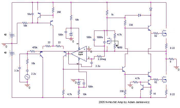

darkfenriz said:Hallo N-channelers
How about this topology?
What do you think, pros, cons ?
regards
I think this was posted earlier in a different thread (?). It is essentially JLH VAS/phase splitter/output section with a differential input stage.
I suspect the output stage works in class a as well.
Dark: do a search on the creek amp and you will see something identical to what you have.
as to what class, I guess it depends on how you set the "variable resistor" (consisting of a mosfet, a 4.7K resistor and a 4.05k pot).
to understand how the output stage works, you can combine the mosfets and their drivers into one device. the lower output device is connected to the emitter of the phase splitter (the trransistor that has a 330ohm resistor to its emitter), and the upper output device is connected to the collector of that phase splitter. so the upper and lower devices are exactly 180 degrees opposite of each other -> identical to how the jlh works.
to make it work in class ab, you will need to turn on the "variable resistor" just enough so that when the phase splitter starts to shut down, the voltage drop off the 1k and 330ohm resistors start to decrease -> turning on the upper output device.
the opposite works for the lower output device.

Hi tlf9999
Let's assume I actually understand how it should work, in fact I designed it several days ago.
In creek there is a P-ch's source driving an upper power N-ch (diamond buffer strusture) and simultanously lower N-ch by its drain. Correct me if I'm wrong, but I think it creates low open loop output Z. In contrary what I've attached is a transconductance amp ( higher output Z).
The amp I've atached isn't something completely new, there are some similar ones, for example by A. Holton. Just added some bits and pieces here and there (DC servo, inverting mode with uncommon compensation, highish current bjt drivers without output swing limitation achieved by two diodes, thermal stability) and wanted a bit of discussion and anaysis before realife amplifier synthesis. Worth?
regards
If you mean 4330 amp, than I get a bit confused.do a search on the creek amp and you will see something identical to what you have.
In my attached amp phase splitter has a gain of 1 (330ohm both on emitter and collector) for appropiate 'work sharing' between N-CHs. In jlh it isn't vital, because it works in class A (and thus collector resistor is a pot to adjust bias). Also gain depends much on hfe of power transistors. Note that in original jlh biasing of output stage may be dependent on rail voltage, which would be a disaster in class AB.to understand how the output stage works, you can combine the mosfets and their drivers into one device. the lower output device is connected to the emitter of the phase splitter (the trransistor that has a 330ohm resistor to its emitter), and the upper output device is connected to the collector of that phase splitter. so the upper and lower devices are exactly 180 degrees opposite of each other -> identical to how the jlh works.
regards
darkfenriz said:In creek there is a P-ch's source driving an upper power N-ch (diamond buffer strusture) and simultanously lower N-ch by its drain. Correct me if I'm wrong, but I think it creates low open loop output Z. In contrary what I've attached is a transconductance amp ( higher output Z).
But what does that P-mos do? it creates two output signals that are opposite of each other -> a phase splitter, which is precisely what the bjt does in your or jlh's design.
that's the simple point I was trying to make and I hope it comes across this time.
darkfenriz said:The amp I've atached isn't something completely new, ... Worth?
regards
and it has been tried multiple times with success. Worth it? I cannot answer that for everybody else.
Hi Darkfenriz,
I think you have only simulated it, but dear we have prototyped a similar amp like your's 5 years ago which features same output stage and driver stage and it cross- conducts very well...
It would be very good to hear if you have prototyped it and it is not cross-conducting!
regards,
K a n w a r
