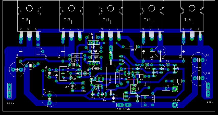

Hello Mik
There are several errors in your design.
You should change D/S of T14, and also C5 and C10 are not directly in parallel. There may be more errors, these were just
a couple that caught my eye. A good method is to highligt each connection in your CAD program, and then with a highlight pen, draw the same connection on the paper schematic. This way any error will be very visible.
BTW here is the new location of the ZETA page
http://www.lightball.dk/zeta.php

Mik: I am sorry but i can not give you any feedback as to wheather the PCB is ok or not, but i can see that C5 and C10 are still connected in parallel, as they should'nt be. 😉
Are you referring to the 'P' in the middle of the schematics symbol ? 😀
It was N simbol for 9240 in the shematics library but i didn't notice that until you pointed out .

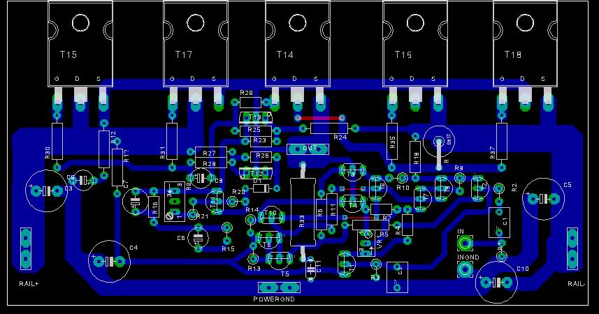

PCB Checking
Mik,
I am not sure why Lars states:
I have tried to take a look at your PCB to just see if it matches the schematic. I am no PCB expert to offer any feedback on the fine art of PCB design.
It seems you have changed a number of the part number assignments to ones used in the posted Zeta schematic. Can you post the schematic with part numbers and values that was used to design the PCB?
It takes far less time to compare your schematic to the posted Zeta schematic. It may be helpful to everyone and yourself if you use the same part numbers in your schematic as in the posted schematic where ever possible.
I do not have time to check the PCB from wiring perspective. I suspect many others will no thave time to cross reference your parts numbers to your PCB or schematic to validt e the PCB. The need to cross reference your schematic and part numbers to your PCB adds additional layers of possibility to missing or introducing errors in your PCB.
I will say the PCB you have designed looks promising and reasonability designed. You may need to find out and confirm if BD136, BD135, BC515 and/or IRFP9210 need to have own heatsinks and/or be thermally coupled to the output drivers and/or thermally coupled to some of each other. For example it may be helpful to have BD136 and BD135 placed on the PCB back to back with about 10mm space between then and enough space around them to allow a single heatsink to be used to join BD136 and BD135 so they can thermally track each other. That would mean allowing enough space for the type of PCB heatsink that has fins on both sides of heatsink and single flat piece inbetween the side fins so parts do not obstruct the heatsink. I would allow for a PCB based fin heatsink for IRFP9240 as option.

mik said:It was N simbol for 9240 in the shematics library but i didn't notice that until you pointed out .
Is it O.K now?

Sorry guys ! I found another two mistakes in my schematics,I left out R19 and junction between T9/T10 and R15/R16 so everything I posted above is not to be used.
Since Eagle desn't have IRFP9240 in schematics library i made it myself but by mistake i put N channel mosfet simbol instead of P channel.

Re: PCB Checking
Thanks Keypunch for you comments!
My pcb design corrispond to same part nubers as they are in Lars shematics except power transistors which are T15/T16/T17/T18
Schematics

Re: Re[]: PCB Checking
Mik,
Thnaks for posting the schematic of your design. I thought when I saw the PCB, but was not sure until the your posted schematic the output driver emitter resistors were not on the PCB. Given the output driver emitter resisters are not on your schematic, I can see why I did not see them on the PCB.
I would suggest you include the emitter resistors on the schematic and your PCB. I understadn the original schematic indicates the emitter resistors are not needed for one or two output drivers. To be honest I think it is useful to have the emitter resistors even for one pair of output drivers, but once one goes beyond one pair these emitter resistors are really important to have and use. Even if one matches the mosfets before installing on the PCB, it has already been commented from others experience once mounted and in-circuit the mosfets vary widely and have load sharing problems. Just because one has two, and has closely matched the output mosfet devices does not ensure they will "share and play nice".
I am not an engineer Mik. I just do alot of reading and see the many experiences people have had and the "expert" opinions that result before I make my own decisions what to do or what to ask. I am sure others of more knowledge will be better able to comment on the pros and cons of the emitter resistors for one output device and two output devices.
John L. Males
Willowdale, Ontario
Canada
19 December 2004 08:45
