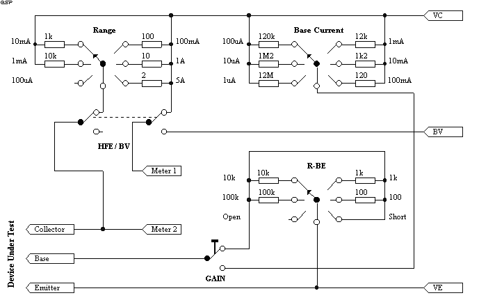

Hi djQUAN !
I use this "Full Featured Transistor Tester" ESP Project 31.
it's nice and easy to construct !
In my version on a Testboard,
i can use Ib: 1uA, 10uA and 100uA and
Ic: 1mA, 10mA, 100mA.
Ib: base current
Ic: collector current
all the best from germany
-uwe
Ib: base current
-uwe
