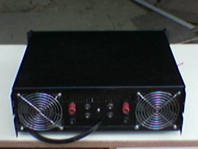

So Mr Rahul
It is True That our Mustang Amp has 64 Mosfets at its output stage.
we dont use passive cooling instead of it we use twin cooling fans for active cooling.
Ans at last Holton's amp is exhibiting cross conduction even at low frequencies and also There is a chance of damaging of output devices during abrupt turn on due to imbalance in driver stage configuration.
Take alook at rear panel of our earlier model.
With Regards
Workhorse Technologies Team
