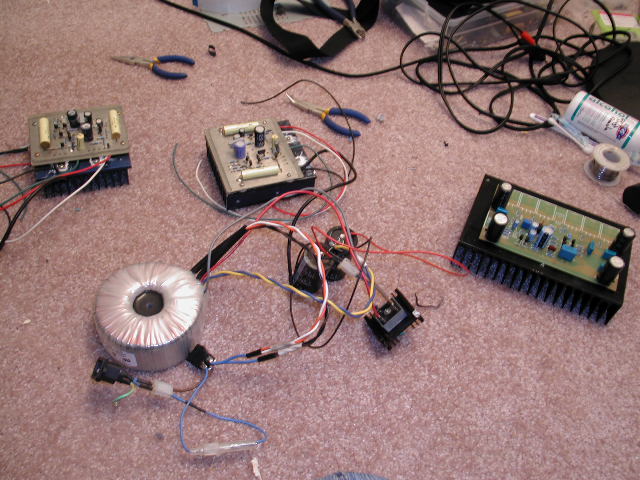

I'm in the middle of a N-channel project (4 x), (Aussieamps)
-and need to source the degenerative resistors (0R33-5W).
Can anybody please suggest the quality for these,
soundvise, and the source (link please).
Should I use metal-film / wire-wound / in alu-housing / ???
Would the different resistor-types have a "sonic signature"?

Arne,
IME multiple parallel film resistors can sound nicer than single ceramic wirewounds.
Multiple 1W carbon emitter resistors gave a nice result to my ear.
Eric.
Eric.

i bought mine from www.digikey.ca and i oo have built this amp..
still wating for the resisters should have them wendsday then the ossilating will be gone WOOO HOOOO
j"
j"

If you use wirewounds, make sure they are the non-inductive type. Some of those metal clad ones come in both types, i.e. you can specify which one you want. Some amplifiers will oscillate if the source resistor is inductive, the resistance wire inside them is wound up like a coil.

Have you tried searching on this Forum. I have posted quite a bit about this amplifier. I have working modules. I used 3 x 1 Ohm 1 watt resistors for the output stage. This amp simply does NOT oscillate. Perhaps, it is because I used my own PCB design. I repeat, search the Forum.
Previously I had posted a photograph of a fully populated board.
The sound quality of this amp is excellent. I am investigating placing a buffer stage before the driver mosfet for even better resolution.

MIne will be done in a few days just wating for my .33 ohm resisters to be here i need them for teh ossilating problem that i was haveing.. ill post pics in a few days as it will be driveing my 15" sub : O )
Hi All
Whether you use metal film, wire wound or Carbon film, makes no difference to the objective performance of the n-channel amplifier.
It will not oscillate.
However Carbon film or Metal film if available could help the subjective performance.
Nice to see they is quite a few working n-channels out there.
I for one use mine everyday. I love the sound of Asymmetrical o/p stages.
If you have any questions, you can get me via this forum.
Cheers
Anthony Holton
Aussieamplifiers
Cheers
Anthony Holton
Aussieamplifiers
