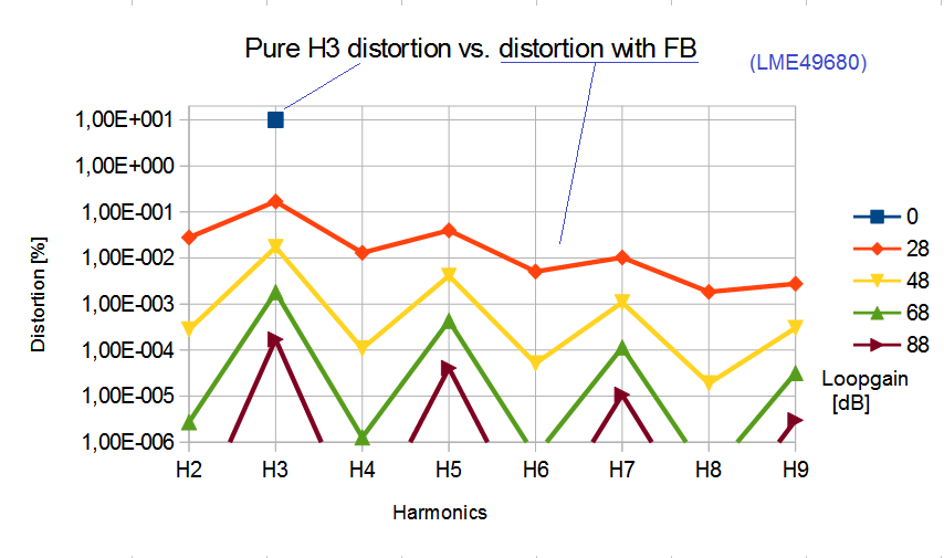

I have plotted distortion profiles of LME49860 for various gains/loopgains. Input signal is distorted 1kHz sine that contains only H3 (3rd) harmonic component except for the base frequency 1kHz. LME48960 is used with gains 0dB, 20dB, 40dB and 60dB. Corresponding loopgains (at 3kHz) are 88dB, 68dB, 48dB and 28dB. We can see how with decreasing loopgain distortion raises, and also that even order harmonics are higher (relative to odd orders) as loopgain is decreasing. This demonstrates that we need as much feedback as possible, of course must stay in stable safe zone. And it also demonstrates that in all cases feedback creates the new distortion harmonics that were not present in the original signal, though they are low in amplitude. Output signal was always set to 2Vp.

In terms of basic theory and in terms of trying to make things intuitive without a lot of math, there is an old fashioned approach. Its more or less in line with what Earl Geddes has said, to the effect that we should be looking at transfer functions.
Regarding the changes in curvature that transfer functions go through as feed back is increased, the harmonic content changes can be analyzed graphically.
The two files below explain a couple approaches. Think the correlation method is more intuitive, myself. A few examples make it pretty clear why harmonics can increase before decreasing as feedback is increased, since the effect of feedback is to straighten out the transfer function.
Several other references on graphical methods are available if there is any interest.

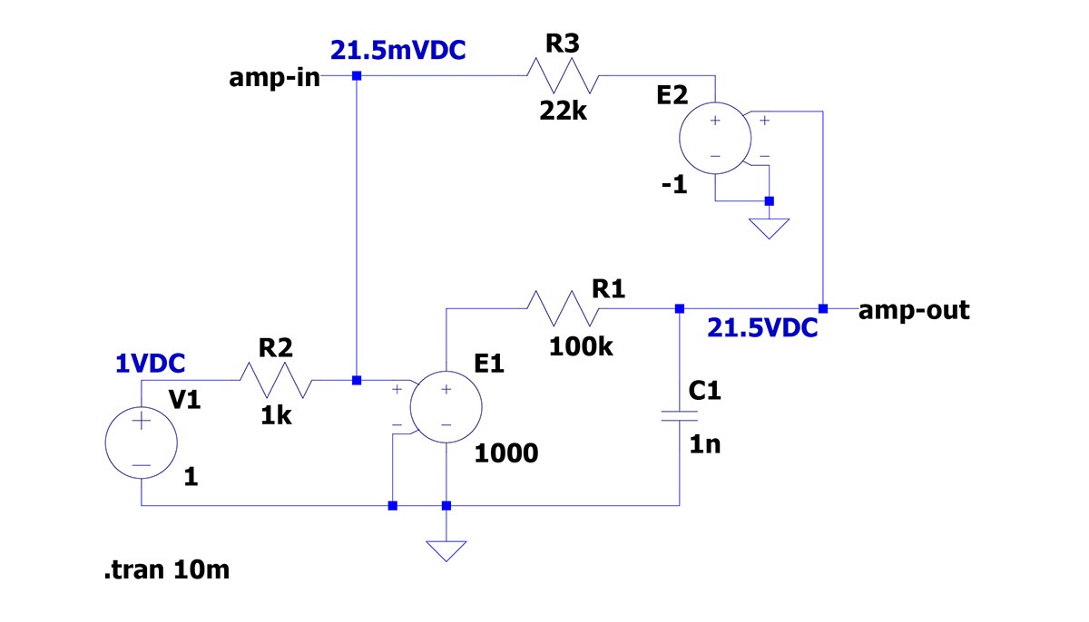

Maybe some addition to the first feedback piece that seems underexposed, and may give better understanding.
With an open loop gain of just 1000, you see that - obviously - the amp input signal is 1/1000 of Vout.
In the attached picture, it's 21.5V Vout and 21.5mV Vin.
Since that amp is still affecting the output, there must be still some distortion appearing at Vout; feedback hasn't totally eliminated the distortion.
And it cannot, unless, in the ideal case (which we cannot achieve), if the amp had an open loop gain of infinity, the input voltage would be zero.
In that case, the amps' amplification would no longer be relevant and distortion would really be zero.
But in our non-ideal world, all we can do is work towards the highest open loop gain we can get away with, to benefit maximally from available feedback.
And in turn, that is important if we strive for HiFi in the original sense - an amp that faithfully reproduces what we throw at it, adding nothing, taking nothing away.
