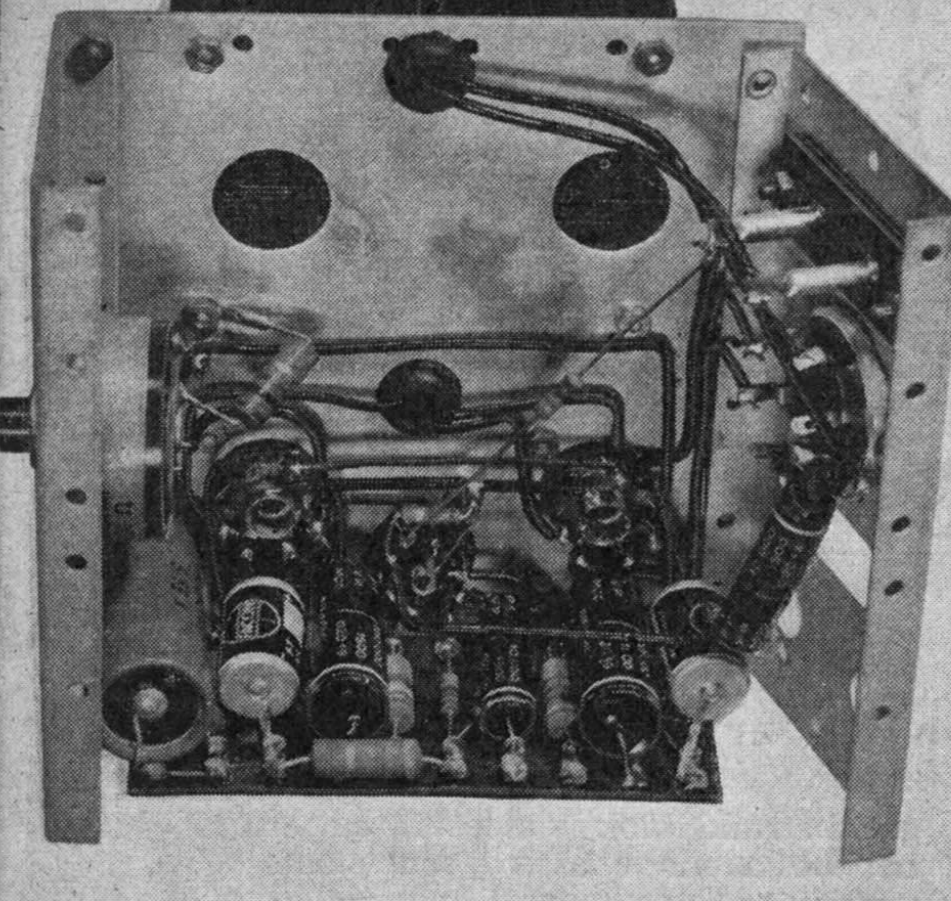

I was browsing just some old magazines the other day.
In the 50s-60s, every self respected high quality (tube) amplifier had feedback.
For some reason that all of a sudden became out of fashion when it comes down to tube amplifiers.
Also for transistor amplifiers. I have the impression it all started with a mistake in a 1966 article about transistor amplifiers, see http://linearaudio.net/sites/linearaudio.net/files/volume1ltemvdg.pdf for details.
In the 50-ies and 60-ies, tube amps were designed by people who understood the facts of engineering.
If you really don't understand feedback in a technical way, it's an easy step to leave it out of your design and claim it's an improvement.
Especially with perception being the way it is.

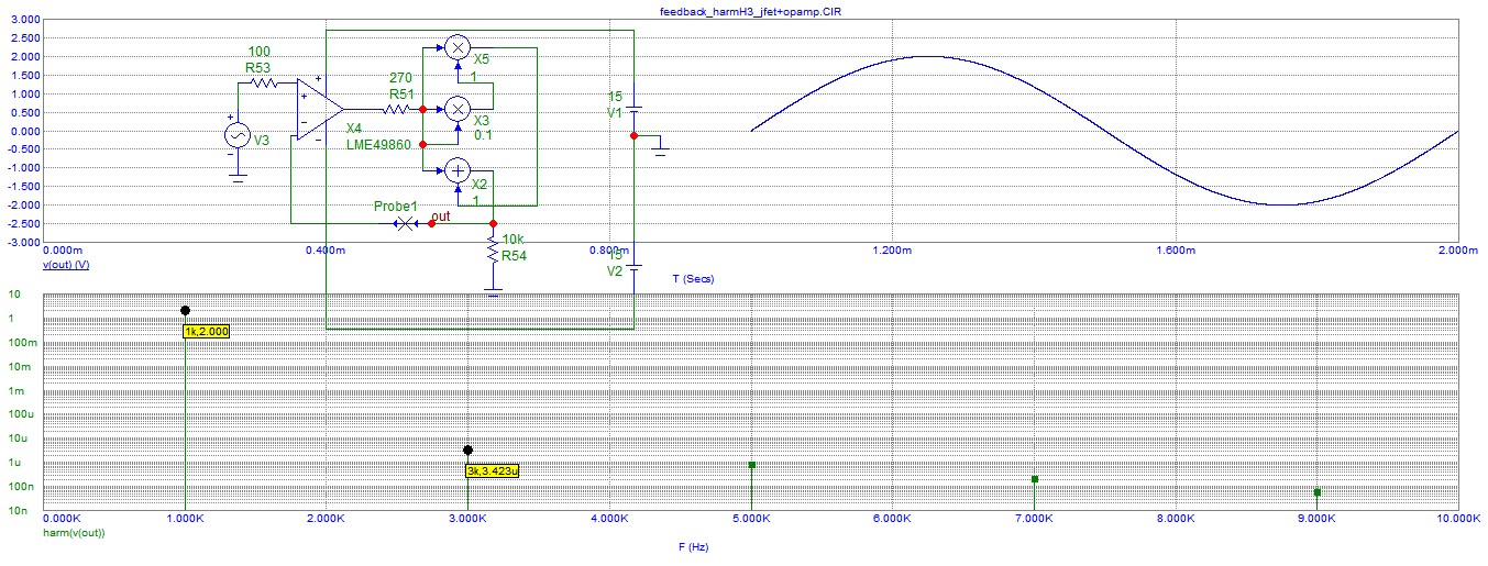

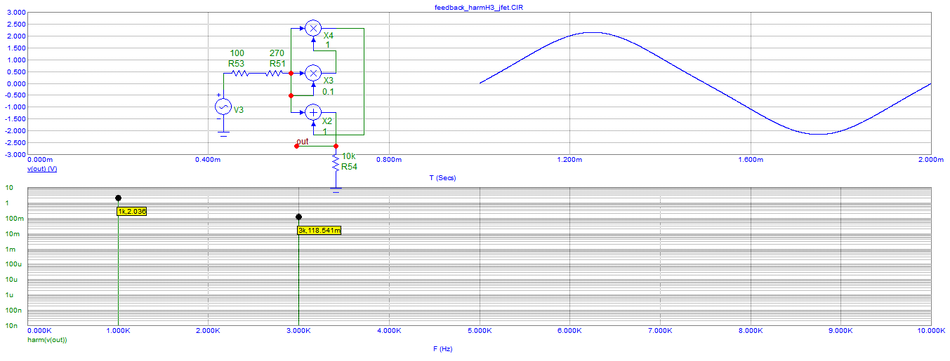

According to Feldtkeller's analysis from 1936, that's mainly an issue at low levels of feedback. Mind you, he was looking at third-order distortion.
Interestingly enough, with pure H3, FB distortion reduction is much more effective than for pure H2 (post #27) and creates only new odd order harmonics very very low in amplitude, in fact completely negligible. It is a demonstration of feedback capabilities.
Pure H3 nonlineraity
H3 nonlinearity corrected by feedback with LME49860
Maybe it's time to use modern SW means and to re-analyze FB action for various loopgains and nonlinearities.
BTW, the distortion suppression is defined by open loop gain (at the distortion component frequency) of the opamp used. In case of gain 1 (here) the open loop gain equals to loop gain.

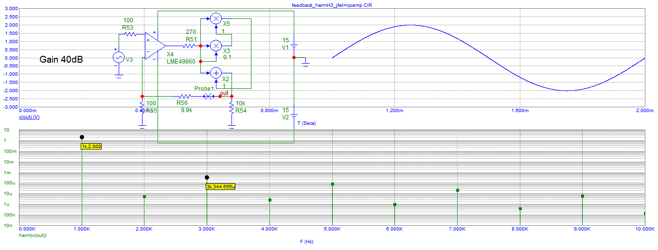

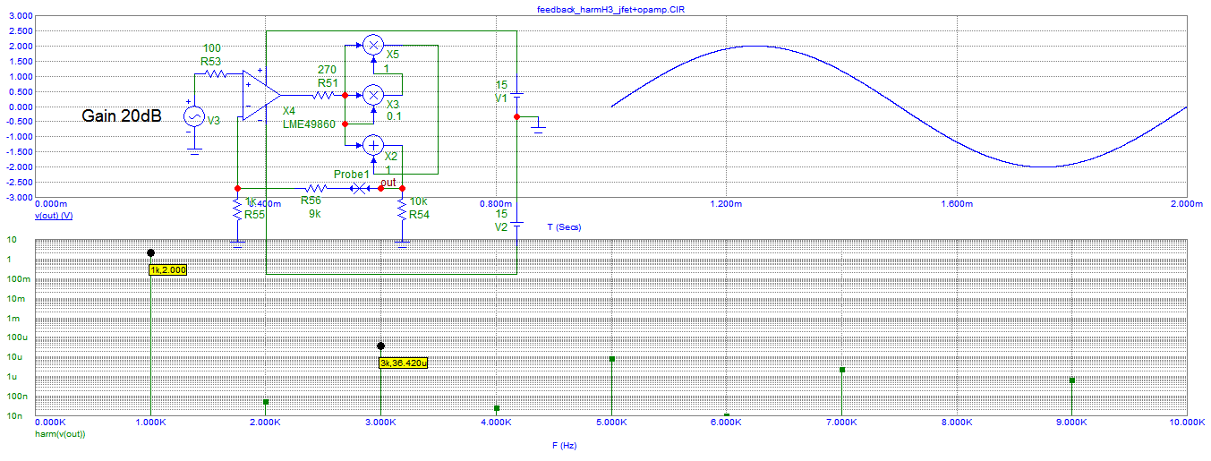

Examples of H3 suppression (same nonlinearity as in post #68) with LME49860 and gain +20dB and +40dB. Again, H3 is suppressed exactly of loopgain at 3kHz, however some new harmonics are created, now both even and odd.
Gain 20dB
Gain 40dB
LME 49860 open loop characteristics

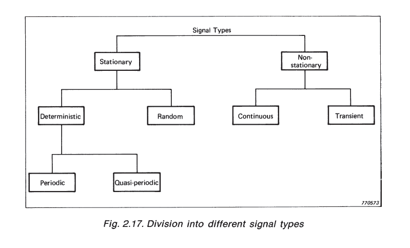

Yes, in much the same way that vanity THD tests on Spice simulators are often done with a 1kHz sine wave.- in case of stationary periodic signal.
More down-to-earth concerns are often avoided or glossed.
For instance, it is rare to see simulated ripples being injected into the power rails. To get started with amplifiers and such, it is far simpler to use a generic laptop supply than play around with transformers and dual supplies, fairly straightforward as they may be. So testing a circuit's immunity to PSU ripple is quite an important measure of how good it is likely to be.
