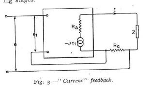

Could you please read the section containing Fig. 3 in https://linearaudio.net/sites/linearaudio.net/files/Farren feedback1938.pdf ?

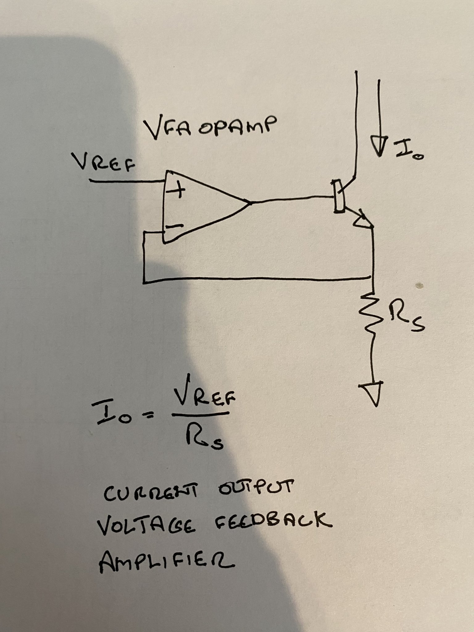

That is a current output amplifier with voltage feedback Marcel. You can see that because the input ports on the left-hand side of the black box amplifier are designated e1 and the ground to signal input e. Unfortunately, the author used the wrong term to describe his circuit, despite his very detailed and thorough math and analysis. The circuit in Figure 3 is exactly how I would depict a 4-20mA instrumentation loop amplifier if I was explaining it to someone. By comparing the voltage sensed across the resistor to a reference voltage, you get a controlled current output, so for Fig. 3, assuming infinite open loop gain, e = e1 = I.Rc so e1/Rc = I. The left-hand side of the Rc is the feedback voltage.

That is a current output amplifier with voltage feedback Marcel. (...) Unfortunately, the author used the wrong term to describe his circuit, despite his very detailed and thorough math and analysis.

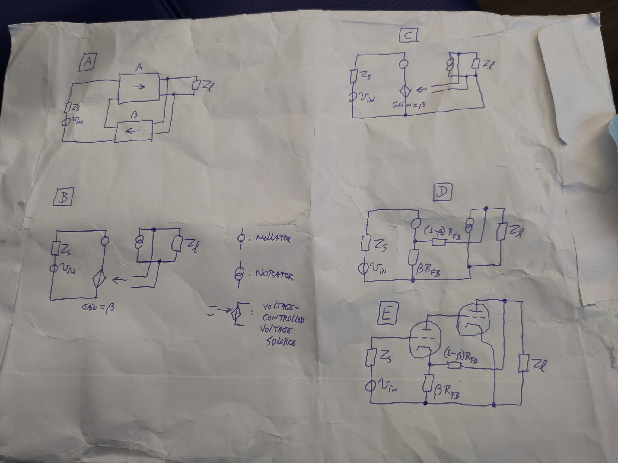

I'm not sure if this will help or just worsen the confusion, but let's try.
Schematic A is a copy of what you have shown.
Schematic B is an implementation with ideal components. The forward path has been replaced with a nullator (network element that has zero voltage across it and zero current through it, usually used as an ideal model for an input stage of a feedback amplifier) and a norator (network element that can conduct any current and have any voltage across it, usually used as an ideal model for an output stage of a feedback amplifier). The feedback has been implemented with a voltage-controlled voltage source with voltage gain beta. It is clear that the signal source, controlled voltage source and nullator are all in series, while the load, sense points for the controlled source and norator are all in parallel. Hence, series feedback at the input, parallel or shunt feedback at the output.
Schematic C is the same with an extra wire between the input and output side. In this schematic, the extra wire doesn't do any harm, as it conducts no current.
With the extra wire in place, the controlled source can just as well be replaced with a voltage divider, this leads to schematic D.
An attempt to replace the nullator and norator with something more practical leads to schematic E. It is a signal schematic, everything that is required for biasing is left out.
All in all, I think it gets messy when you replace the ideal parts with more practical circuits. How to connect a controlled source in series with something or its controlling terminals in parallel with something is clear, but what does series or parallel even mean for a voltage divider with its three terminals? The answer becomes clear (to me anyway) when you see the voltage divider as a practical implementation of a voltage-controlled voltage source with a gain beta < 1.

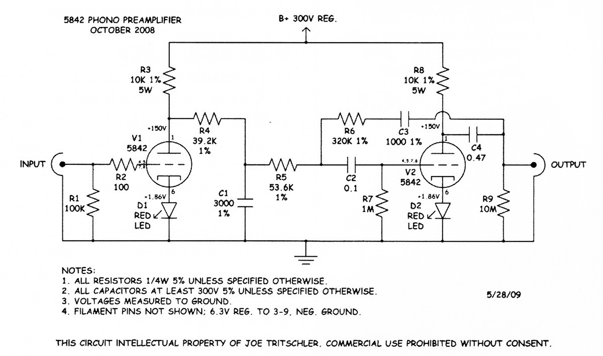

In the meantime, I'm trying to sort out a circuit I have on the bench and to get deeper understanding of the feedback network in the circuit posted in #530 , any answers you can give would help on both fronts (ie. understanding his circuit and understanding the terminology that others use for feedback. )

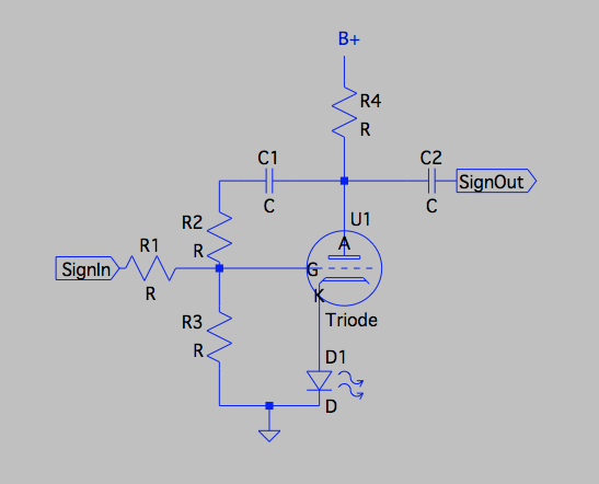

Tritschler calls the 2nd stage feedback network of his RIAA circuit (attached in post #530 ) "Shunt-Shunt" so shunt derived, shunt applied , which simplified would look like this.
It's easy enough to see that the feedback network is a simple resistive divider in parallel with the triode and shunting signal around it while allowing a portion of the signal to be fed back into the input. But why the dual hyphenated designation Shunt (derived) - Shunt (applied) and not just simply parallel?
To understand this better, the questions below:
What changes if it becomes Series - Shunt ?
What changes if it becomes Shunt - Series ?
What changes if it becomes Series - Series ?
BTW, I'm not ignoring Bonsai's explanation in post #527, just asking the question this way for view from a different angle.

R6 and C3 are the shunt-shunt feedback network. They approximate a voltage-controlled current source with frequency-dependent transfer. (When you try to make a shunt-shunt feedback with some other type of controlled source, you end up shorting the signal - I have to come back to that later.) Due to the voltage to current conversion in the feedback, the whole stage is a current to voltage converter.
R4, C1 and R5 are a π filter between the first and the second stages.
V2 is the implementation of the nullator and norator. A single triode can do the job because the nullator and norator happen to have a common node, they are both connected with one side to (AC) ground. A triode also has such a common terminal, as its cathode is both an input and an output.
C2, R7, D2, C4, R9 and R8 are for biasing.

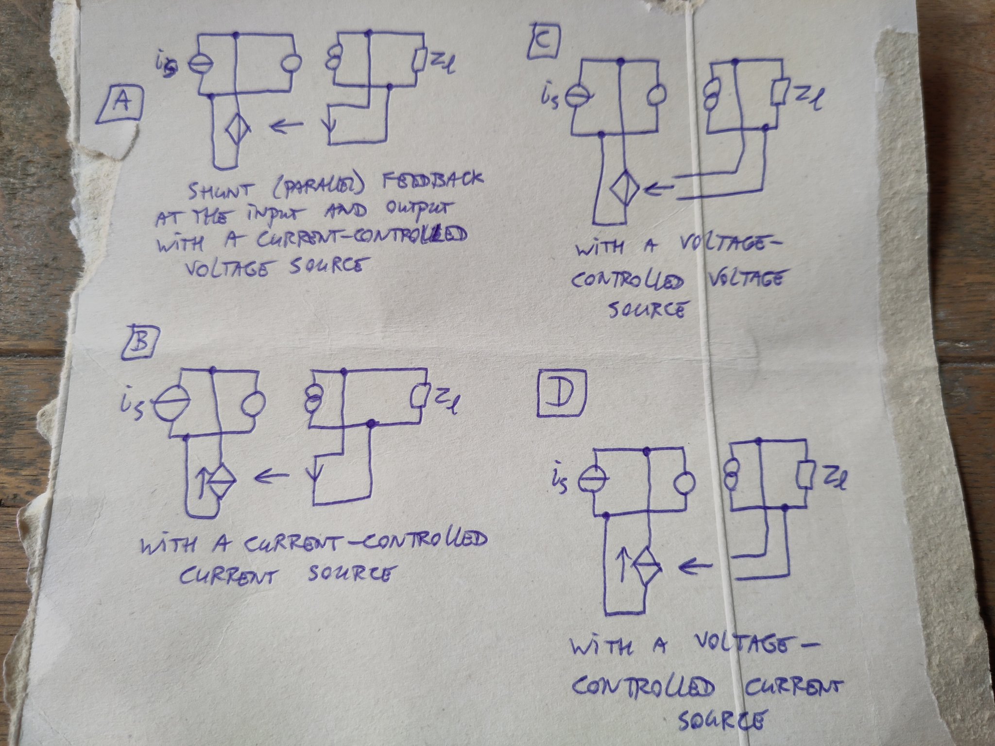

Four attempts to make an amplifier with parallel feedback at the input and output using a nullator, a norator and a controlled source.
A and B can't work because they short the output.
C doesn't directly short the output, but as the voltage across the nullator is zero by definition, so is the controlled voltage source's output voltage. Assuming a linear controlled source, the same holds for its input voltage, which is also the output voltage of the amplifier. That is, C doesn't work either.
D works just fine. The output voltage is adjusted such that the current is flows into the voltage-controlled current source, which means that the transfer from is to the output voltage is the reciprocal of the transfer of the controlled source.
Alright, you've given me a year's worth of study. Seriously ! Reading definitions of Nullors shows me I'm seriously out of my depth as far as understanding the practicable side of these concepts. Nevertheless . . . . .
So , to understand the voltage controlled current source designation could I say that any circuit over which a change in voltage results in change of current fits that name?R6 and C3 are the shunt-shunt feedback network. They approximate a voltage-controlled current source with frequency-dependent transfer.
One question about that specific feedback circuit. It is billed as bass boost , but from what I can tell it actually attenuates the higher frequencies, not boost the lower ones. Am I missing something?They approximate a voltage-controlled current source with frequency-dependent transfer.
