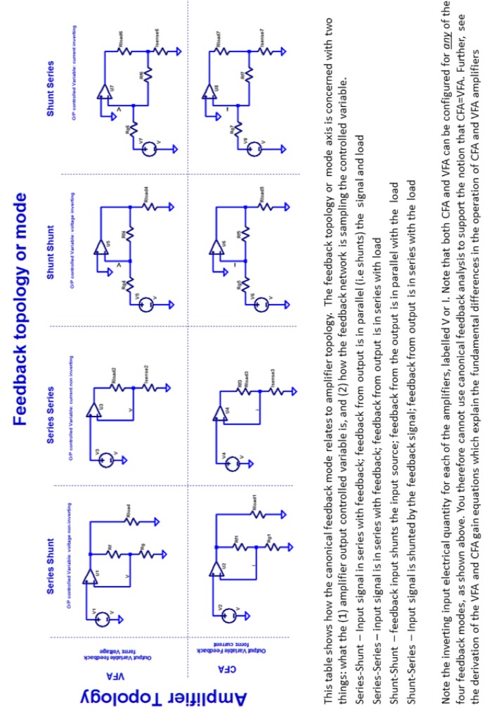

Here are the canonical feedback forms:-
I also find all this ‘shunt-series’, series-series’ stuff quite confusing and completely unnecessary. In the context of amplifier electronics it’s much easier to think of it like this:-
Voltage output with voltage feedback (classic VFA)
Voltage output with current feedback (classic CFA)
Current output with voltage feedback
Current output with current feedback
Indeed, for very complex feedback systems as in aerodynamics or missile guidance, you will need the formal control definitions for the reasons Jan states but for the simple stuff we do in audio, probably not.
YMMV.

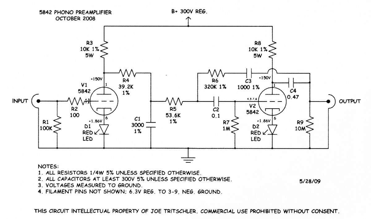

If the input signal goes to the noninverting input of the amp, and the feedback resistor goes to the inverting amp input, then the two signals look as it they are in parallel and it is shunt feedback.
In Tritschler's article he calls the second stage feedback network shunt-shunt , yet both input and feedback go to the inverting input.
Also:
Referencing the image Bonsai posted , If I see the triangular amp symbol as a triode , then the + pin would be cathode, - pin would be grid , and output would be (in most cases) equivalent to the plate. Yes?

I think Bonsai's overview nailed it. But if you have another opinion, surely you can find someone on the net that supports you! ;-)
No need for the sarcasm Jan. I know it's your pet peeve but you might have taken the trouble to notice that I don't know enough about this subject to have an opinion.
The only thing I'm looking for is understanding that allows me enough clarity to judge for myself. When EE's appear to contradict each other it becomes important.
YMMV.

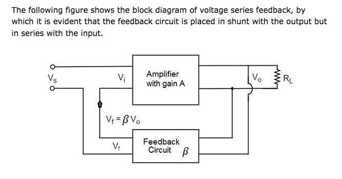

I wrote this in answer to Rayma well before you posted Marcel but the connection dropped and had to wait. Perhaps it's more of the same sort of problem. Nevertheless, I'll post it because I'm fairly confident there are others who understand it as little as I do.
Maybe this is a good time to ask about one of the things that I can't seem to get right .
Attached from the above linked tutorial page is the often used Voltage-Series graphic along with its explanation stating that the the series connection with the input is evident. To me it's not.
What I see is the source common routed into the feedback network and apparently in series with that at the other end of the feedback network the connection goes to amplifier output positive. Ok, that looks like it could be negative feedback , or rather positive feedback to the source negative.
Then there is the other loop taken from the amplifier output negative to the amplifier input negative, thus being a loop that is not connected to the source .
In other words, what I see in this diagram is no shared common between input and output. The two rectangular blocks being black boxes.
OF COURSE I know (or assume) that interpretation is not what was intended. What I'm looking for is an explanation that follows beginner's rules (ie. if it's in series , show it like it is etc) and while I do appreciate Bonsai's friendly statement that the hyphenated terms aren't really necessary for this level of audio, the problem is that not knowing what they mean makes it impossible to learn from what others have written - being that almost all tutorials and papers use these terms, though apparently often incorrectly or at least in contradiction to what a what another one does.
(And my contention from the start is that there are more than likely others who have the same sort of trouble with as I do. It's not rocket science. : )

Reply to @Hearinspace 's post #538:
Maybe it would help to regard the boxes as two-ports. Two-ports have an input and an output port that can influence each other, but are independent of the common-mode voltage between them. An ordinary resistive feedback network is then a rough approximation of an ideal two-port feedback network.
I will draw some things and get back to you. It may take some time.

It’s a great pity people get so upset about it. I respectfully ask you to read Professor Sergio Franco’s rebuttal to those claiming either CFA’s don’t exist, or that the concept of current feedback as used in the context of a voltage output amplifier is misplaced:-
https://www.edn.com/in-defense-of-the-current-feedback-amplifier/
And further
https://hifisonix.com/technical/current-and-voltage-feedback-amplifiers/
