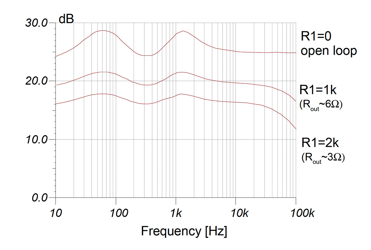

The only thing I haven't quite picked up on properly from your article and the cited work from Hegglun surrounds the graph attached along with its accompanying caption and one statement from your article.
First, I want to ensure that I understand the chart (I need to get off my rump and buy the full USB stick of articles, so I can read them all in full form).
You stated "Ian Hegglun [1] did some work on the effects of amplifier output impedance (and thus DF), which shows that the lower the DF, the more the speaker resonances are suppressed (Figure 2; disregard absolute level differences)."
Is it correct to look at the relative linearity / smoothness of the "peaks" in the chart as the speaker resonances being suppressed?
R1 would have the lowest amount of suppression?
R3 would have the highest amount of suppression?
He doesn't show an estimated Rout for R1 (I'm sure those more skilled know what it is), but I'd assume from the chart, that the Rout for R1 is higher than that of R2.
So, in a very basic tabular presentation, would it be something like this?
If so, that seems to be the opposite of what you've said, but again... I am a complete novice trying to learn. My guess is that I'm missing something about how to interpret / how to discern the speaker resonance suppression from the graph.
Any insight would be greatly appreciated as always!

Another fantastic article! Thank you. I read it, and read it... along with comparing it to the notes I had written for myself around the linked publication below.
https://benchmarkmedia.com/blogs/application_notes/audio-myth-damping-factor-isnt-much-of-a-factor
Rout | DF | "Suppression" | |
R1 | Highest | Lowest | Worst |
R2 | Middle | Middle | Middle |
R3 | Lowest | Highest | Best |
Edited - One column of my table was missing.
