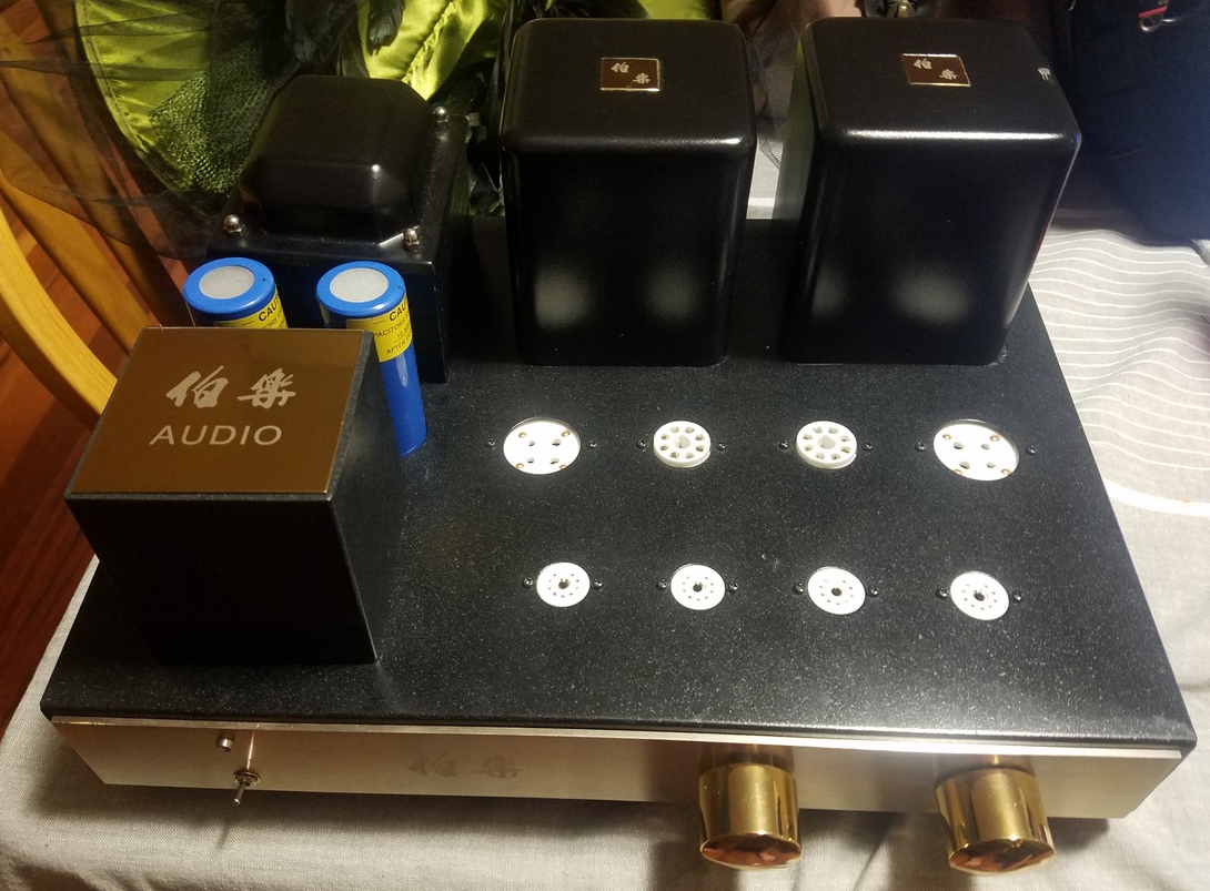

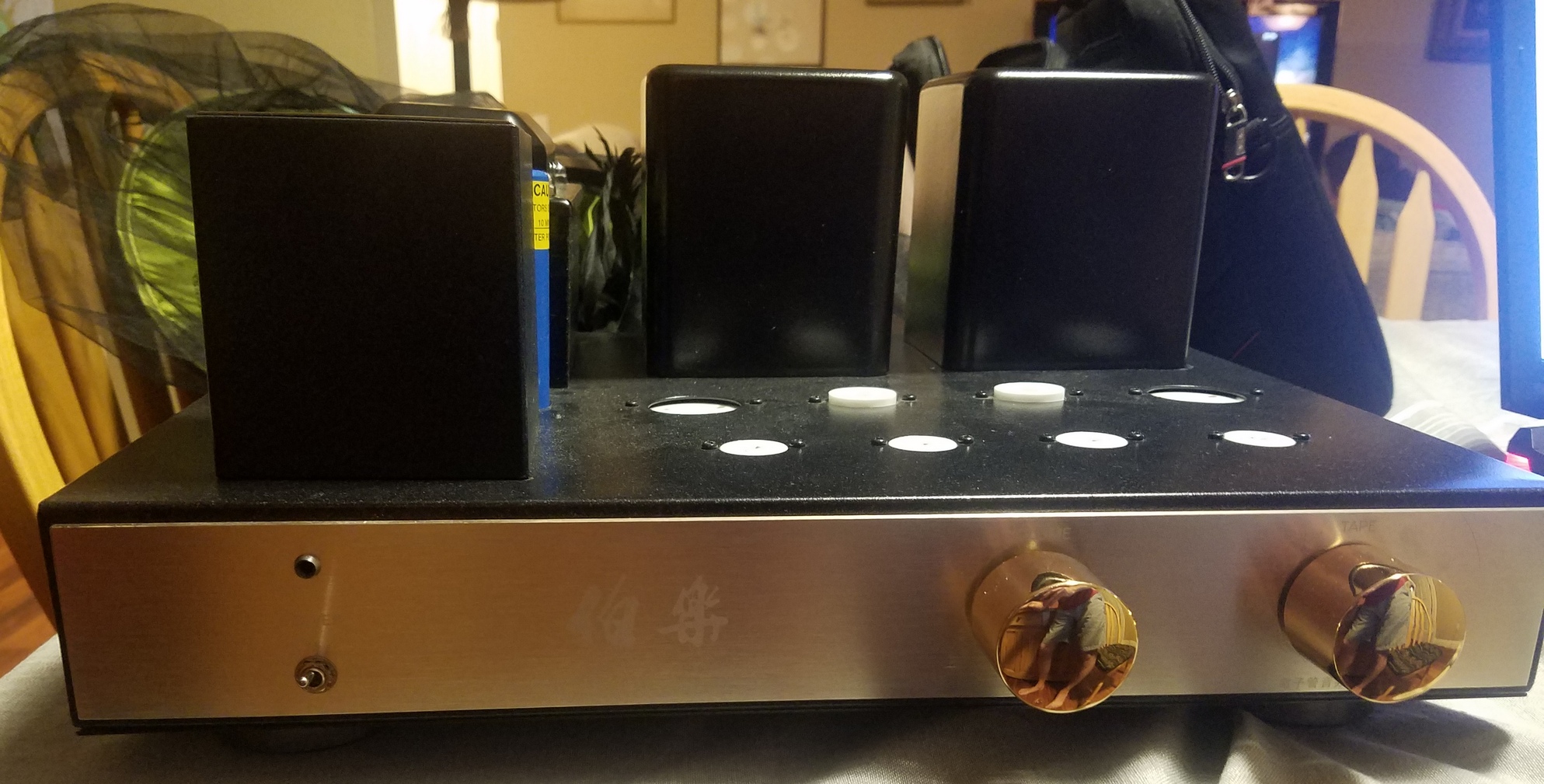

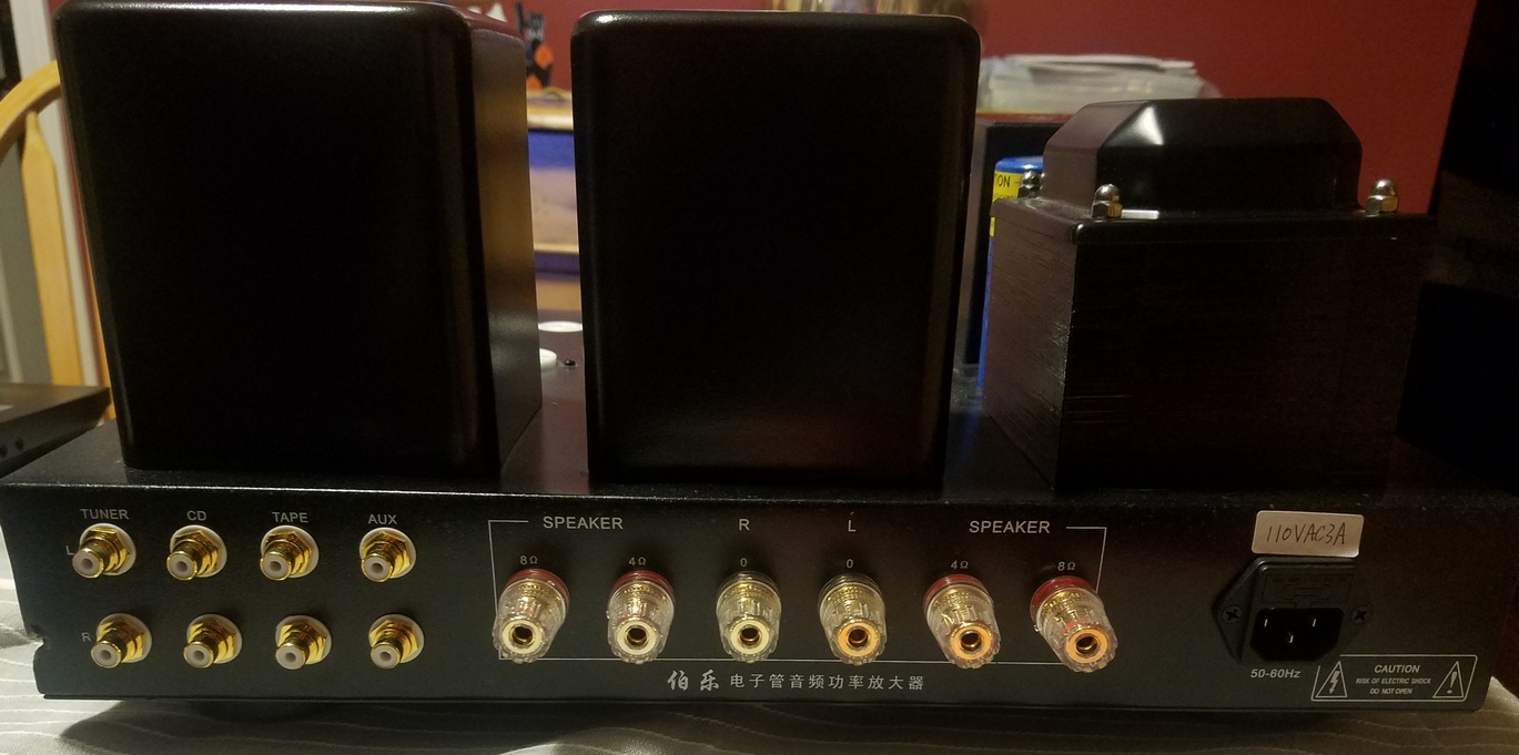

Hello,
First, thank you for taking the time to read my post. I have an amplifier which I purchased at an estate sale last week, and I know nothing about it. I would like to purchase tubes for it, and possibly find some literature, but it is 100% Chinese. If someone could assist me in identifying it, and let me know which tubes would work best, I would be very appreciative. Thank you in advance!

Yes, it's single ended triode (SET). That 5 V. marking on the power transformer is a clue which indicates a 300B based unit. The 300B is good for 8 WPC. You need mid 90s sensitive speakers for the 300B. In addition to the sensitivity requirement, a "flat" impedance curve is in order. The amp will not exhibit the gargantuan damping factor found in SS equipment.
It is indeed 300B.
This unit appears to be an old 'Bole Audio Shenzen' model A-10 from about mid 2000s.

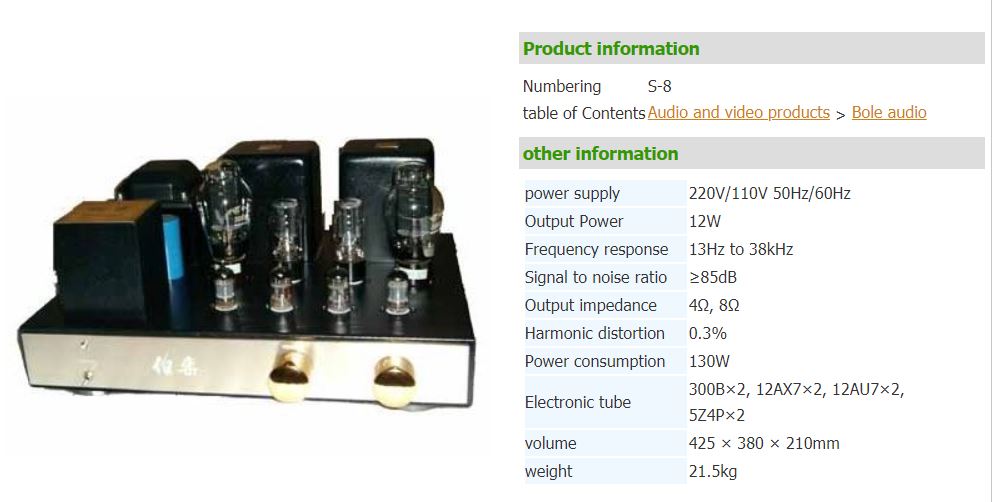

Here is a similar one:
BioRad A-10 300B ..with one pair of rectifier machine tube Philips 5U4G, one pair Brimar 12AU7, one pair of Sylvania 5751 (12AX7 ), a pair of Dawning 300B..
There is an article regarding this one / similar but it is in Chinese and also page 2 is behind a firewall. Here is the link anyhow: 晶莹、通透、圆滑、从容——伯乐A-10合并式胆机-【维普网】-仓储式在线作品出版平台-www.cqvip.com
I found another mention here: 300B - - [Tubebbs] |||||||||||
And another picture: 真空管音響 - 啟晟音響維修
This is the manufacturer's website but it doesn't have your particular one on it: ????--[!--????]
Lastly, I found a bit of commentary:
The Bole A--10 was introduced by Shenzhen Bole Audio.
The A-10 is the latest and improved model. 6E2, 6SL7 for preamplifier, 6L6 for 300B, and 300B-98 for the last stage, as well as the power transformer on the left, the two rectifiers 524P on the left, and the large filter capacitor, three huge transformer cover. Each group of power supplies is supplied independently. For the single-tube single-ended 300B amplifier, the A10 achieves the output power of 12W per channel which is approaching the limit.
*Caveat - any and all of this information may relate to a newer or older version of your amp. Search for yourself before splashin' the cash on tubes etc. Use '伯乐' to search and make use of google translate.
