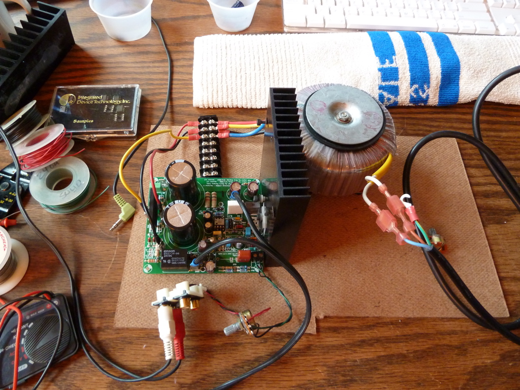

Got the caps and the LM3886's soldered in so it was finally time for some testing. Hooked up my (sacrificial) bench speaker, input from my laptop and let her rip. I had a 40W series light bulb on the powerline and it was also plugged into a kill-a-watt unit so I could check current. All the Magic Smoke stayed inside and I monitored and ran each one about 20 minutes. Things stayed nice and cool.
So now the time has come to figure out what I'm going to do about a case as well as how much heatsink I will need (esp. with a possible 4-ohm load).
Thanks to everyone for their help,
-b

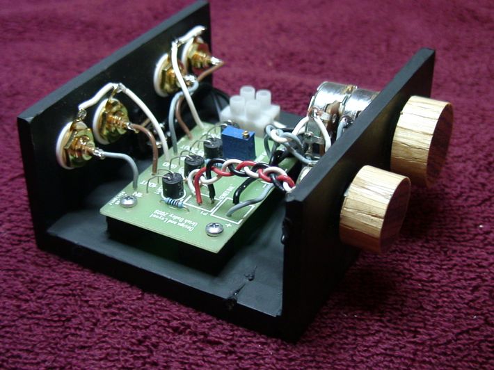

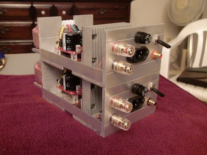

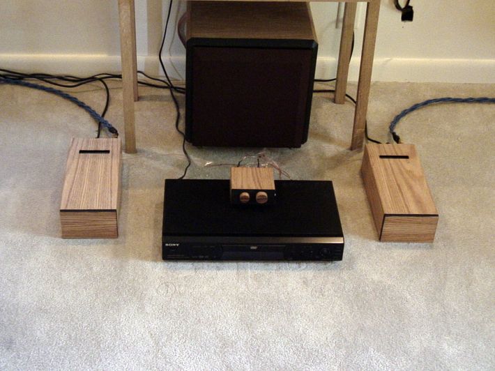

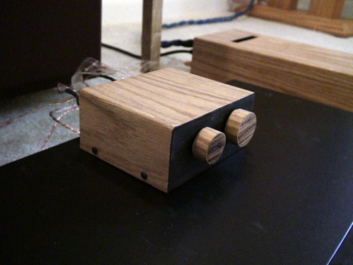

Congrats wrankin,

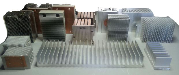

If you have two transformers and opt for a separate vol/pre box, dual mono-blocks are fun. Here's a couple pics of some I did and the Lightspeed passive
attenuator that controls volume and balance. A search for "heat sink" at eBay will give you many choices both designed for audio and PC CPU modable pieces.
Quite a collection. I really like the idea of the monoblocks, but if I take this project in the direction that it seems to be heading - multi-amps, active crossover (probably dsp) then limiting the total number of chassis may be A Good Thing.
On the other hand, it gives you more flexibility and is really not a whole lot more work.
Certainly food for thought.
Thanks,
-bill

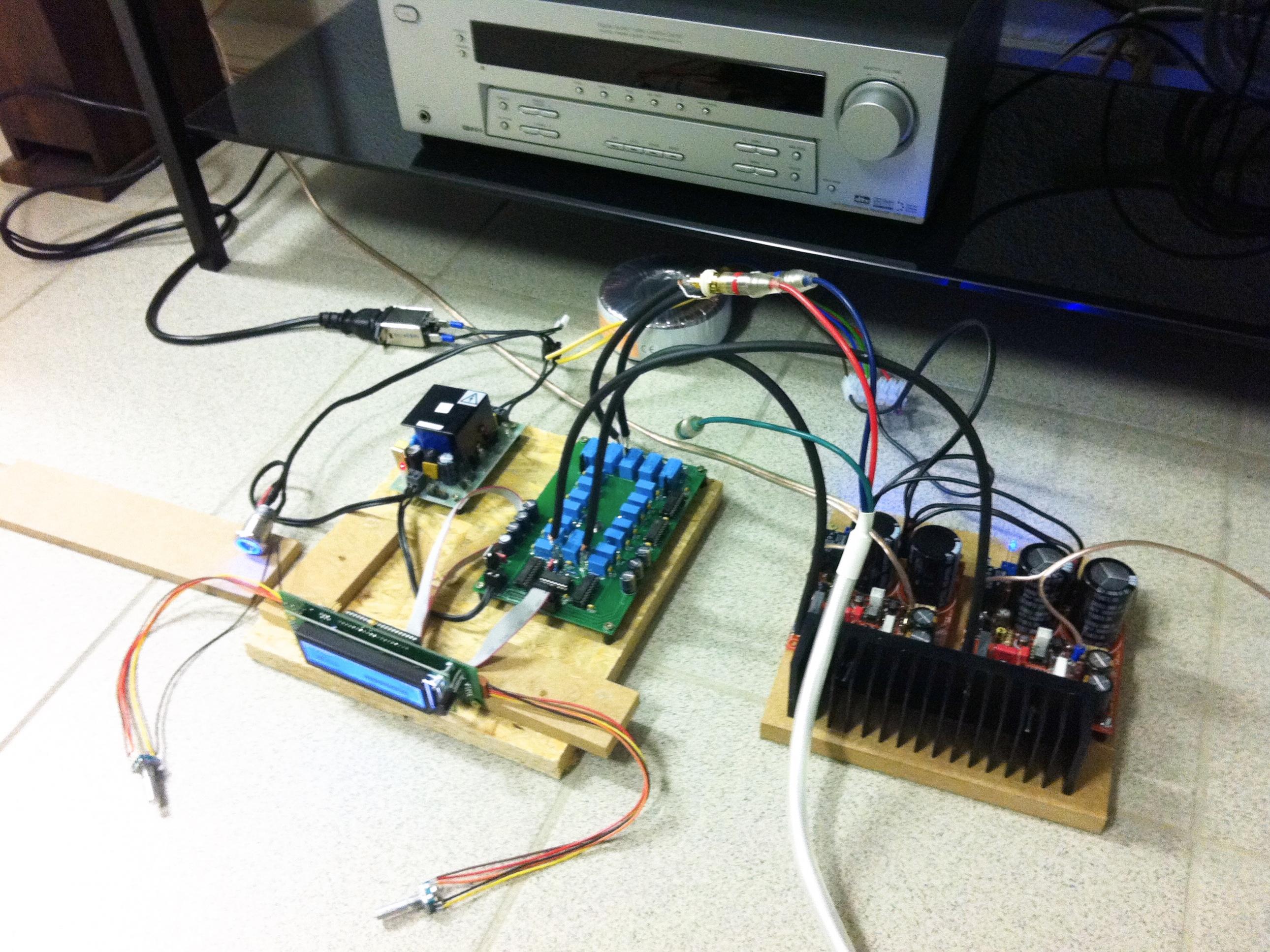

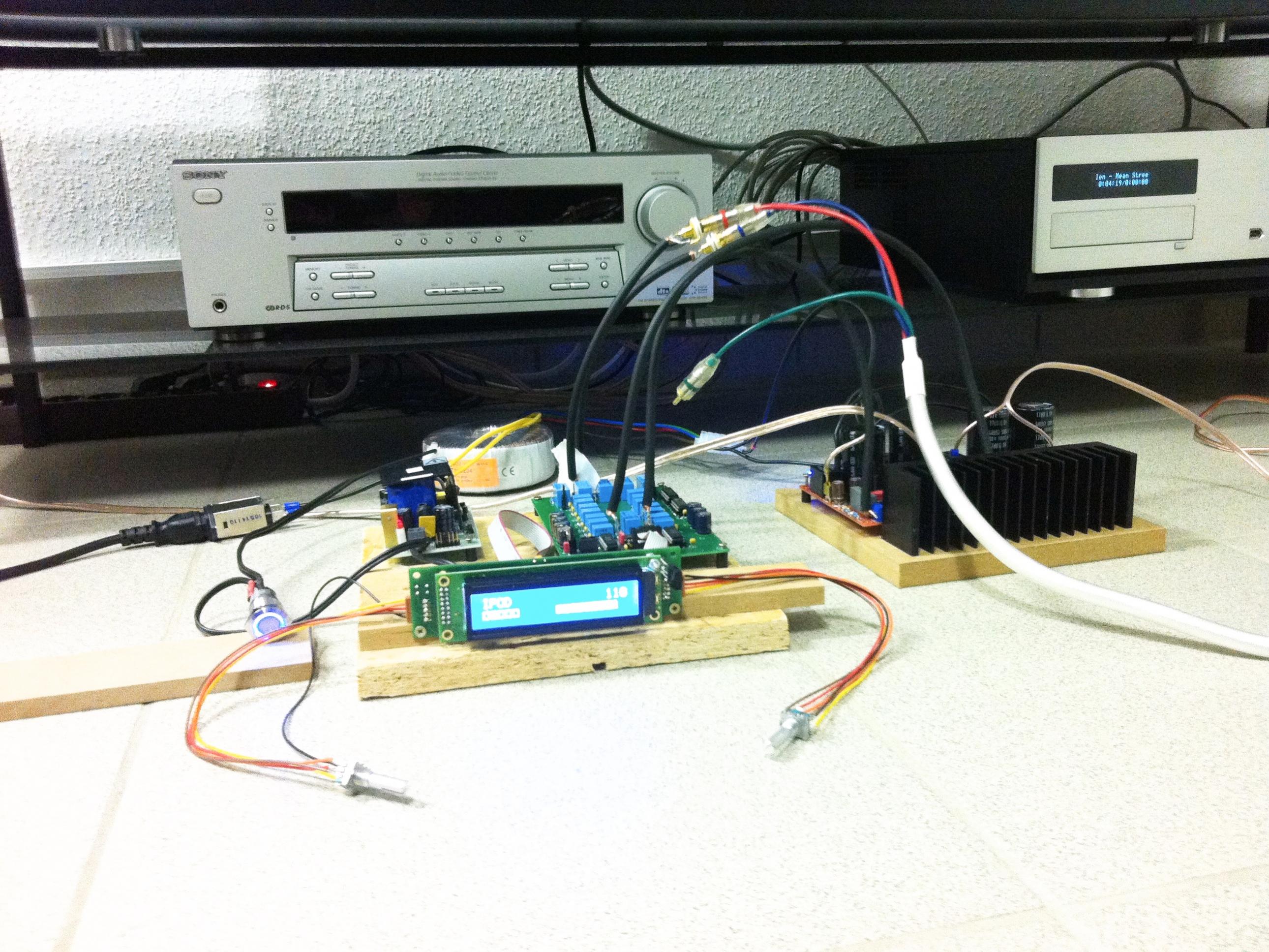

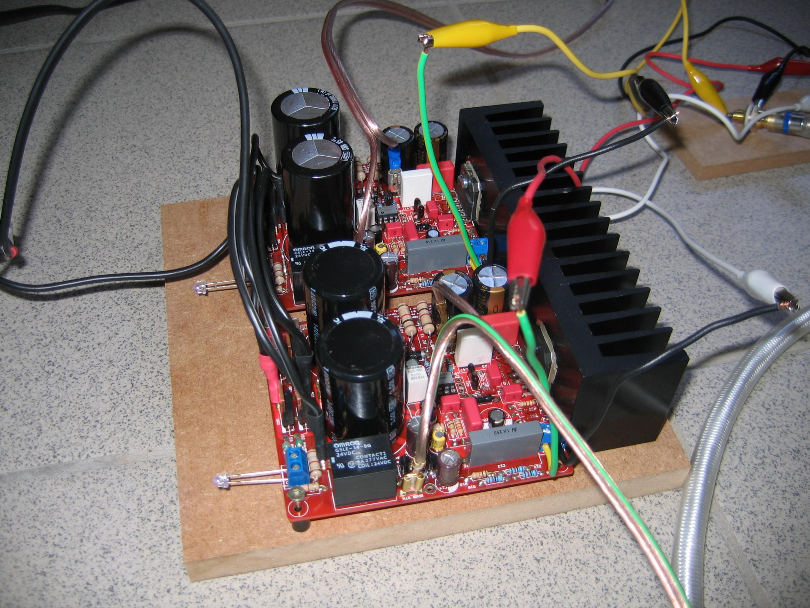

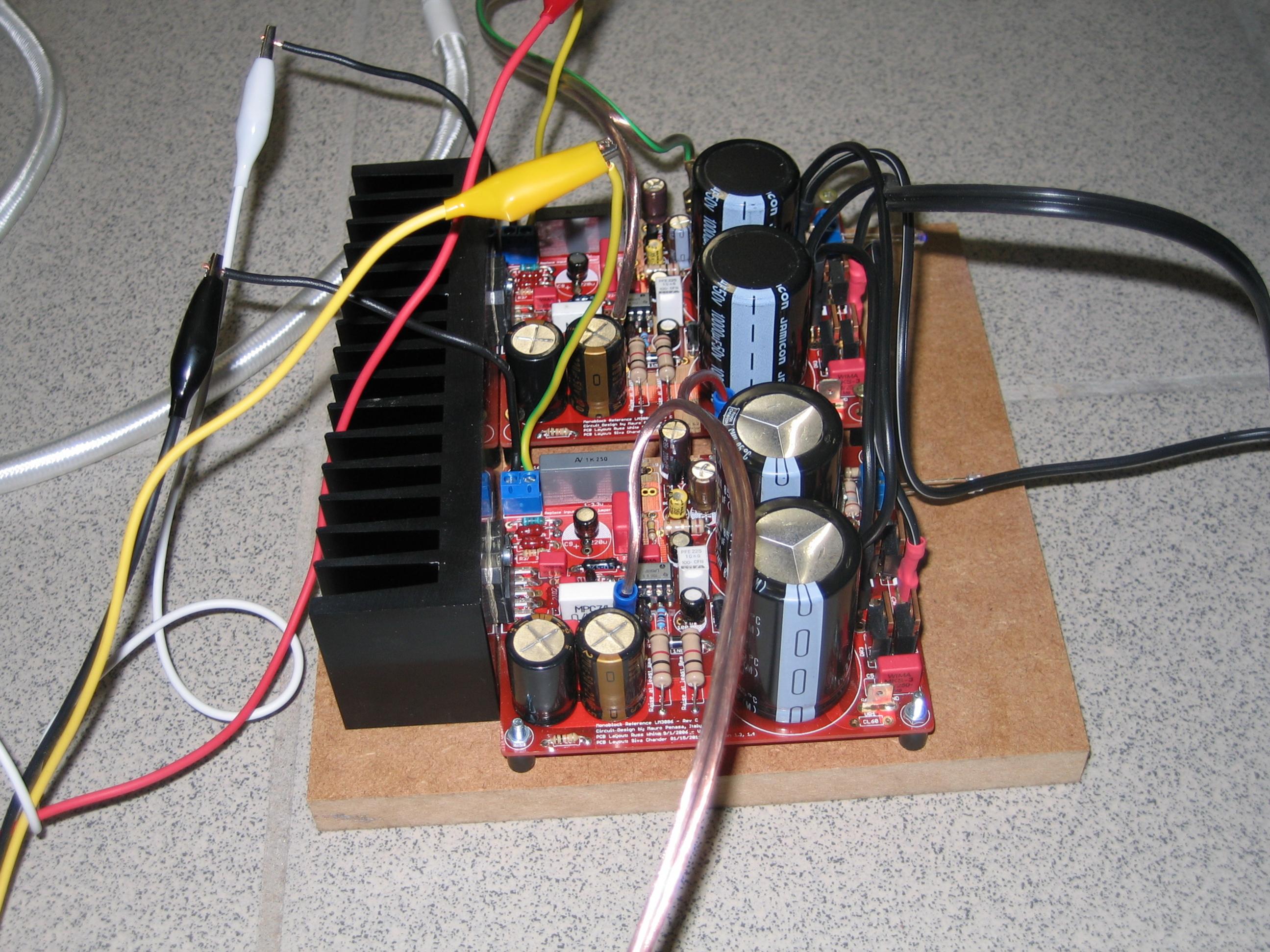

There are so many threads about the My_RefC that it was hard to decide where to post a "FINISHED..." :up: :up: :up: :wave2: 😀 (As you see I decided to post it here 😉 ).
I had it running in mono-configuration a couple of weeks ago and I finally assembled the second channel yesterday (I got the kit from Siva). The amps have a DC-current of 3.5-5 mV (left channel) and 4-7 mV (right channel) - my multimeter isn't so good so the result did some "changing" while measuring. After half an hour of "slightly louder than normal" 😉 playing the LM3886 measures at 39°C and I have around 45°C in the area of the zener-diodes (is this normal?).
I still have to improve the wiring but I was eager to test the amp with the volume control and input switcher. There is nearly no hum (if muted all there is is silence ! ). I got some hum when I completely disconnected the input wires but as I said this issue will be addressed the next few days with the wiring (I guess this is the main problem). I attached some pictures of the amp running.
To say something about the sound: My Needle RS show bass and punch they never showed with my old Sony Receiver (you might see it in the pictures). I'm very pleased with the performance of the amp. As it is the first amp I assembled on my own, I think I'll have a good glass of wine after lunch 🙂 .
Many thanks to Siva for the support and all of the people who invested so much time in this amp and posting their ideas/questions/answers in this forum. :worship:
Best regards
Sven

BK - Welcome aboard. The amps just keep getting better sounding with time. Let me suggest the Mundorf power caps and siva's LFO1 as items to consider if and when you want to bump it up a bit. Even a stock MyRef though, is indeed an amazing little amp.
Thanks a lot 😀 . But I enjoy listening at the moment and have some parallel projects running. So, I'm happy that it works. If I come to think about "pimping" the My_RefC I think there are so much ideas here in this forum that I'll have enough to read and to try out.
But first I want to enjoy the amp as it is and probably give it a nice enclosure. 🙂
Best regards
Sven
Goood job Sven! Hey, dont let that big film cap get in the way of best sound. Either remove or use something better.
Two spot-on suggestions.
I know you're enjoying your brand new My_Ref and with Siva's premium BOM you're starting from a very good point...
... but one thing, IMHO, you should consider to do before casing it.
Replace R13 with a Mundorf Zn 1.2uF 250V, you won't regret.
Or at least search on eBay a much chepear NOS Vishay MKC1862 1.5uF 63V, not as detailed and transparent as the Zn but delicious.
