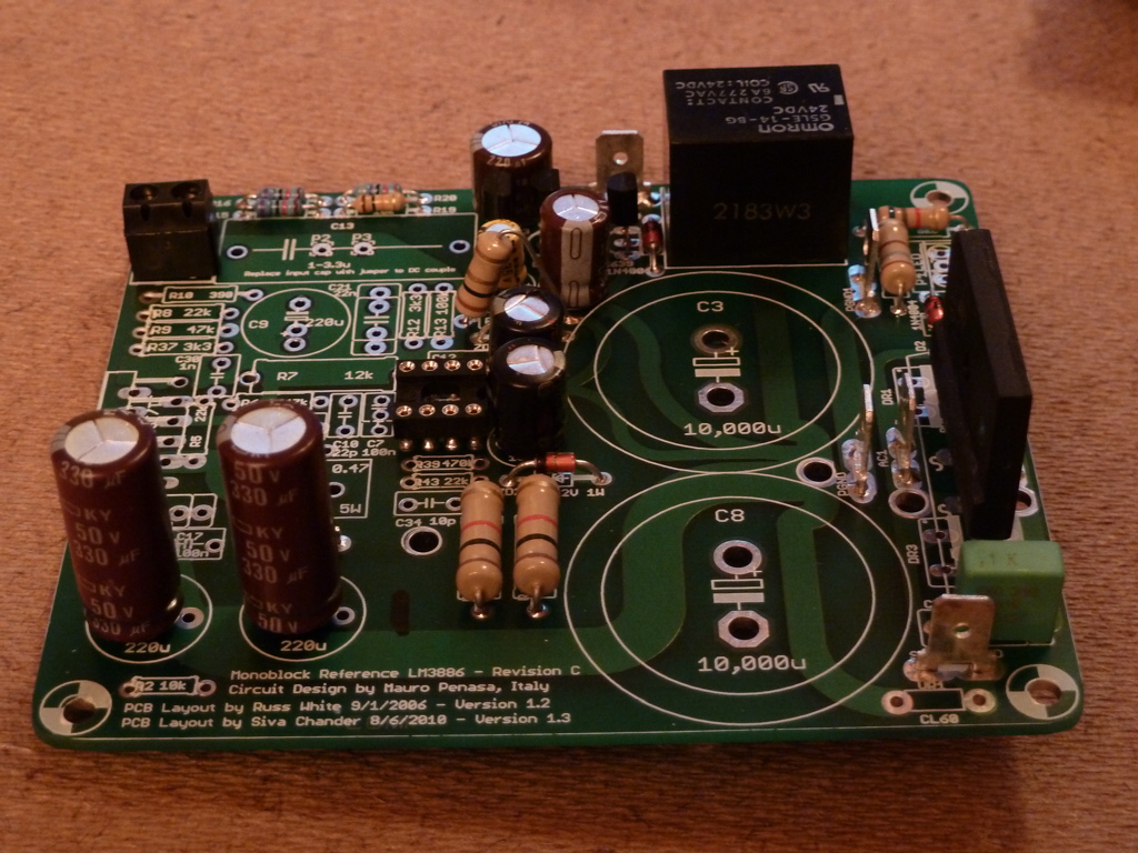

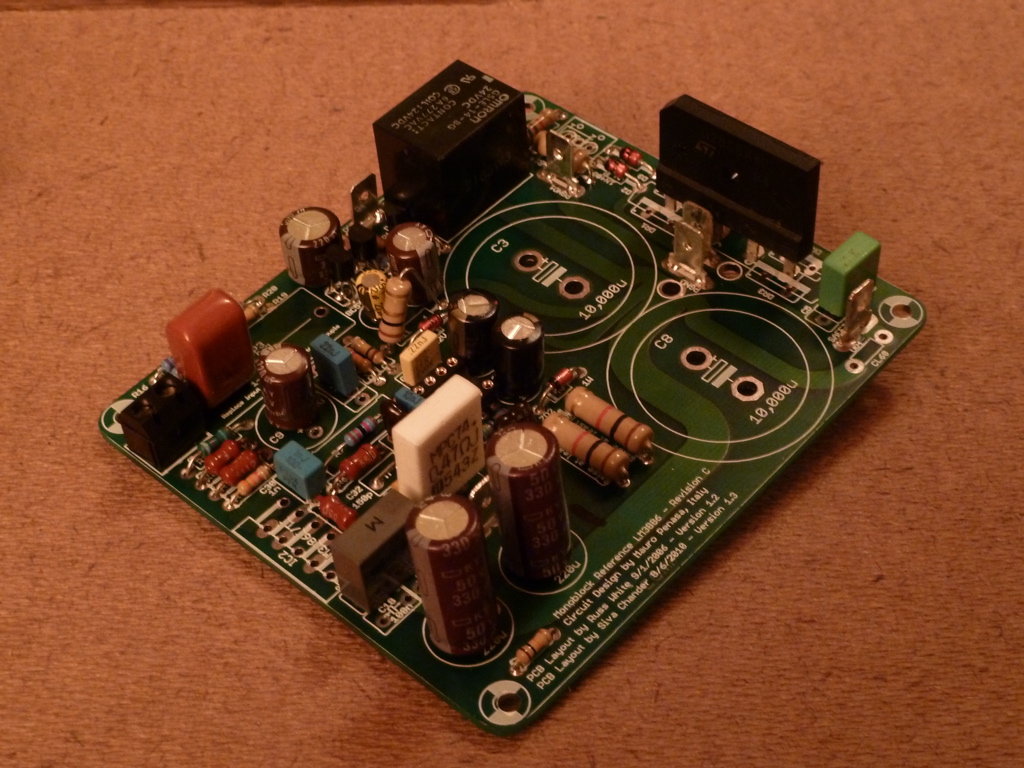

Yet Another MyRef Build.

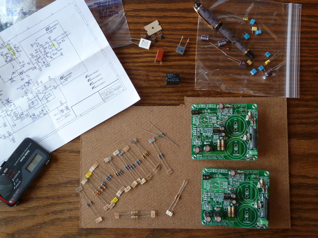

Since it's not yet making music, I figured I would post some pics here rather than the ChipAmps gallery. 😉. These are two of Siva's RevC boards with his RevE component package. The first couple photos show the assembly and testing of the power section and delayed turn-on circuit, followed by the completion of the rest of the kit components. I need to get my order in for the big caps and LM3886s - I have a few in my "reclaimed" bin, but they look a bit rough and I'd prefer to use fresh pieces for the initial build.
The kit was complete and reasonably documented. I had to send a couple emails to Siva to get clarification on what certain components were (it's been a while since I did a kit) but he responded quickly and with full answers in both cases.
BTW, does anyone have a good recommendation of soldering/connection methods for those two 10,000 uF caps? I was looking at getting a set of snap-in's over at ApexJr.com, but the holes are so large I was worried about how to get a good solder connection. Thoughts?
It's unlikely you will be able to fill the hole with solder if it's too large.
For the caps I'd put solder first on both sides, and then, with the solder still hot to touch, I would bend the cap pins to secure them firmly. Then apply the solder. The idea is to provide a mechanical support first that will hold the cap to the pcb, and then solder.
Putting solder first is done in order to the capacitor not getting too hot.
