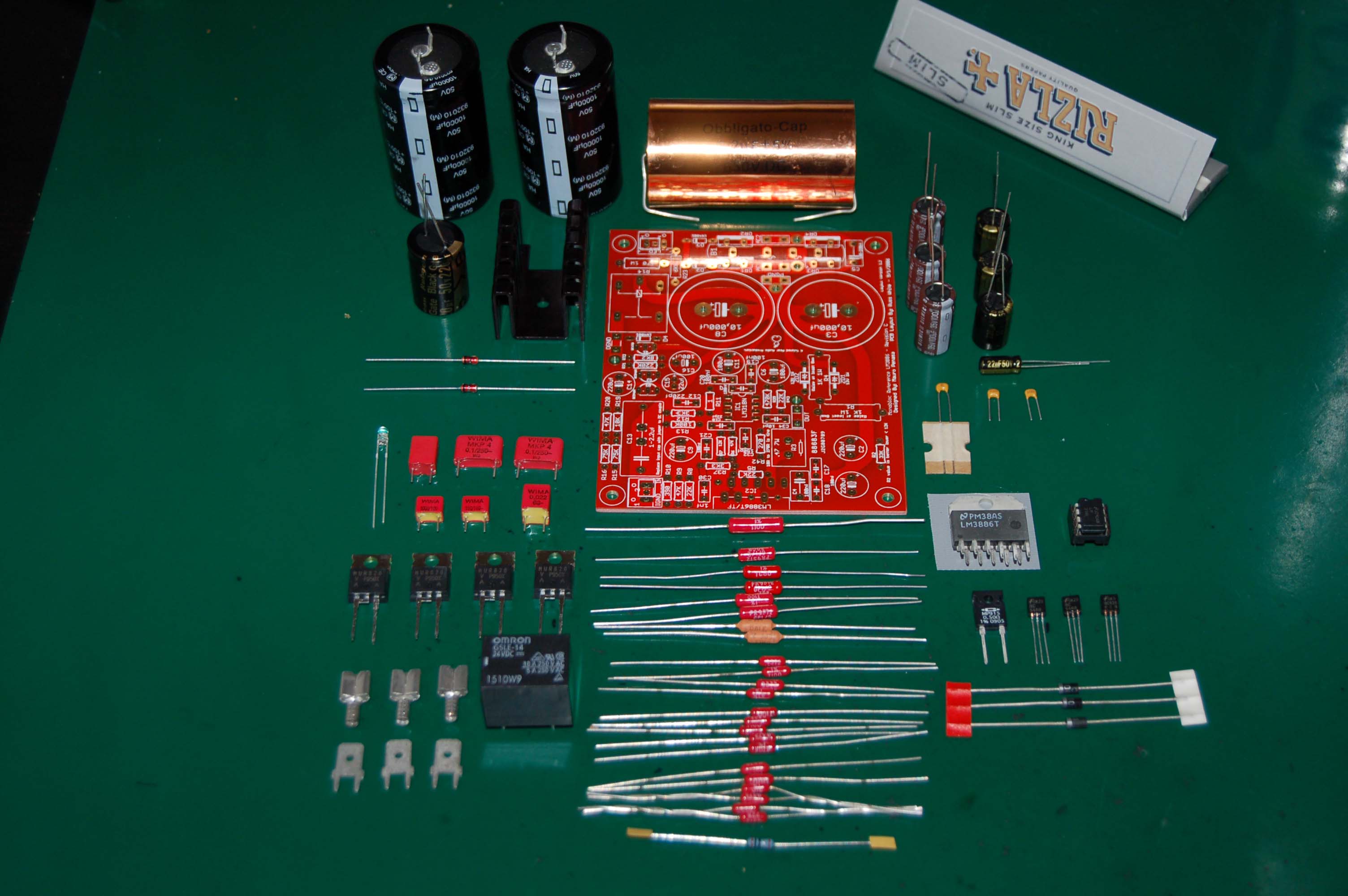

This is what I got parts wise for 1 complete channel minus the rizla😉,hope you get yours soon Regi its worth the wait 😀
Rizla king size rules! or rolls? 😀
This is the first picture of the kit I see with all the components lied on a table. Now I can see with details all the components I had only in mind. You stolen me this picture! I was thinking in taking it as soon as I receive mine!
Just joking 🙂
Those obligattos look impressive in any situation.
Waiting to see your kit assembled...
