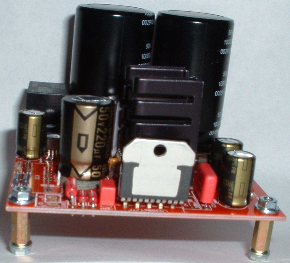

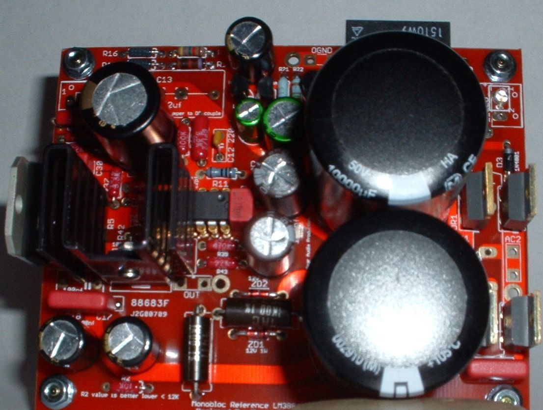

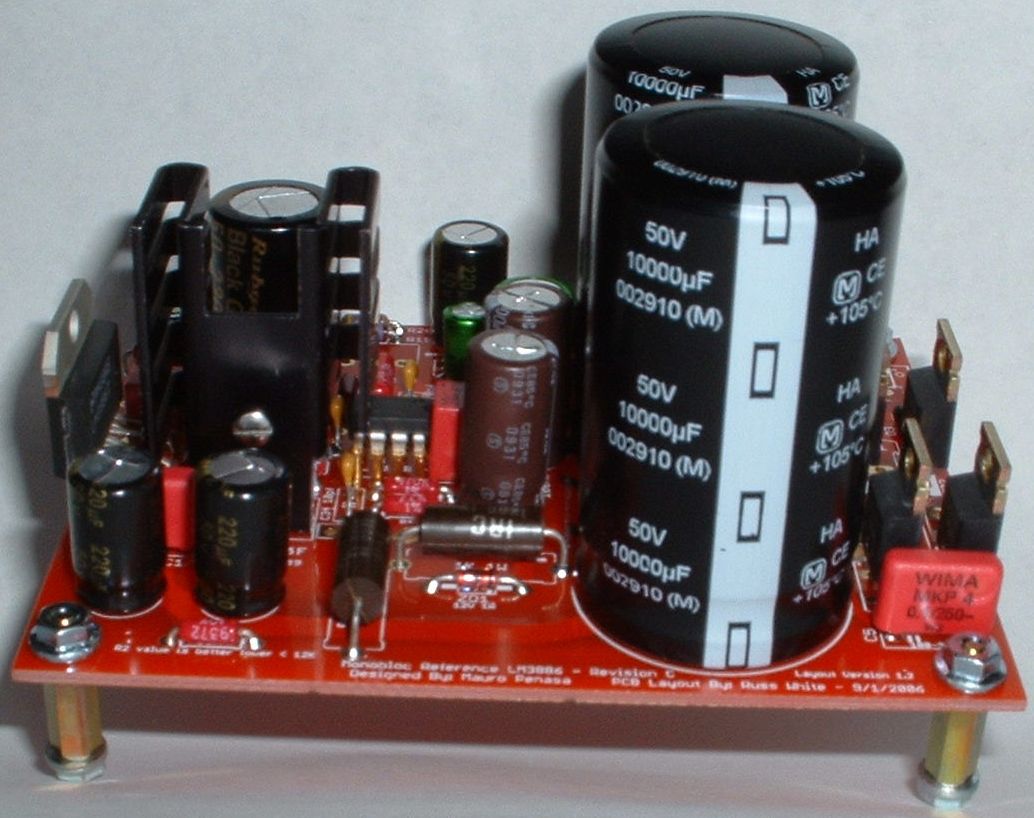

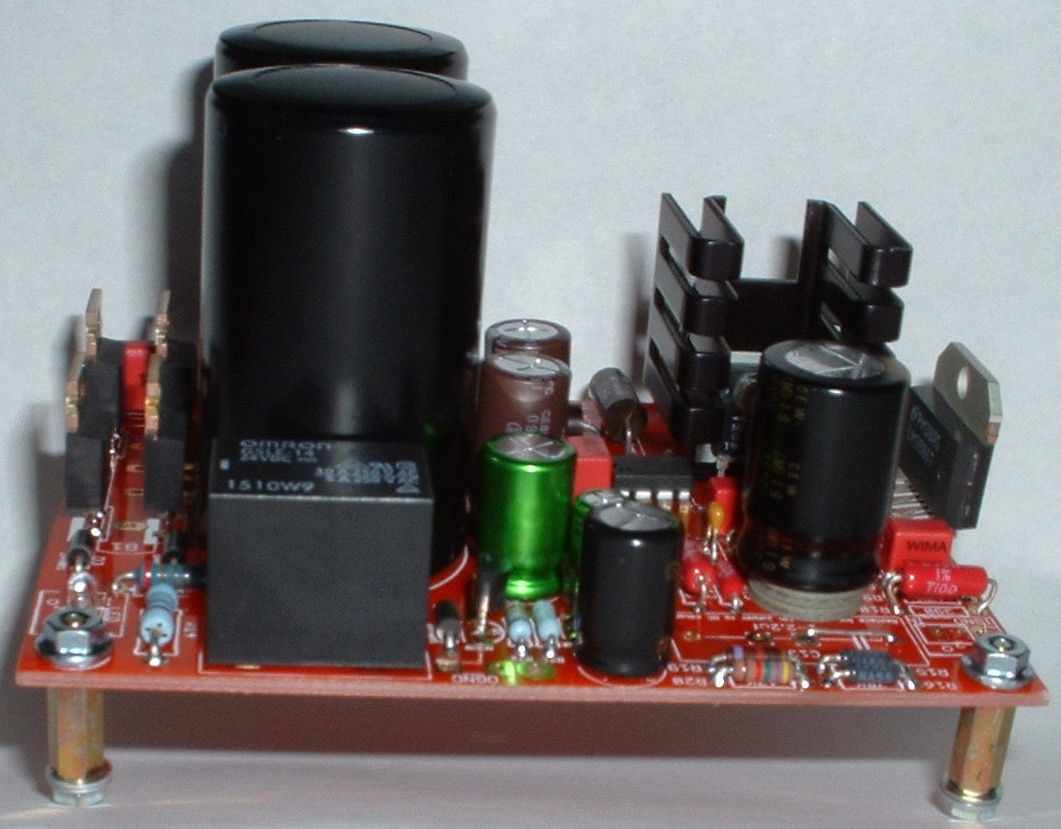

I have finished building the first board of a stereo pair and have some comments on how the build went.
In my amplifier box the back wall of the enclosure is the heatsink. The amplifier board mounts to the bottom plate and the LM3886 is fastened to the back wall (heatsink). For this to work the LM3886 must protrude past the edge of the PC board to keep the board from touching the heatsink before the LM3886 does. Unfortunately the board protrudes further than the back side of the LM3886 because the layout placed the LM3886 too far to the interior of the board. I had to straighten the leads of the LM3886 and reform them to make the chip protrude past the board edge. Depending on your heatsink configuration this may or may not be a problem but is something to keep in mind.
The heatsink for the Caddock resistor needed a fair amount of surgery. On the LM318 side two fins were removed and one fin on the LM3886 side. Wire cutter pliers are able to cut through the soft aluminum.
Capacitor C4 is supplied with 10mm lead spacing but the board layout is for 7.5mm. The location of C4 interferes with the Caddock heatsink so I formed the leads of C4 outward to span the holes for C17 and C18. Since C17 and C18 are not used, C4 was placed there to avoid the heatsink.
C5 is also a 10mm part with a 7.5mm board spacing. Forming the leads inward slightly allows it to fit in the board.
The Black Gate capacitor does not fit well in the board. The leads need to be formed inward and then it sits on R13 in an unstable position. I put two fiber washers under the Black Gate to raise it just above R13 and make the mount more solid.
R10 and R12 are supplied as 1/2W while the board takes the 1/4W size. Both resistors need the leads formed to fit.
In the relay circuit I used generic parts and avoided the cases where the supplied resistors are too large for the board layout. For the capacitors I used nonpolar Nichicon ES parts and put clamping diodes across them on the bottom of the board. I had 25V capacitors on hand but anything 10V or more is suitable. I had intended to modify the board to put in a 24V regulator for the relay but it didn't turn out to fit well with the board layout. To correct the low supply voltage problem in this circuit I changed R14 from 470 Ohms to 68 Ohms. That powers the relay with about 23 volts with a 22V transformer in the power supply. For a 25V transformer try 100 Ohms and for a 18V transformer, 10 Ohms. The diodes were changed from 1N4001 to UF4002 since the circuit needs more than a 50V diode rating.
C21 will not fit on the top side of the board so it was placed on the bottom. The leads were bent at a 90 degree angle and the cap placed on its side. The original holes for C21 were used to solder the part in.
Overall the build went fairly well. The worst of it was reforming the LM3886 leads. Using audiophile parts caused a few issues with the fit but nothing that wasn't easily handled.

Tom, you raised several issues and there is no short answer to any of it. I work for a major corporation designing electronic assemblies (not audio). A given design might be sold a a rate of 50000 a year and a field failure rate of 5% is more than enough to call a halt to production. So if 95% of the units work, I have failed and will be called before an executive review board to explain myself. Obviously this is highly unpleasant and it is far better to design and test thoroughly beforehand. Is it reasonable to apply these standards to the audio hobby? Maybe not, but for me it's ingrained I guess.
The relay circuit uses several components outside the manufacturer's specifications. Even so, given the use of quality components with built in design margins, some or most of the units may work. But it is poor practice and not acceptable in my world. Regarding the diodes, it is not a case of purposefully selecting a weak component. There are fuses and other circuit protectors for that. I have measured samples of 1N4001's on a curve tracer and the breakdown varies all over the map. Some manufacturers seem to label some lots 1N4001 when they actually measure as if they are rebranded 1N4004 types with a 400V breakdown. The economics of producing one part that can be branded with several part numbers may dictate that decision. Regardless, the user can't know how much above the rated voltage a given 1N4001 will tolerate.
The LM3886 mounting issue is a question of mechanical force transmission once the screw is tightened to hold the chip against the heatsink. The screw wants to force the chip flat against the heatsink. The board sticks out further and hits the heatsink and tries to prevent the chip from flattening against the heatsink. These opposing forces put strain on the solder joints at the PC board and on the chip package. If the metal tab on the chip bends even microscopically, it can crack the chip die. Or the strain can cause the solder joints to fail over time. Or the chip may not achieve good contact with the heatsink since the lower part of the chip package will tend to pull away from the heatsink. In that case the thermal path from chip to heatsink will be poor and the die will run hot. In no instance is it an advantage to have the board touch the heatsink.
I removed more material from the Caddock heatsink on the LM318 side because I used an IC socket and do plan to try several different LM318's when the amp is up and running. Getting access to the socket to change op amps required a bit more space than if I had just soldered the LM318 to the board directly.
I will report my impressions about how it sounds but it's going to take a while to finish building it. Before it is installed in the system there are lots of bench tests I want to conduct. The amplifier circuit is really very complex with several nested feedback loops. No decent SPICE model exists for the LM3886 so the simulation part will have to be skipped. The wide range of values for R42 (see the PC board silk screen) is of some concern and I want to get a better understanding of how R42 affects the amplifier stability.
