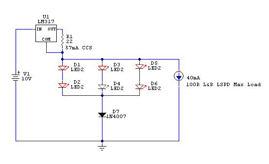

I have realized that there is another king of regulator for the LDR volume control. It was designed by Salas, using leds as shunts for reference.
Schematic in the attached file. You will need to add the input, output and adj-to-ground caps, and the output load resistor.
