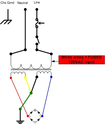

noodle said:Yes was the one with
2 white leads, ONE red, black, yellow and blue?
Not sure on the hookup. Had seen that pic in the comment but not quite enough detail to see the exact hookup.
Thanks again for any help.
Noodle-
This should be your hookup for ONE amp board with ONE transformer.
You can email me directly too. The email is in my profile here on DIYAudio.com and is enabled.

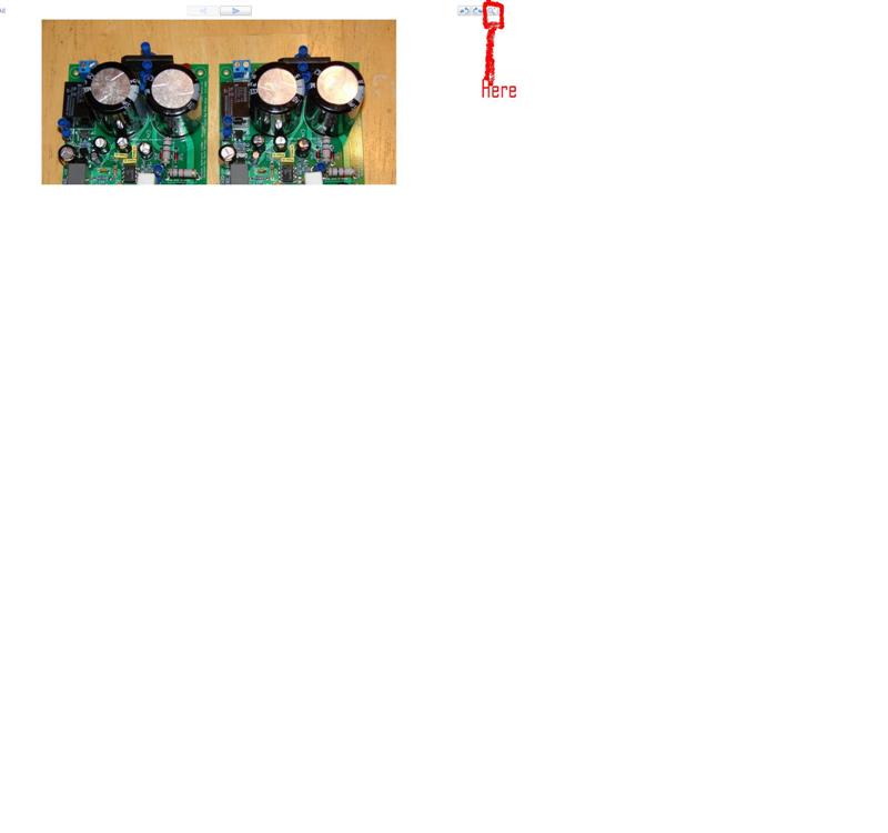

You can post a picture and we can double check the placement of the parts..
I have a close up photo here:
http://picasaweb.google.com/troystg/Rev_C#
Click on the picture and then when it opens on the right hand side of it is a magnifying glass to "zoom in" on the PCB's.

Hi guys,
Here's a look at my build so far. album Zoom in to see detail. C4 and C5 are the caps I was asking about.
thanks,
Marc

Marc-
Yes, if Peter and Uriah say that is the correct value for those caps (C4 & C5) then your installation should work fine.
As mentioned, my first kit was a "trial" test fit and apparently had different caps but I am sure Peter and Uriah double / triple checked the parts before ordering / mailing and yours should work.

They look like what I would expect.marc brown said:album Zoom in to see detail. C4 and C5 are the caps I was asking about.

Basically, if you followed the white paper labels on the caps everything should be fine. See the picture of the caps bag contents http://www.diyaudio.com/forums/attachment.php?s=&postid=1717114&stamp=1232334559schro20 said:They look like what I would expect.
