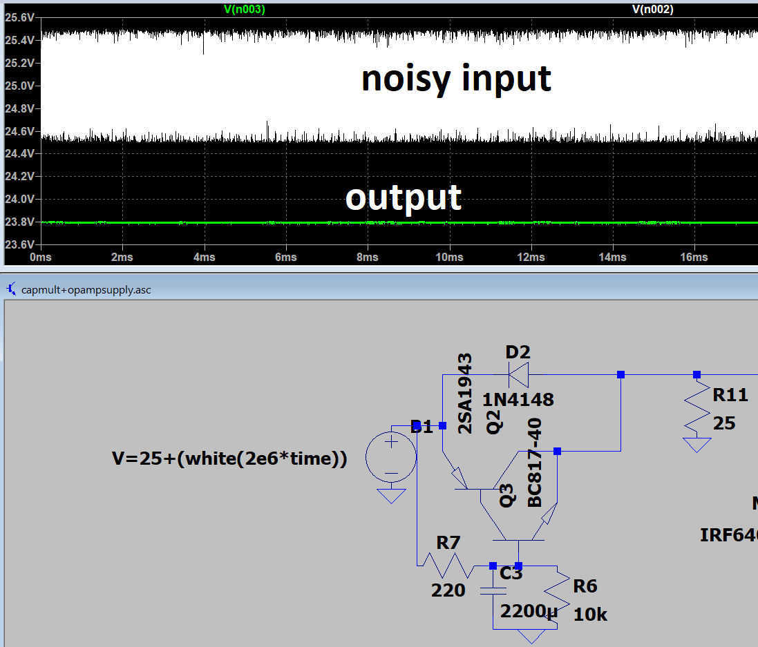

We can improve the situation, AND at the same time be more efficient on the use of capacitors by using capacitance multiplier.
It works by multiplying the capacitor on the base by the gain of the sziklai pair, its gain is calculated as hfe1 * hfe2 + hfe1
The beta (hfe) varies with current, so we will only guesstimate in the ballpark here but for 2SA1943 and bc817, its about 60*300 = 18000, multiply that by the capacitor value and its your effective value....it's a lot of filtering.
The results are even better for a normal PSU, notice on the simulation the noise has a magnitude of almost 1V but it is effectively filtered out.
What this means effectively is that you are not bound to only expensive PSU solutions, you can easily use common SMPS for power, further lowering cost and size requirements, while giving better performance than its predecessor.
There are also two thick holes for leads where you can connect them to a cap bank somewhere else inside the case, but dont get too overboard with this, there is no need really.
Another benefit is more removal of high order harmonic content from the noise spectrum. Another benefit is the higher the load, the more filtering you get.
On the PCB these are mounted very close the LM3886, both for performance, layout, but also potentially cooling reasons as you can then heatsink mount them. This is recommended but perhaps not even necessary if you listen to about 10-20W volumes, as they only dissipate in the hundreds mW range then.[/SPOILER]

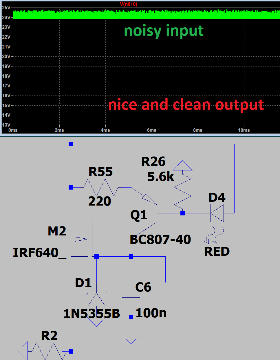

Improved Opamp PSU
We have a MOSFET based regulator with high PSRR, while at the same time being able to deliver a lot of current.
Just as a comparison, here FE uses also a CCS, a simple LM317 and one resistor. It works good enough though.
Special thanks to Tibi on this one!

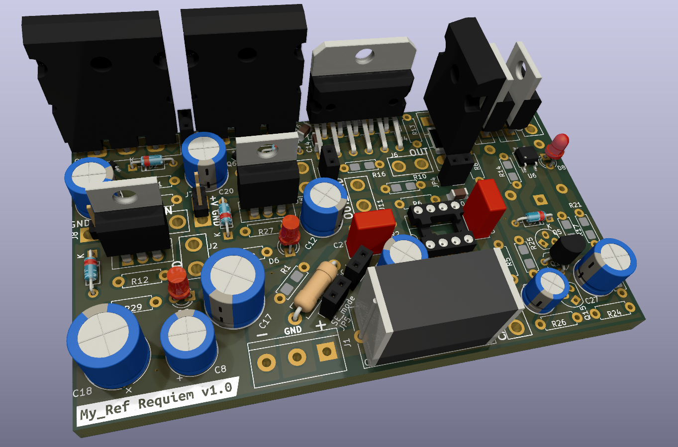

Improved PCB layout
One of the things i didnt like about FE was its unecessarily long traces, and a fairly long current return path for the output (it almost couldnt be longer, it goes diagonally across the entire board). The resistors have marked directionality, despite the components themselves not being directional, and this was never explained (?). Even has a jumper wire for a trace, suggesting this is a 2 layer design (but i dont know this for sure) and he didnt want to disturb the current return of the top trace through the ground (which is good thinking, but shows the kind of compromises made.) All of this made me decide it might be best to start from scratch with an own board.
We have a 4 layer board, and the inner 2 are perfectly uninterrupted, except where i want them interrupted with a keep-out zone. There is a lot of copper on this board, copper fills were also used for some critical connections (such as the output, or power rails). It is a compact design, measuring about half the size, at 100x55mm. Actually, i will probably increase the width to 65mm, main reason i designed it this tight to the point everything on the silkscreen is overlapping (unimportant, its just numbers, also with html bom tool you dont even look for markings on board as its highlighted) was for use in a super-compact case.
If anyone else wants the board, i might make a new more "relaxed" one.
IMO, i've made prettier boards, but im pretty happy with how it turned out electrically.

The board looks nice and compact. What are the dimensions? I suggest adding mounting holes in a future revision. Having the board dangle by the component pins is not a good idea. Eventually the pins will fatigue and break.
