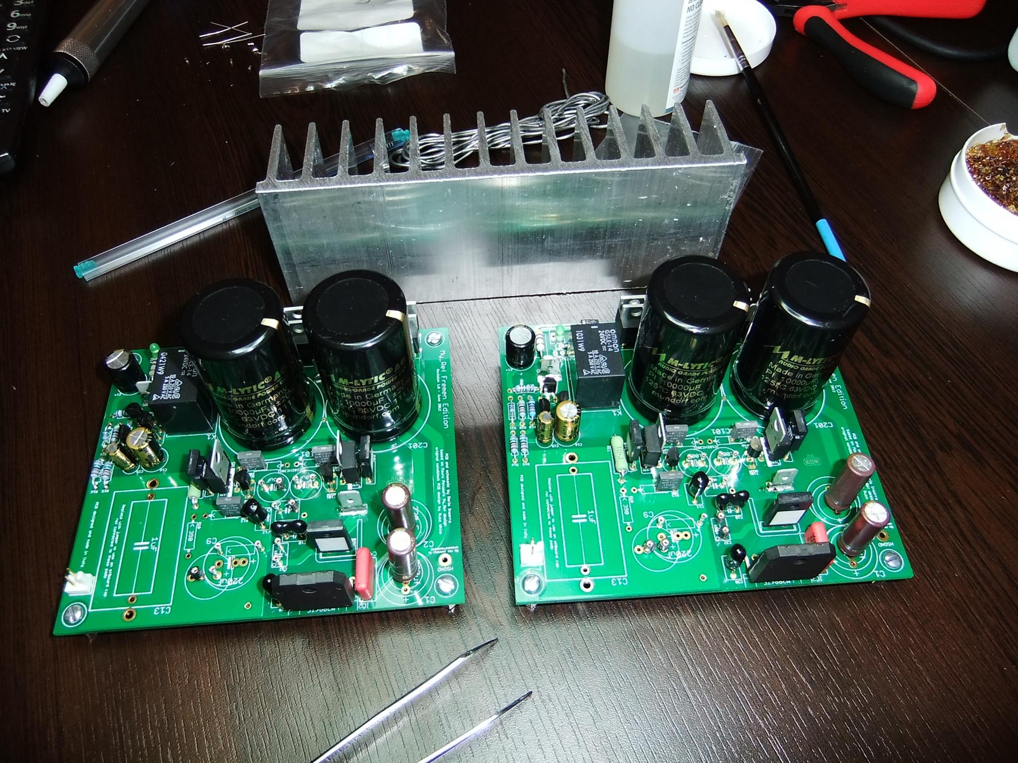

The BOM says they should be 50 V. When I put the part number from the BOM into the Mouser website, it comes up as a 35 V cap.
Just checking, are these OK at 35 volts?
The 35V cap will work perfectly, probably it was specified in bom in place of the 50V one (647-UFW1H221MPD) simply because at the time it was not available.
no.Simply, when two bridges are used, the current through each bridge is half of a single bridge for a given load.
the current in each diode bridge of a dual bridge arrangement is exactly the same as the current through a single bridge arrangement.
I don't think there are any sound differences between the two bridge arrangements.
There is a difference in the grounding schematic between the two bridge arrangements.

I bow to your greater experience. Please help me understand the current flow in the single .vs. double bridge.
My understanding was that the current flow out of the smoothing caps was controlled by the demand of the amplifier. The current into the smoothing caps is the amp demand plus or minus some current flowing in and out of the smoothing caps. If I can assume that the two secondary coils operate independently at the same voltage, then isn't the current through each secondary coil in parallel and about half the total? If that statement is correct, then wouldn't the dual bridge approach flow half the current through each bridge? Just trying to understand.
As for a sound difference from single to double bridge, I am also not sure. I respect the earlier work of Subbura and others, but I will experiment a little to try it myself. I will also study the grounding scheme as I hadn't considered that before.
Thanks for your input. I find these questions very interesting.
Jac

Did you install all four and is there any solder on the top of the board?
No. I reversed the direction for only one. I have that wick. I will try to desolder it.
Thanks Bob.
Hi Jac,Please help me understand the current flow in the single .vs. double bridge.
Andrew is right on this, diodes see the same current no matter which way.
I used to be an advocator of dual bridge, but after really thinking it through, analysing it in spice, and finally measuring its properties (a current clamp is a nice tool) I decided for myself there is essentially zero benefit, in the end. It can be even more sensitive to supply noise issues (leakage current paths get chopped, modulated by diode conduction timings, unless one takes special measures) than a single bridge.
As for wiring/layout advantages, think of the PSU as a black box with a break-out cable with a 3 pin plug (pos/neg/gnd) and a socket right at the point of load. It obviously cannot make any difference whether there are three or more than three conductors in the cable, unless I'm missing something... the actual "cable" embodiment is of great importance of course, same for the bridges and caps wiring (strive for lowest loop area, mainly) as well as aditional components (snubbers & filters)

I got a care package from Mouser today. It should have the bits I need to finish the build.
I ordered some of the sockets suggested earlier in the fine tuning thread. I tried to fit the BG STD caps for C9 into the sockets, but the leads are too thick. For you guys that have used these sockets before, what do you do when the leads are too thick? My thought was to file down a short section of lead to fit. Open for ideas. I am hoping to socket and compare C9 and C13,
Jac
