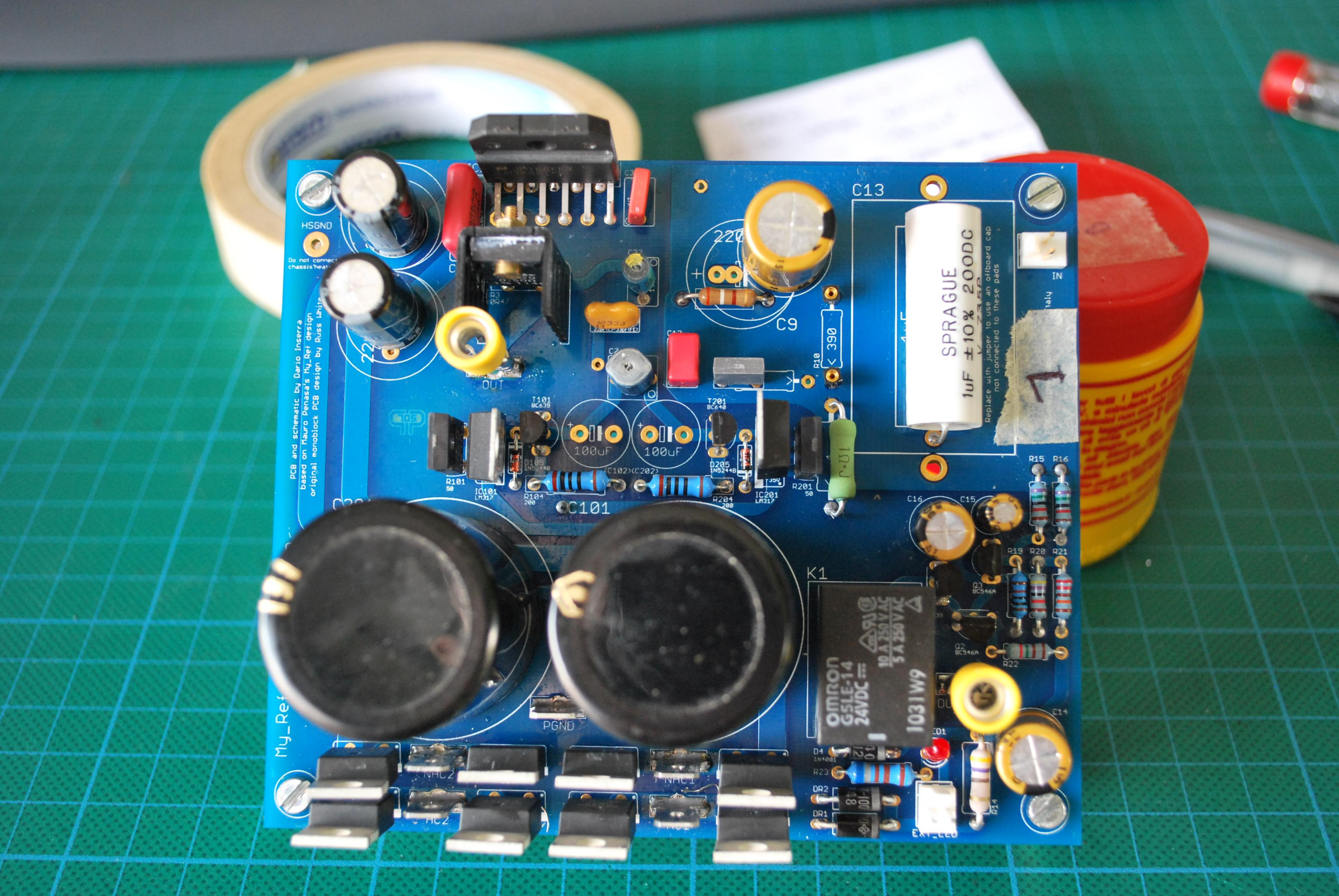

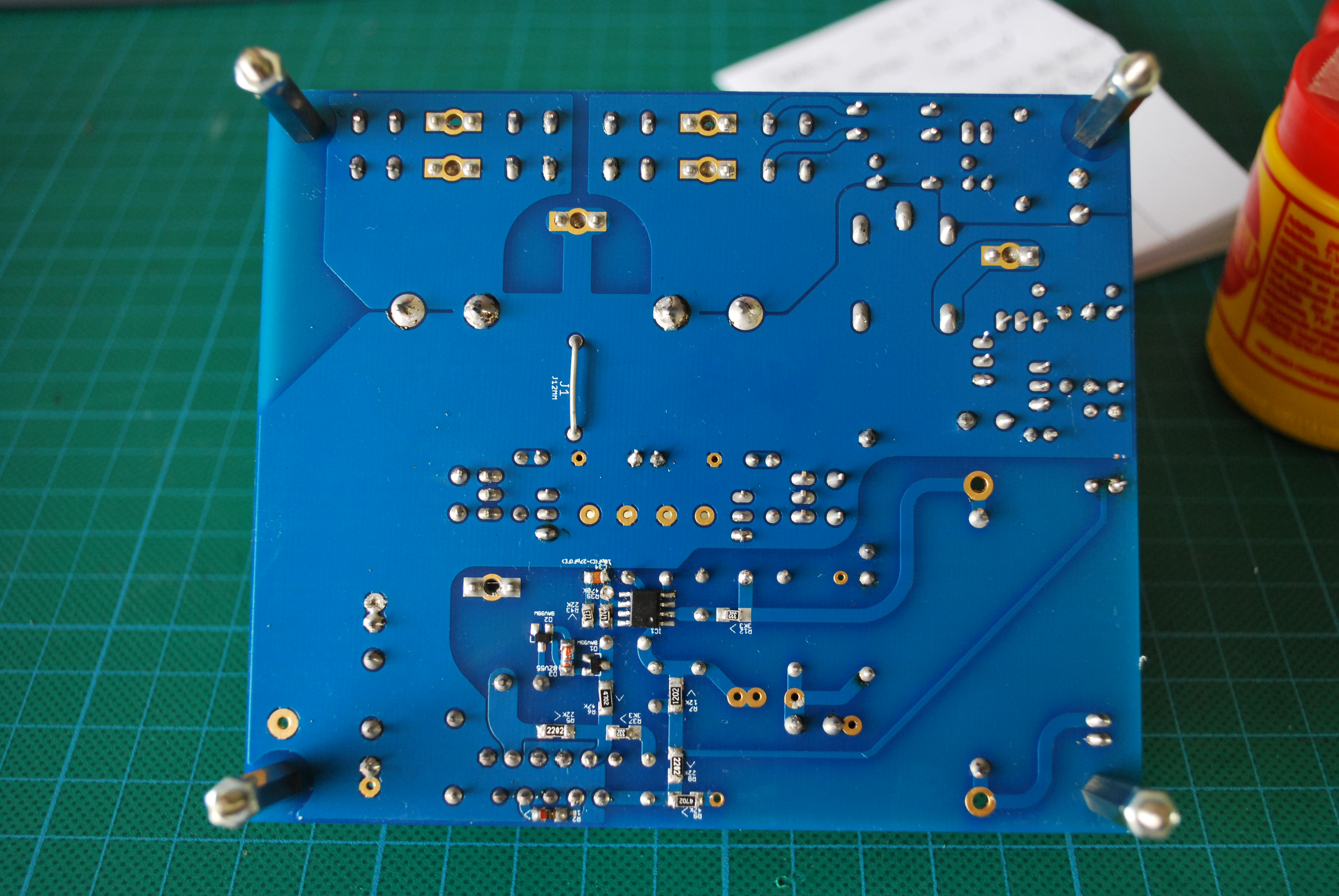

Hi guys, yesterday I've started with the build.
This morning I've tried to power on both channels but the relay don't started on both. :(
After a check-up i've found some bad join, now both relay and led are working after power on.

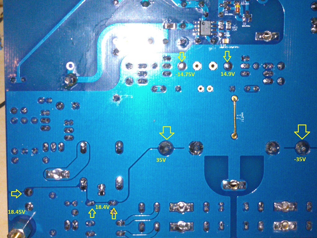

Unfortunately channel "1" has some problem, when I try to measure the DC offset I found 60mV and sometime the relay cut the circuit, in this situation the DC offset become 5V!
On C101/C102 I've +/-32.7V.
I've attached two pictures of this channel
The channel "2" has 10mV DC offset so I presume it's correctly working.
Thank a lot for any suggestion.
R.

If voltages are correct I see two possibilities:
  • C32 has been overheated during soldering (try to measure it)
  • LM318 is gone

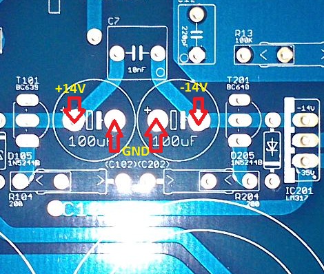

Thanks Dario, when led is on, the values are:
  • C101: 32.5V
  • C201: -32.5V
  • C102: -14.2V
  • C202: 14.6V
  • C14: 16.5V
  • D4: 16.5V
When the relay switch off D4 is 0V and C14 32.3V
so I think they are correct for my 22v toroid

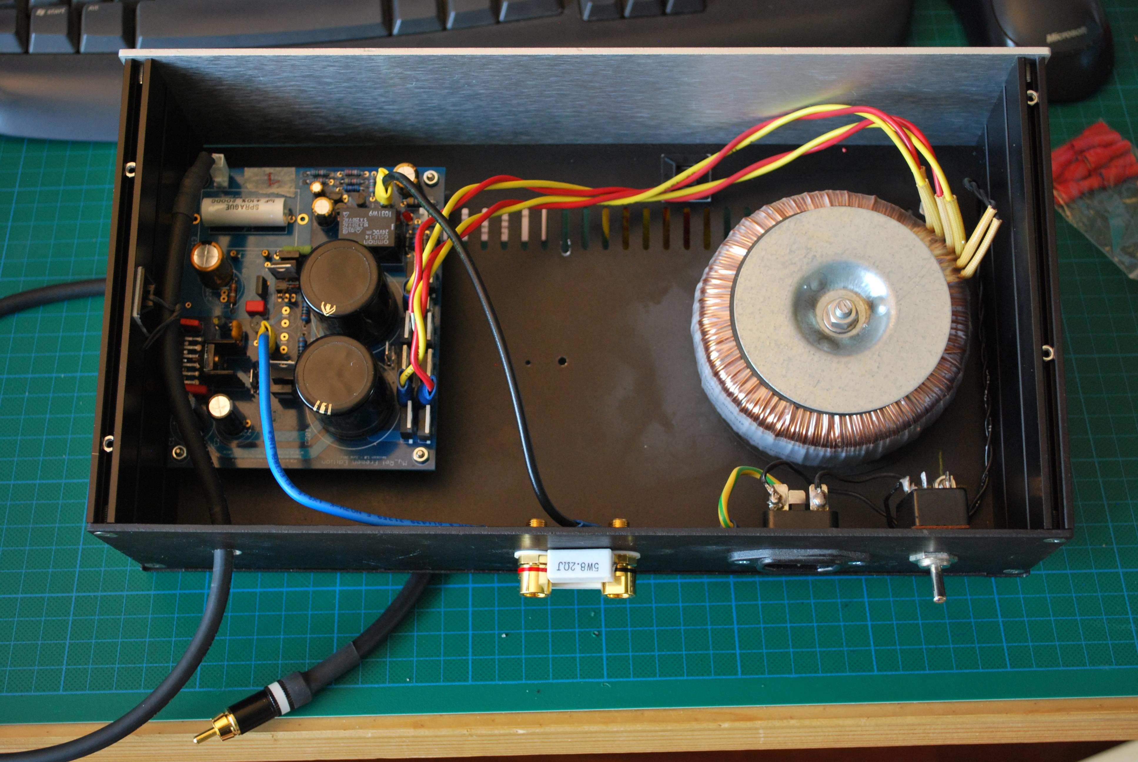

This is a picture of the "unlucky" channel with connection and case:
attachment.php
I've build a direct signal cable from board to preamp without rca plug in the middle
Roberto
