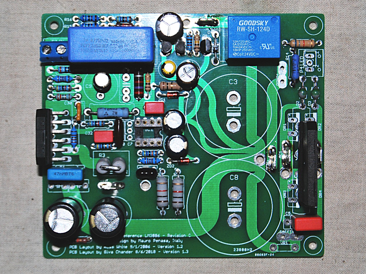

LinuxGuru, what are the dimensions on your v1.4 PCBoard, please? 🙂
Both V1.3 and V1.4 are nearly identical at 91 mm x 104 mm +/- 1 mm. The slight variations are due to different vendors and manual cutting tolerances.
Is there a picture or PCB layout available to see? If not, on which dimension is the LM3886? The 91mm or the 104mm?

It is on the 91 mm side. You can see a picture here.

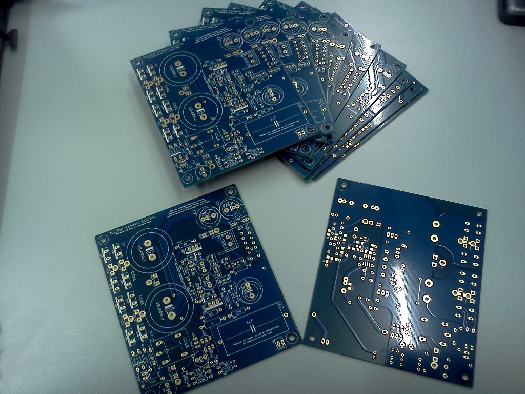

Finally PCBs arrived, I've attached some pictures.
Since this is my first PCBs order I'm not sure if I should be satisfied by the manifacturing quality...
All PCBs have been manually 'fixed' for etching problems, is it normal?

If they are only fixing the blue mask, then I would not be worried. If they are fixing the traces and pads, it would depend upon price. But did they gold plate the whole board or just the pads?
Quite all fixes are on pads/traces surrounded by the ground-plane.
All the copper surface is gold plated.
Price is the lowest I've found, BTW for the GB I'll use a different manifacturer, probably a local one.
I am wondering about gold plating these days. Some time ago I sent in some connectors for examination, results showed high content of nickel.
I suppose is pretty normal... all PCBs' gold finish usually is Electro-less Nickel Immersion Gold (ENIG).

You really need to increase the spacing between the tracks and the ground plane (copper pour) before you send these out for the next production run
While I do agree that more pouring could avoid problems I'm still not satisfied.
The PCBs were perfectly compliant with manifacturer's specifications.
TP boards have less spacing between pads/tracks and groundplane than mines... I've buyed them from both the GBs and they were always perfect...

Got my package today. At close inspection I can"t see any problems with the through-hole metal on the few defects you pointed out. They feel quite durable and appear they will sustain parts swapping well during the beta/tuning process.
Yes, material seems first quality.
Sadly processing is not as good...
Maybe we should have invested some money in the electrical test...
