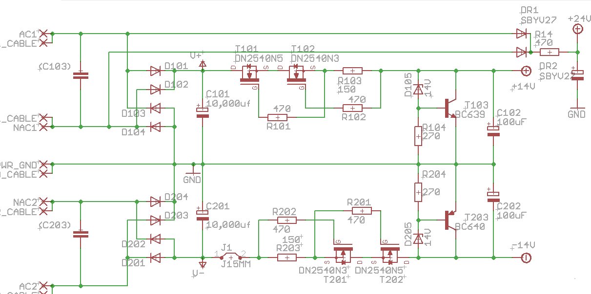

is the attached schematic with DN2540 CCS correct?
Thanks in advance
Yup, it looks OK.

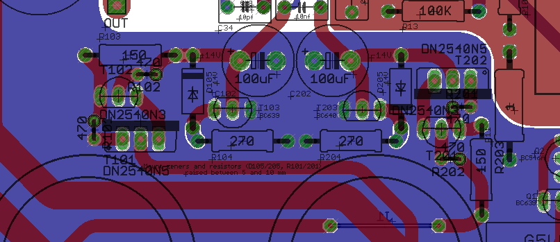

Yet to be refined but for the depletion mosfets I've found a possible solution (see attachment).
Can you post the schematic of your CCS so I can try to fit it on board?
It would be fantastic if you manage to simulate also the cascoded depletion mosfet CCS.

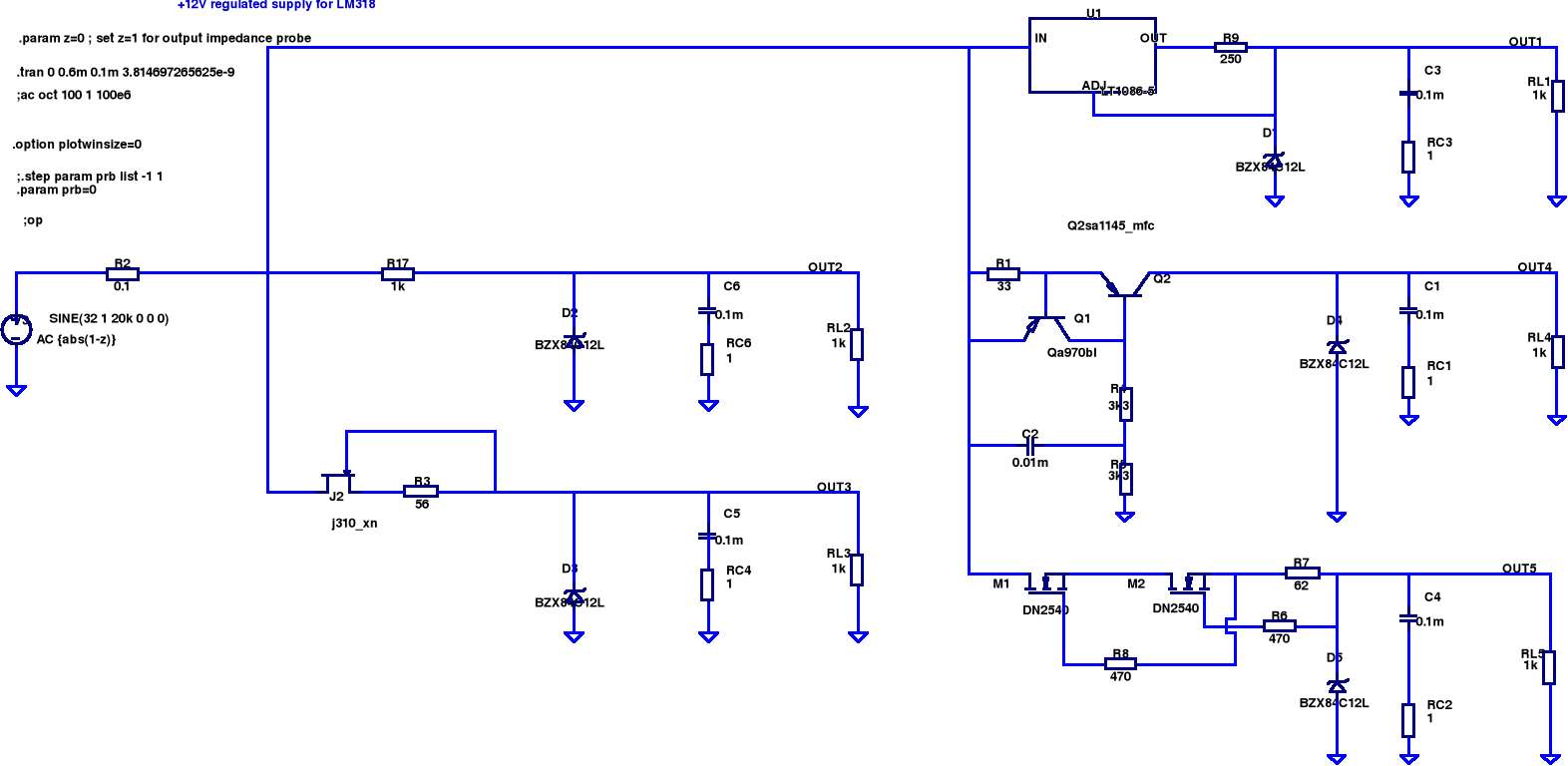

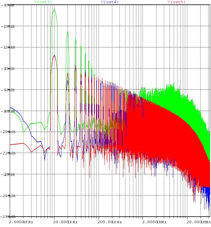

OK - here are some quick and dirty simulations of my BJT CCS (OUT4) and your cascoded MOS CCS (OUT5) - source resistor adjusted to 62 ohms to normalize the CCS current to approx. 20 mA for both. Surprising result! They perform nearly identically, and better than the LT1086 regulator. They're also better than the single JFET and plain resistor, but I've omitted those FFT curves.
I would suggest that you simulate drain as the load. Just like simulation of MyRef damping.

Help me to understand, those FFT curves represent rejection, right?

I don't understand. I have a 1k resistive load which draws ~12mA, comparable to the max. current of the LM318. Could you explain "drain as load"?
If you only provide constant current drain, it is different from dynamically varying of drain in actual use.
Like in damping simulation, the left hand side would be a constant voltage source instead of your AC, at the drain, it would be more realistic to apply AC current source in series with a resistor. Then you will simulate how load effects the voltage.
Can you also simulate output impedance?
Yup, the FFT curves represent rejection of a 1V amplitude sinusoidal signal added to the 32V DC input. (To be accurate, I should have normalized it to 1V rms ~ 1.4142V amplitude, so the dB numbers could directly be interpreted as PSRR values, but it's only about 3dB off. It's fine for comparisons.)
This can be easily be obtained from an output-Z calculation for the shunt regulator. The CCS has an ideal impedance close to infinity and will drop out of picture, leaving only the shunt section providing the source-Z. For the zener + BJT beta-multiplier, it will be a few 10s of ohms / beta - typically less than 1 ohm dynamic impedance, maybe as low as 0.1 ohms.
