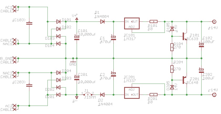

really strange.The schematic is correct.
Perfect

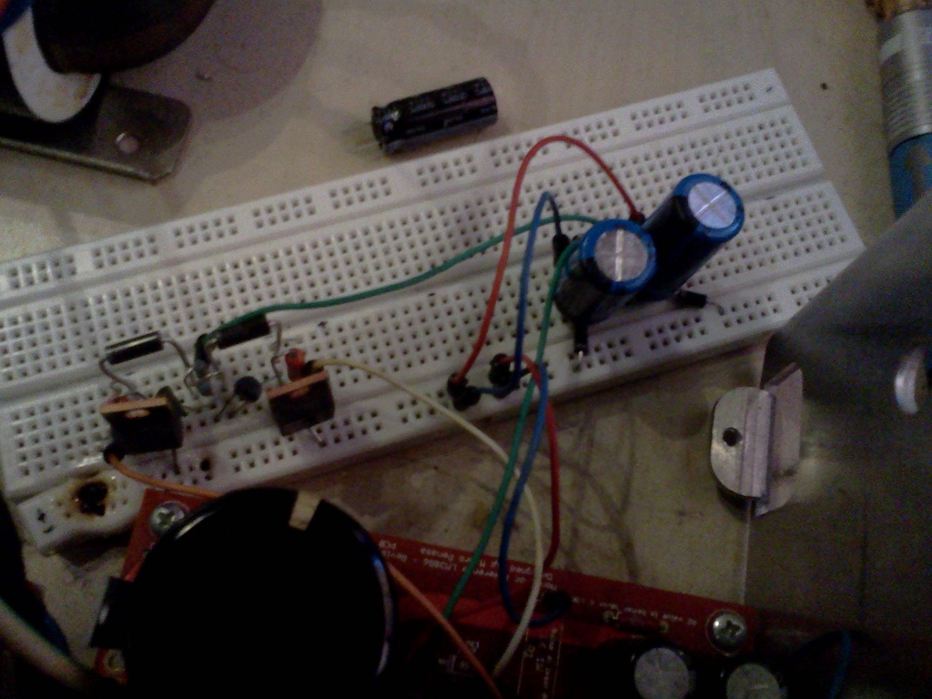

Are you sure that you have actually connected everything according to the schematic? (make sure the 3886 is actually connected before the diodes!).
Yes, I think so
Perhaps the 220u are a bit too small? Don't you have any larger ones?
Not 50V rated...
The problem may also be the new circuit layout.
No, I'm still using TP boards and a breadboard, see attachment.
Where is the cap common ground point connected? consider that with the cell the currents on the 318 closes on that point rather than on the general star ground as they did before (using only a rail-to rail cap after the diodes should restore the previous situation WRT ground currents layout).
In my actual 'temporary' setup there is no much control on it...
Just in case, you may also want to try some different diodes types if you have some at hand.
I have UF4003, SF17 and SBYV27-100

😀No, I'm still using TP boards and a breadboard, see attachment.
ahem... with new layout I meant the changes in the actual current loops produced by the introduction of the D-C cells. 😉
that's a problem. In circuits like this one the actual layout does have a huge impact on the SQ.In my actual 'temporary' setup there is no much control on it...
well, given that with such setup it's very easy, let try them all and "see" if there are any differences.I have UF4003, SF17 and SBYV27-100
P.S.: about the C, you may also try connecting in parallel the ones you have (likely a bad idea, but... in this case trying costs nothing).
Oh, BTW: is that setup dual-mono or stereo? given the TP board I guess it's the former. Should it be stereo (common PSU rails), for best results you should double the D-C cells (and everything that follows), separating the power supply for the two channels.I'm still using TP boards and a breadboard, see attachment.
I'm sure about that but, since also the 'plain' regulator shares the same bad layout I think it's a fair comparison 😉

Just tried first 50R (23ma) and BC639-16/BC640-16 both with and without the D-C net.
Interesting results...
- as expected 50R gave back to the sound the same puch it had with LM3x7L (TO92)
- With 50R the D-C net still improves sound but not much
- With BC639-16/640-16 are a clear improvement over standard BC639/640, bass much tighter and faster, cleaner sound
- With BC639-16/640-16 the D-C net seems no more an improvement
Beta testers will have to work... 😀 😉

This evening, while swapping transistors and resitsors and I fried one of my monoblocks so no much time for critical listening...
So far BD139/149 seems very similar to BC639/640 so probably, since they can handle more power, they'll be in the production board.
I've also tried to reduce to 200R the 270R resitstors and sound became fuller and rounder loosing a bit of speed.
I've yet to underestand which value is more balanced...
