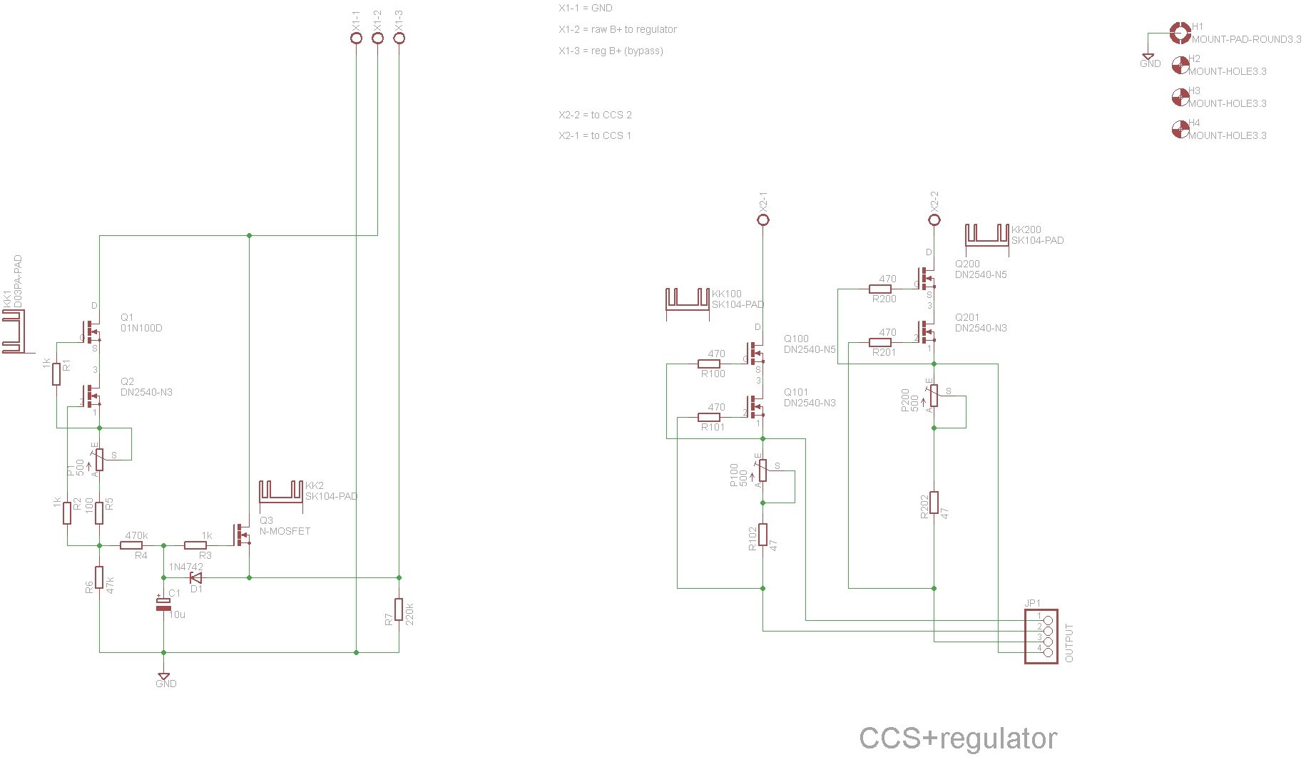

To made it clear, suggested CCS is something like this (of course no need for HV parts here):
Img from: http://www.diyaudio.com/forums/group-buys/190379-pcb-cascoded-ixys-ccs-tube.html

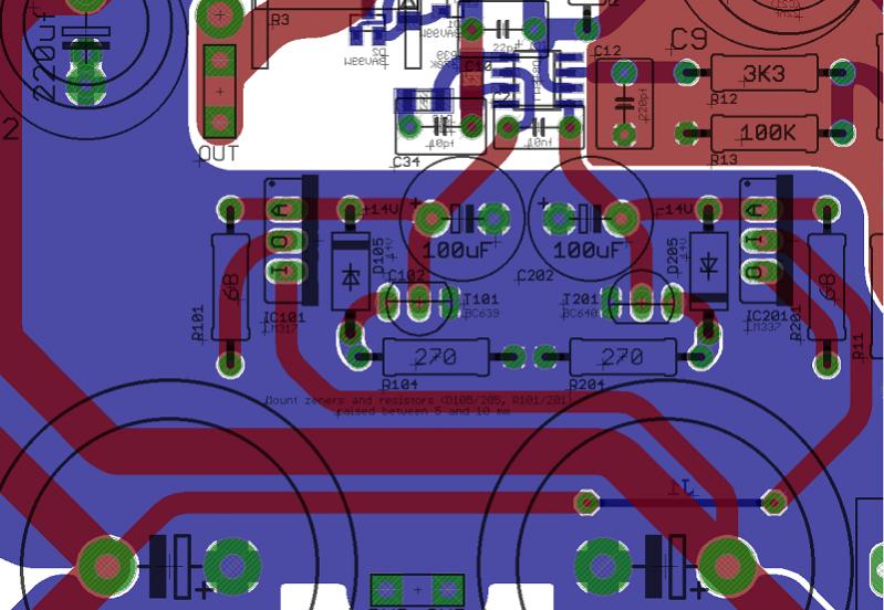

- Space on PCB is tight, the LM317 in terms of space is much simpler.
- I'm not able to size the FET CCS... (any explanation/tutorial is welcome 😉 )
I think the schematic from this post in the same thread is easier to adapt and all value are, more or less, there.
But there's still the bigger problem of all: space on PCB... 🙁
I can't imagine how to squeeze-in 4 TO220 FETs (and two heatsinks) and six resitors in the space of 2 TO220 and 2 resistors...
Something simpler is needed...

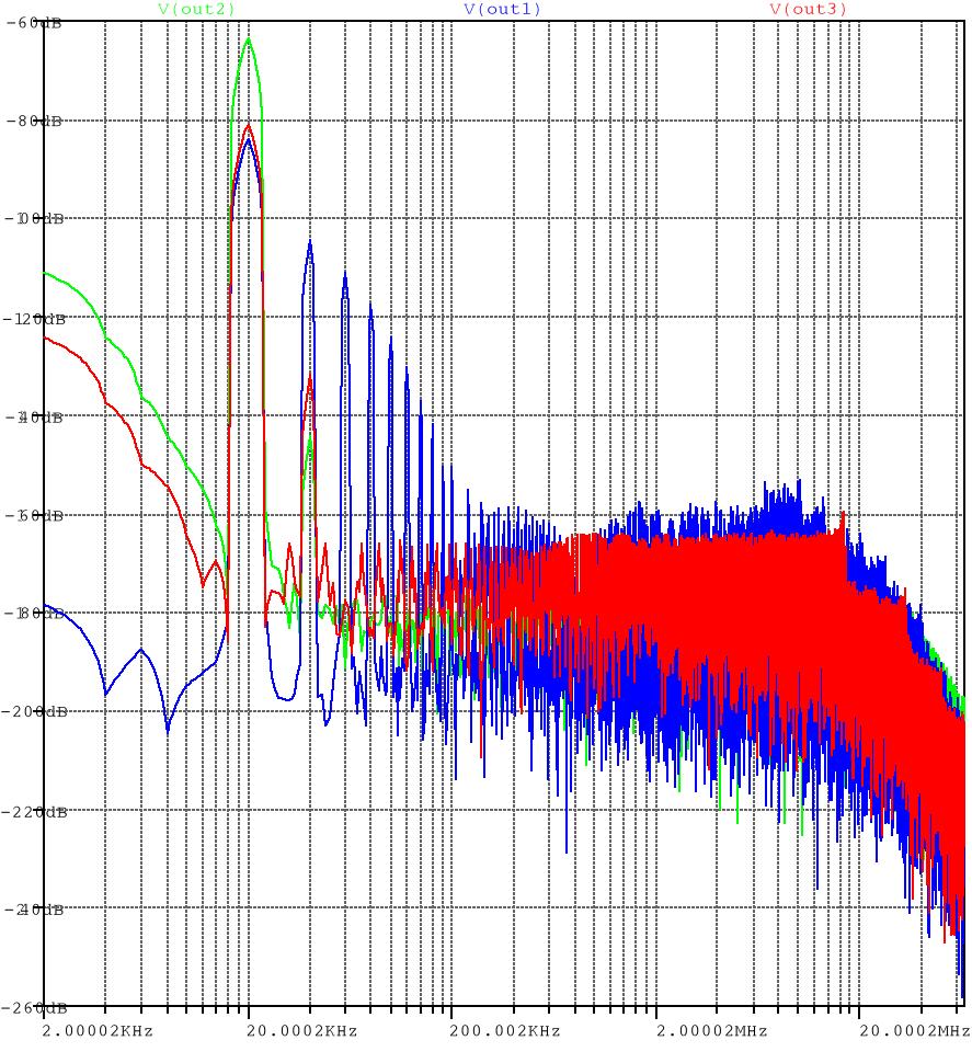

Here is the LTSpice simulation schematic (hope it uploads correctly from Opera on my phone). The 3 sections are 3-terminal regulator (LT1086-5) CCS, plain resistor CCS and JFET CCS.Siva, can you post a schematic of what you simulated? It's not clear to me...
The regulator does best on the 20 kHz ripple, but worst on the harmonics. OTOH, the plain zener does worst on the 20 kHz ripple, but best on the harmonics.
Can anyone elaborate why a CCS would be better than the original MyRef design?
The CCS keeps the current from the main (LM3886) PSU rails constant, regardless of spikes/dips in the rail voltage caused by the LM3886. It keeps the voltage contamination on the chipamp rails from reaching the +/- 12V shunt regulator, thus improving the ripple rejection of the shunt regulator. The best CCS would be an N-ch depletion-mode TO220 MOSFET with a Vds max of at least 50V, preferably 100V.

That's the same one!I think the schematic from this post in the same thread is easier
In that diagram (the one that you mention) there are TWO complete CCSs. In the picture that I posted there are also two CCSs (on the right) plus another unrelated circuit (on the left).
you only need 2 FETs and 3 Rs for each CCS. For this application heatsinks are probably not required (and perhaps not even TO220 FETs).I can't imagine how to squeeze-in 4 TO220 FETs (and two heatsinks)
