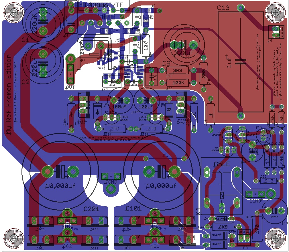

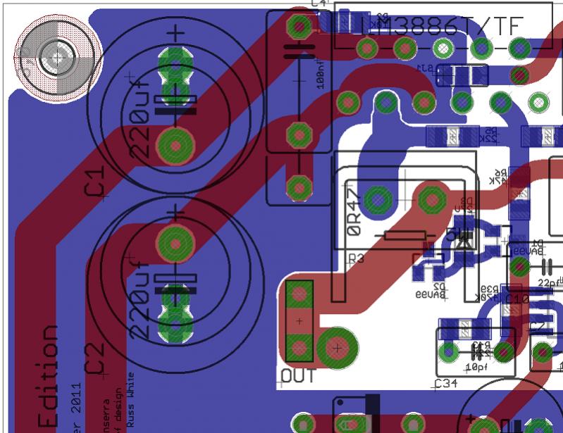

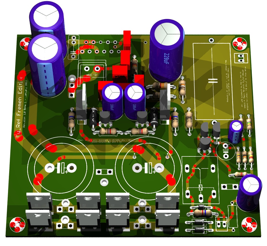

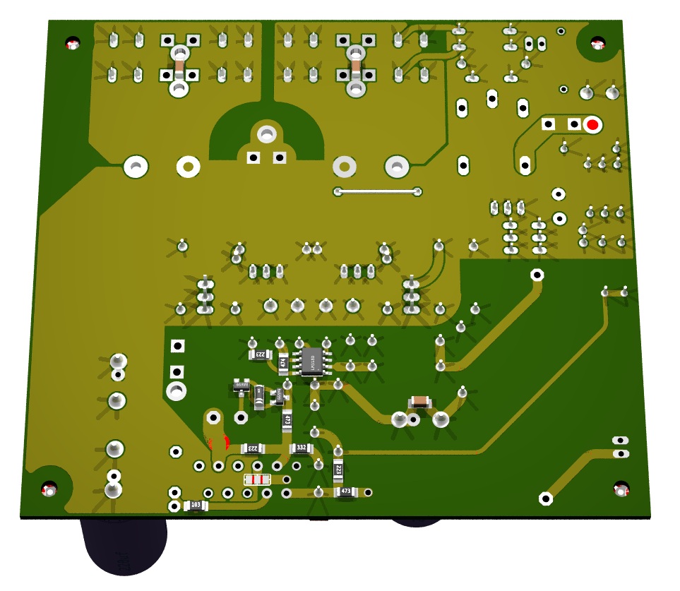

I would like to propose more room on the board for C4. Possible enough room to fit the 1uF cap provided by TP is enough. I tried changing C4 to the same type cap of 0.68uF, it seemed to work charms like I anticipated.
A 22mm cap? 😱
It's not possible, maybe I can squeeze in a 15mm LS cap (MKP4 0.68uF is available in 15mm) but decoupling effectiveness would probably be lower...
Soemething like the attached schematic but I've some doubts...
Every mm more between caps and LM3886 could be detrimental and/or reduce decoupling effectiveness...
15mm lead pitch is fine for C4 (with flexible lead-pitch options including 10, 7.5 and 5mm, all with one parts outline). In V1.4, I used 8x multifilar traces on both layers between C4 and the LM3886 power pins, but one thick stripline trace over a ground plane will also be fine.
Siva, the flexible lead pitch cap you're using is in a public library? If so how it's called?

Since I don't want the Fremen Edition to be an endless work I've finalyzed the beta layout (attached) for production.
I'm waiting payment confirmation from the fourth participant, BTW I'l cover the extra cost if he pulls back so the import will be 29€ + shipping.
