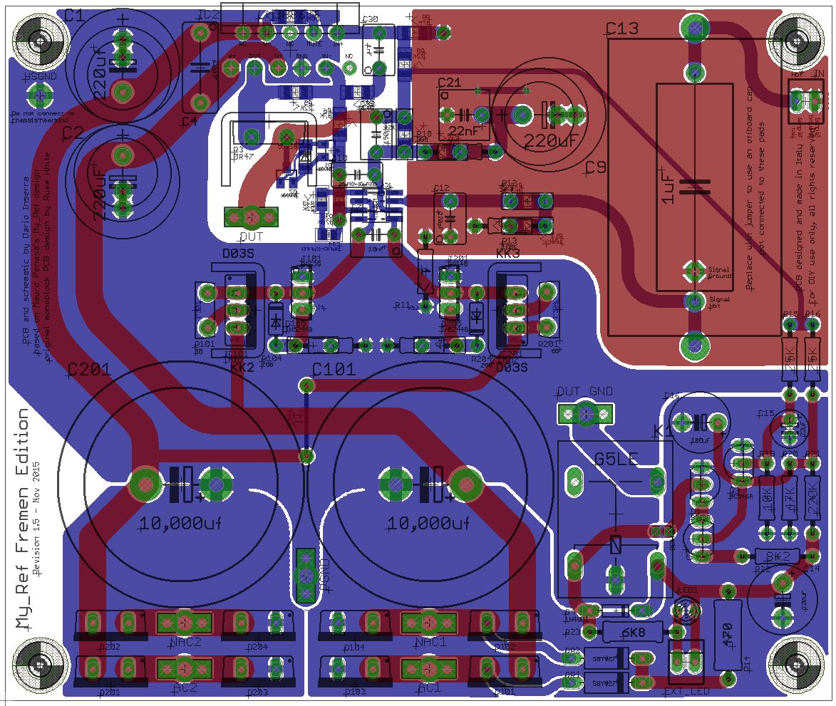

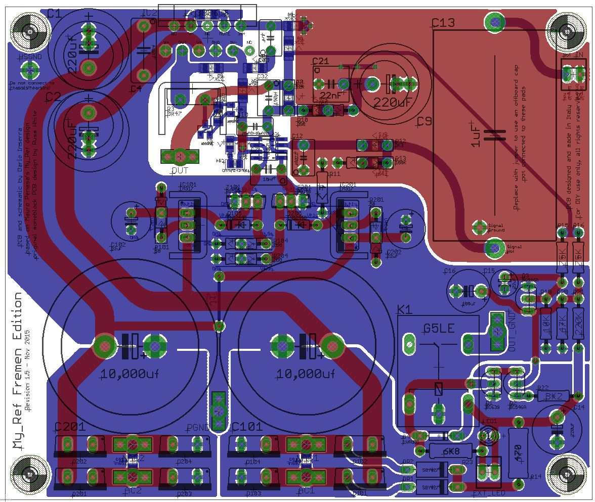

Layout 1.5
This is the (almost) final layout 1.5 that will be shipped:
attachment.php
I've managed to include several improvements from the previous eperimental version without redesigning the board so that changes in layout are minimal.
Now begins for me the final optimization phase and tomorrow I'll send Paypal invoices, price is fixed at 30€ for each kit of 2 PCBs.
GB is still open until final order is done.

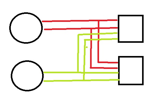

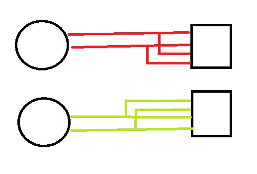

Hello, just a question: i already have a pair of 300VA 22V transformers and i would like to use them for my amp. But they have both a single 22V winding.
Could i feed + and - AC power inputs on a board using the same transformer winding or a separate winding for each AC power input onboard are strictly needed?
Sorry for my bad english: i wanted to say that both my transformers have a single 22V secundary. Can i use only one of them to feed a board's power inputs?
Hi Luca,
Sorry...no.
You will need two secondaries.
Maybe you could 'emulate' them using both transformers and then parallel boards...
Like that:
attachment.php
But I can't guarantee it will actuall work.
That's exactly what i was thinking about. It seems logical to me: what could go wrong?
In a dual secondaries transformer, aren't they connected to the same single primary as well, at a certain point inside the transformer? That way, i simply would move that point towards the output...
