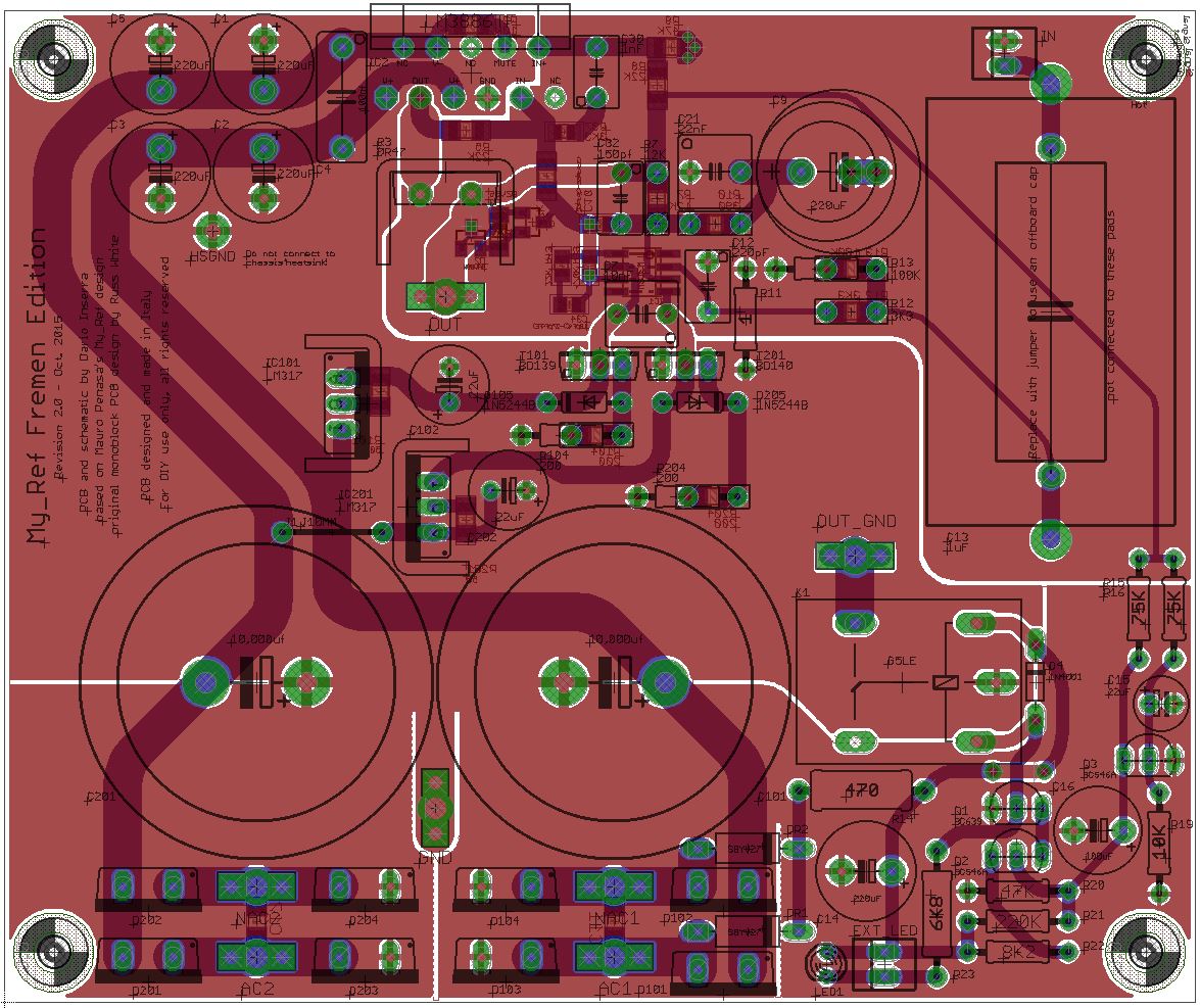

Hi Lawrence,
If you're really interested you're still in time for the 8th group buy:
http://www.diyaudio.com/forums/grou...ion-gb-eight-run-v1-6-boards.html#post4624023
The amp had a significant upgrade starting from 7th run, with distortion gone down 10 times.
Also the BOM has been updated with the goal of a more neutral and universal timbre.

The maximum voltage for secondaries for the My_Ref is +- 25VAC, you will need new transformers.
I've finally completed the updated Build Tutorial which covers all boards up to 1.6 and will be valid also for next revisions.
The link in the opening post is updated accordingly

BOM was safe to order from when I've released it, some minor changes (improvements) have been done, though.
- Vishay MBB0207 were not an improvement over KOA MF (but still good enough), so KOA went back in BOM
- Vishay BC 256 PMG-SI from the 'On a budget' BOM resulted so good they're now in the industrial BOM too.
- The NCC LXZ were a bit more neutral than the already very good Panasonic FR so they're now the standard cap for C1,C2.
Nothing that should bother who already ordered it, simply if you're going to order be sure to use latest one using links in the opening post.
Some further small refinement is possible (PTF56 from the On a budget BOM in place of Caddocks MP915 in the Industrial BOM too, for example) but rest assured that any version of the BOM is already safe to order and good sounding.
For partecipants that ordered boards with SMDs already soldered I've added a special BOM that omits the parts already supplied with PCBs:
http://www.mouser.com/ProjectManager/ProjectDetail.aspx?AccessID=fbff7e1d92
Just a note:
- Remember that BOMs are for 1 channel/PCB, order two of them per kit.
- No BOM includes screws and bolts for heatsinks.

I am afraid my pcbs did lay quite a long time in the corner and I did not buy the parts... 🙁
Is there a chance to get the list of the parts I need, which were in the quoted shopping cart, (which seems not to work any more)?
It is BOM 1.5 with the smd parts already soldered..
Thanks for your help guys,
Cheers!
Edit: If I could use the newer Bom with my older PCB, I would be happy to just use the newer BOM. Is that possible? Has the circuit been ubdated and do the parts from the new BOM fit with the already soldered SMD parts?
You can use this Mouser cart:
http://www.mouser.com/ProjectManager/ProjectDetail.aspx?AccessID=06575ccc32
Or this one if you want to use My_Evo compensation:
http://www.mouser.com/ProjectManager/ProjectDetail.aspx?AccessID=b981106ee4
Read the updated build guide, though (very important):
https://drive.google.com/file/d/0B-qKRBuaKtzYVHJyT1ZaR292MFk/view?usp=sharing
