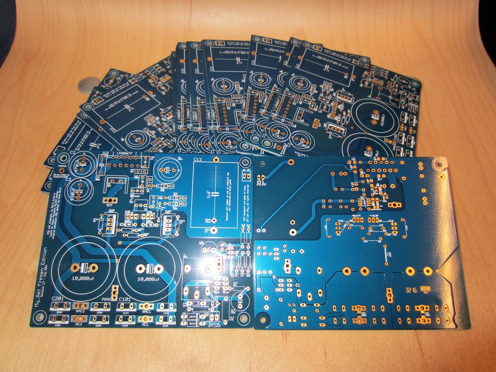

Boards have been ordered
Just ordered boards, including some extra kits.
2 partecipants still have to pay...
So if someone is interested PM me for extra boards.
The PCB manifacturer closes for vacation from August, 5 to August, 21.
They should be able to ship boards before closure but it's possible that boards arrive 2/3 days after re-opening.
