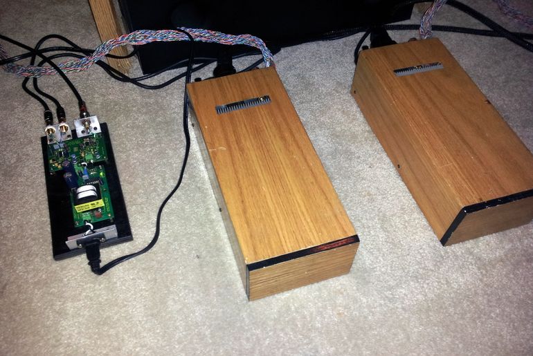

A few years ago I had an amplifier which was powered by 2 x 400 VA transformers and few 100.000 µF reservoir capacity. Every second or third power on activated the automatic circuit breaker.@1543---
I'm curious about the dual power inlets. Did you do 3 transformers per power inlet? Is this an effort to limit in-rush current without having to use a soft start?
Therefore I have used for this build two power inlets / switches to lower the in-rush current.
The potted transformers are 160 VA types from hifituning24.de (Schuro.de). They have a shop at ebay if you are intersted to buy some of them. diy-audio4you auf eBay1543, what a build, that looks stunning! if you don't mind me asking, where did you get the potted toroid's?
