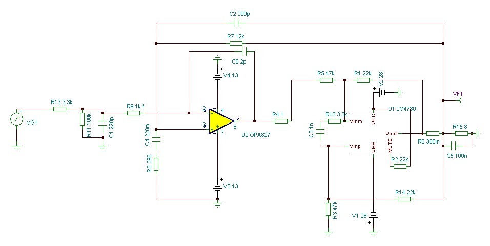

Ok, I sat back and tried to find a more directly perceivable demonstration of the mechanism , the effect of this resistor.
I can put here also the loop gain curves, but that (while showing the full story) might be more delusional, one has to dig into to "see" the behaviour.
But with slight tweaking of the circuit it is possible to 'drive' it into marginal instability, and in that circumstances the effect of this series resistor jumps out more evidently..
Again: in general the effect is that of shifting the system response to greater phase margin, and so better stability.
But in that particular, border line case when the original setup is in the state of marginal stability, the otherwise subtle effect of this resistor becomes more dramatic.
So let me put here the scheme - one can notice those slight tweaks for de-stabilizing de amp: feedback compensation cap shifted from 150pF to 200pF; local feedback for the OPA827 decreased to 2pF; the Output loaded with 100nF. (note that only small changes are enough..)
So, in the following test sequence only the input series resistor, R9 value will be swept from 1,2kohm down to 0,1ohm, the rest is left invariate.
The input signal is a 10kHz square wave, 50nsec rise time.

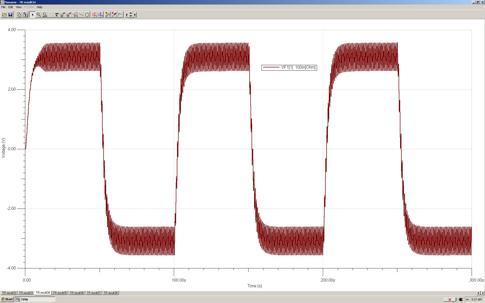

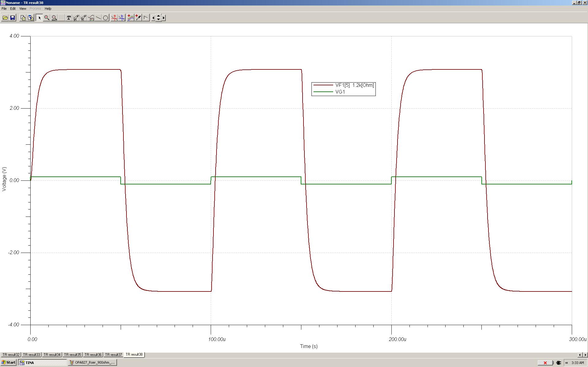

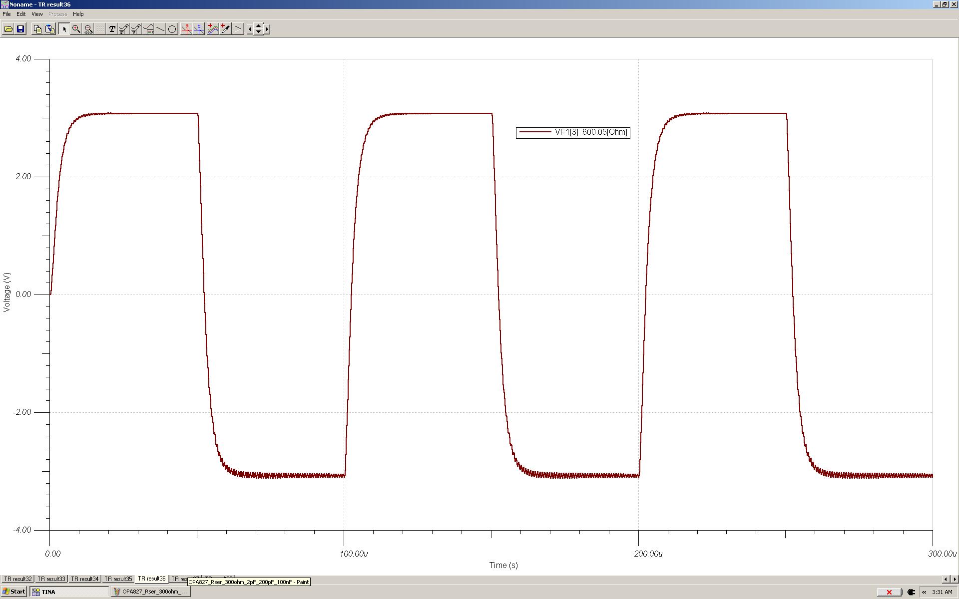

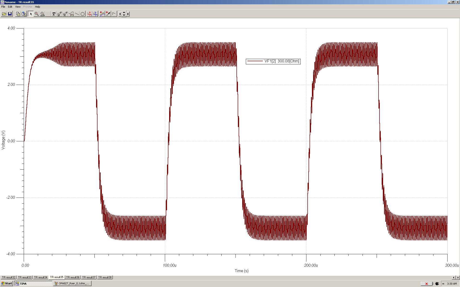

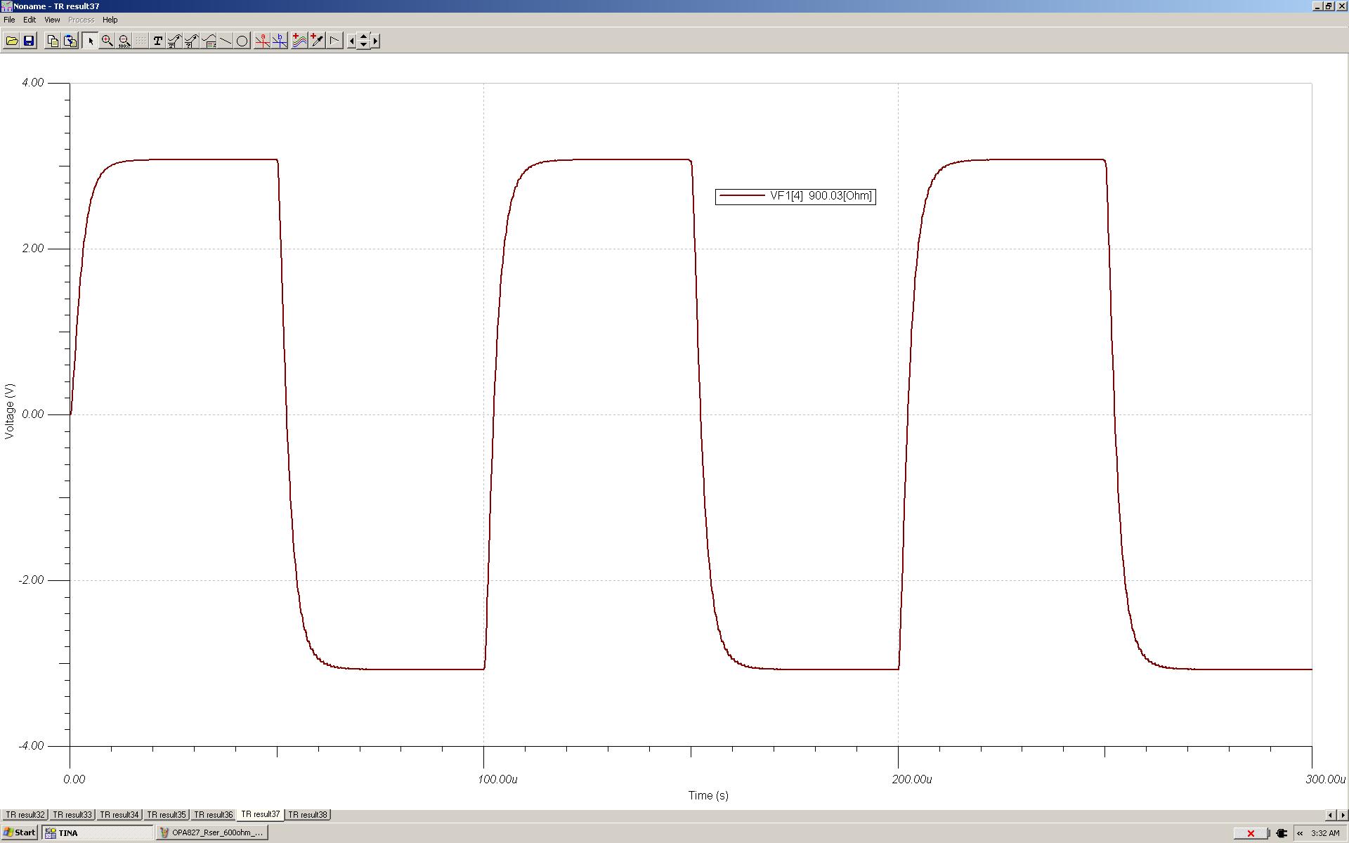

So here it is, the output response to the input square signal while sweeping the value of R9 from 1,2kohm to zero ohm (0,1ohm)
Thank you for this George. I understand you were trying to demonstrate the stabilizing effect of R9 and I appreciate this exercise and your efforts. But, to artificially create an unstable situation to show the effects of the addition of another component is, in my mind, a bit misleading with reference to viewing the "already stabilized" build as would be done normally. One graph is needed for proper comparison...feedback compensation cap back to 150pF?, local feedback for the OPA827 back to 5pF?, the output loaded with whatever is normal and R9 set to 0 -0.1R. In this "normal stabilized stock" build are we viewing a graph that resembles your 600ohm graph or your 900ohm graph?
With appreciation,
Pete
With appreciation,
Pete
okkey.. now just don't forget that, for example for the OPA827 'normal condition' (original suggested value) was not 150pF but 100pF. Not by accident.
The same for OPA828. ~70pF suggested.
So these conditions can then be relaxed to 150pF 'standard' value for compensation, with "R9" added.
Just so as to be very clear: in 'normal conditions', for each particular opamp, configuration, (always slightly different) the square wave test above !Obviously looks like the best one of the series, R9=1,2kohm.. That was the target function of the whole operation, to obtain a stable non resonant response..
